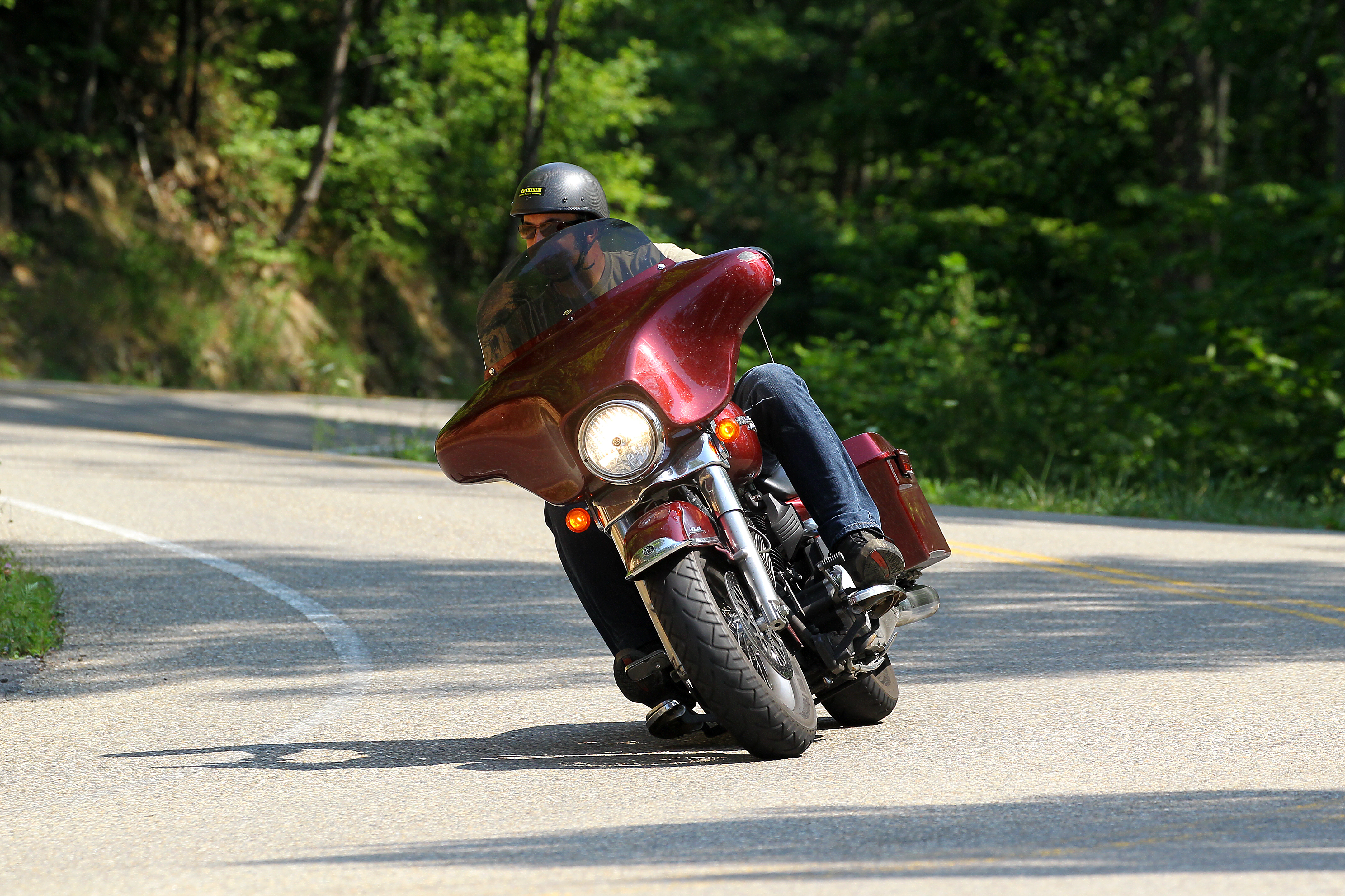

Looking through some pictures I noticed my foot hovering over the brake pedal while riding the Tail of the Dragon in North Carolina, trail braking, using front or rear brakes or both going into a corner is a great way to stabilise the bike and increase turn in, on heavy cruisers like mine rear brake alone is best, sports bikes work best with both or front only and trail bikes definitely front only on tarmac. With longer bikes you gain some pivotal force as well as extra loading on the front, with other bikes it is more about loading the front tyre and stopping any head shake from developing. You can use it right up to the apex of the turn but you need to have fully released the brake by then. It is a technique well worth learning. Here endeth the lesson.

I always trail brake on my bikes, best way to get through a corner (as well as weighting the pegs) , works ace on gravel .  I've never ridden anything as heavy as your bike Buck, it must take some balls to get a big unit like that hauled over in a bend.

Looks good though and there are few things better than harassing power rangers through the bends.

I posted a photo of me doing this old school riding shit.
And it is pretty awesome.
 I do have an honest question about the Harley, does it not scare you it has such little leaning clearance?
So how do I see you doing this trail braking shit from a photo?
You just have to exaggerate the body english at time by moving off the saddle from time to time, you can scrape the floor boards fut then you have to be very careful as the floor board mounts are frame mounted and if the hit they can unload the rear wheel.
You can see where my right foot is.
Yes.....but how can I tell the pressure you're applying and at what point in the turn?
And is the front brake being used as well?
You wouldn’t be able to tell in a video either, no front brake.
