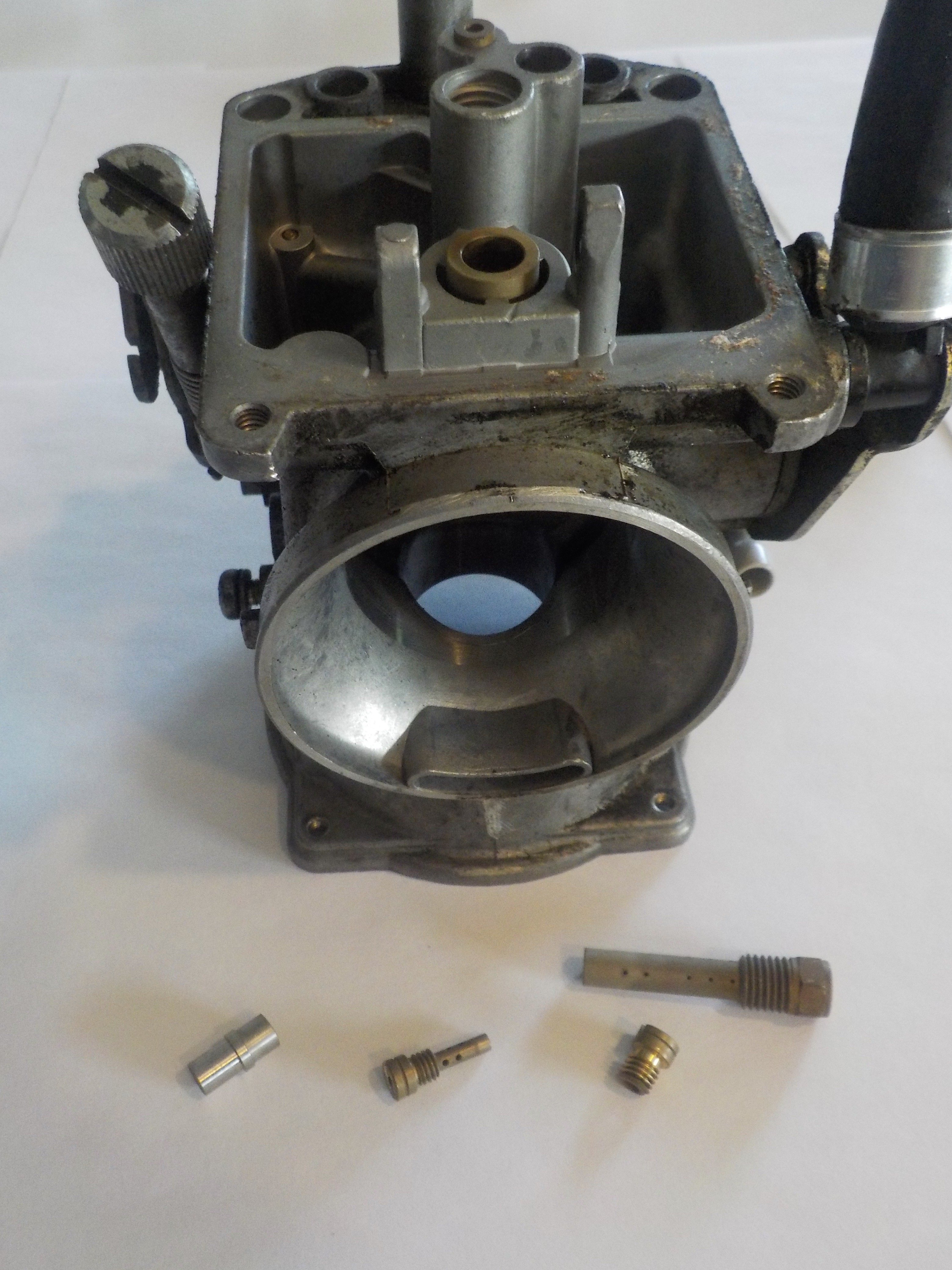

What's wrong with it Tym, is it worn or just gummed up with all the shit they put in the fuel now.  If it just needs a refurb then see if you can find someone who's got an Ultrasonic cleaner.  We have one in work and they're ace, strip the carb, bung it in the cleaner overnight. Flush it clean in the morning and then reassemble with new jets and you won't believe the difference ?
I think its both! Slowly getting the carb off, had to plant me onions first!
Think you said it started and stopped? Still think its worth draining the float bowl as the water content in ethanol fuels always ends up and the bottom of the tank and bowl.
Having said that if that carb hasn't had a service in a long while best have it off and a good muck out.

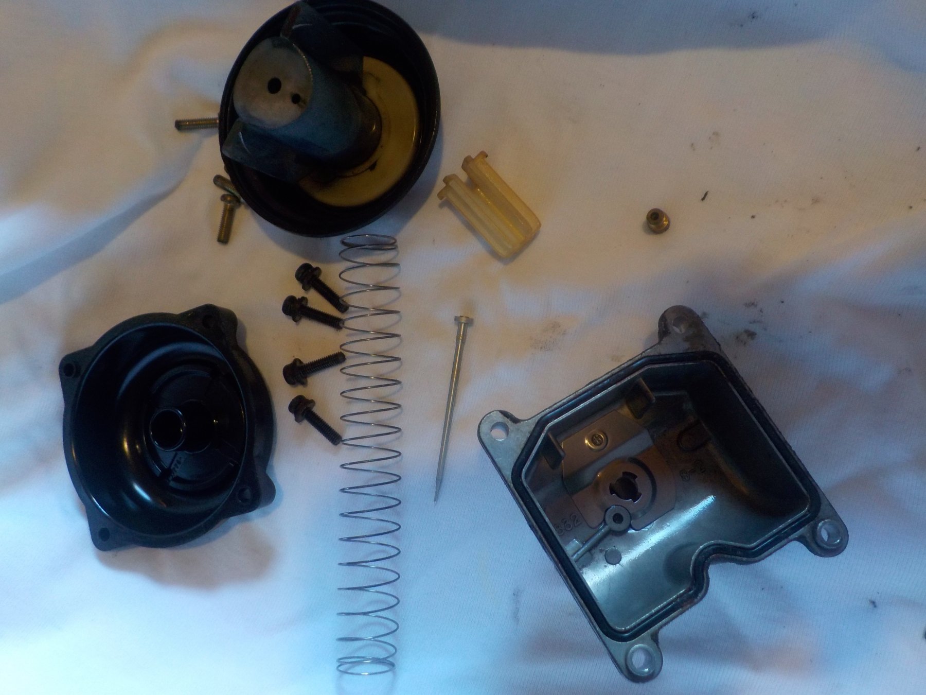

Found the first problem the main jet is almost all clogged up, the inside looks brilliant however....not a spec in the float bowl, no signs of varnish, just waiting on parts and i need cleaner...nice seeing an obvious problem however!
You need to put a inline fuel filter  on the fuel line just before the carb. Also take off the tank and dump it out into a clean bucket. You need to look inside to see if your tank is full of crap or if it is starting to rust.
Yup, already run an inline aftermarket Rose auto filter, put in a new one, drained the gas tank, considering, i m not strong enough to take it off the bike if its full anyways...lol
