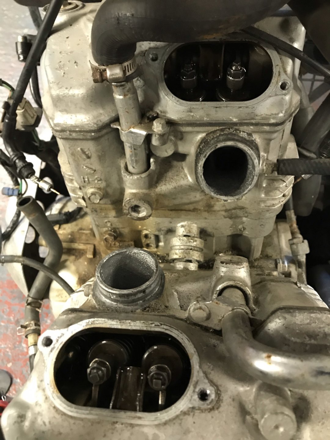

Once we got it back to the workshop we started to try and find out what the problem was .  It wouldn't turn over so we put it into top gear and rocked it see if there was any resistance, then we tried to start it on the button but just got a loud clunk.  We wheeled it inside and I started to strip off the fairing panels, seat and then the tank . For a 30 year old bike it didn't put up too much of a fight, so then I took off the rocker covers on the rear cylinder.
From that we found that the valves were moving freely so no problem there.   My boss also put a scope with a camera to see if there was anything untoward....
Next I removed the carbs to give me access to the front cylinder and then removed the rocker covers on that cylinder as well.  There was no movement on the valves when we rocked it in gear.  Next I drained the coolant out and removed the two rads and the front coils to get the valve cover off to see if the cam chain was ok........
The cam chain was fine so we're now suspecting something a bit more terminal.  That's as far as I got today, next it will be engine out and see what else we can find.

Looking forward to this Bob keep us updated ?
The pictures helped a lot Bob.....otherwise I wouldn't have understood a word you said.
Having said that, I'm not entirely surely what I was looking at in the pics!

I hope to get it running again Pedro but it will definitely depend on what's gone wrong in the engine.  It's already covered 104,000 miles so I'm not prepared to just chuck money at it willy nilly.
