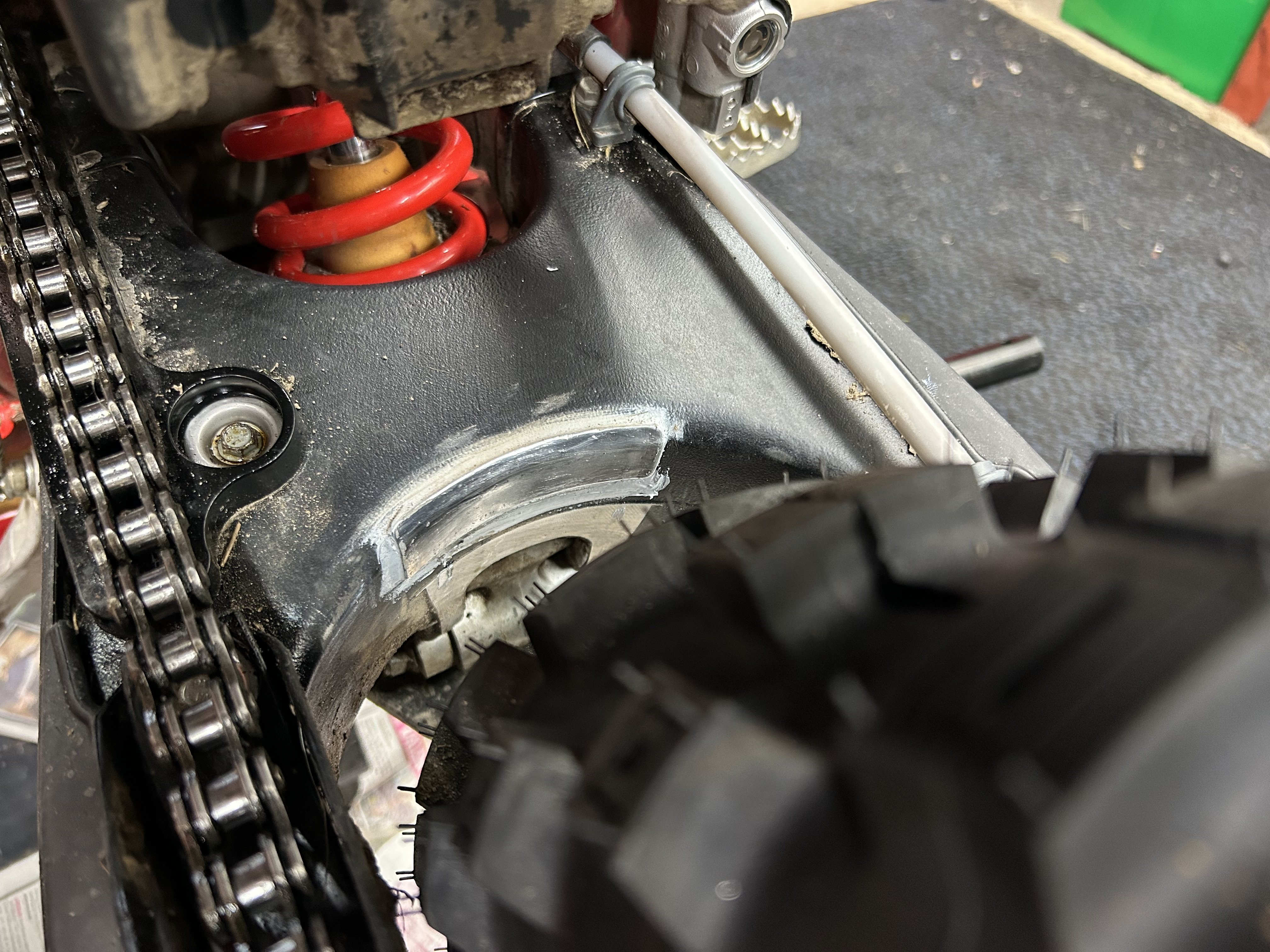

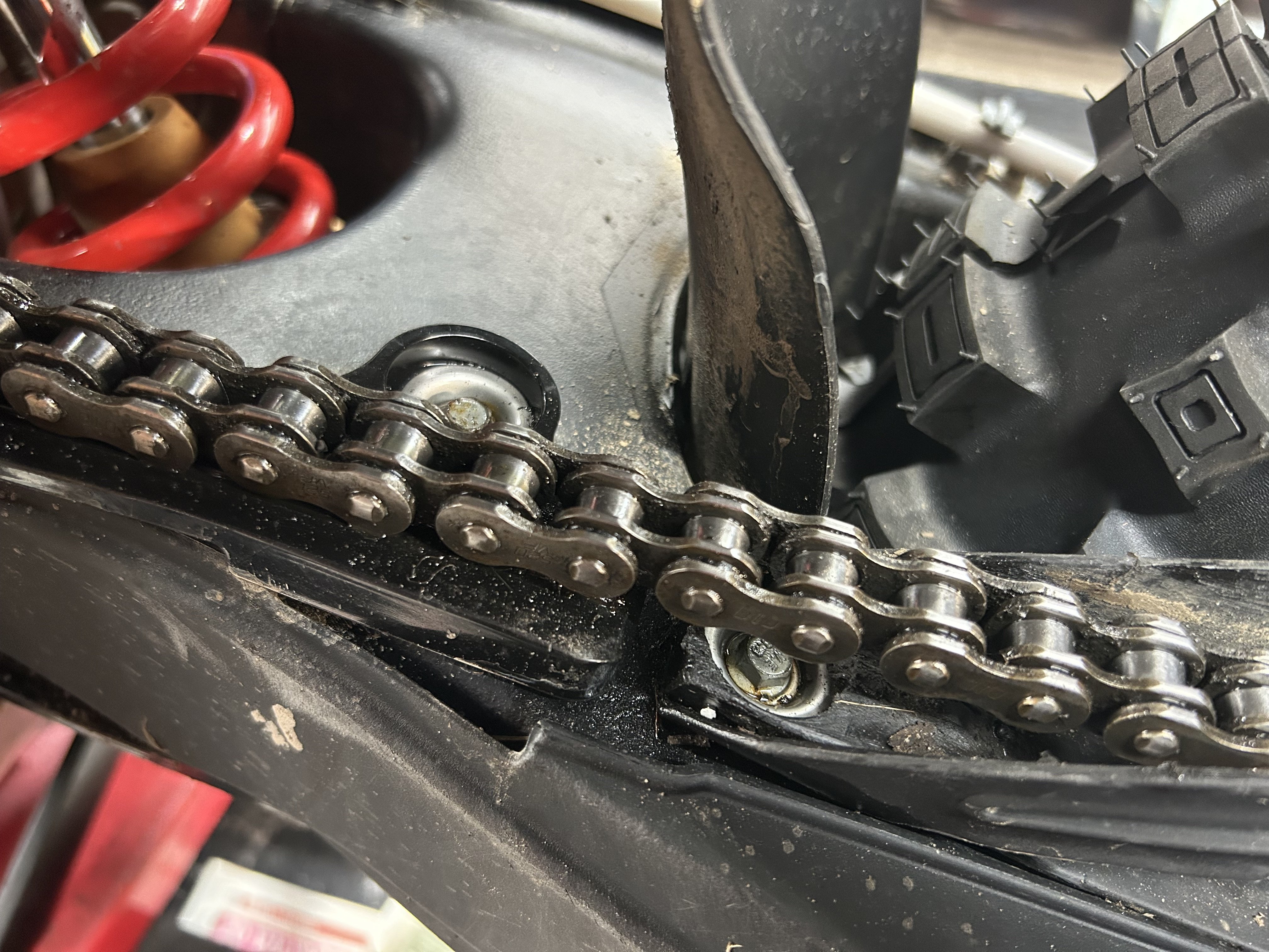

First entry was from some work last night when doing some maintenance i noticed the rear shock  mud plate has been rubbing against the swingarm I've heard this is common on the KTM's but not read any reports on it for the Beta's
The two scuff marks above the wear mark are where the air box is hitting the swing arm when my fat arse is bottoming the suspension out

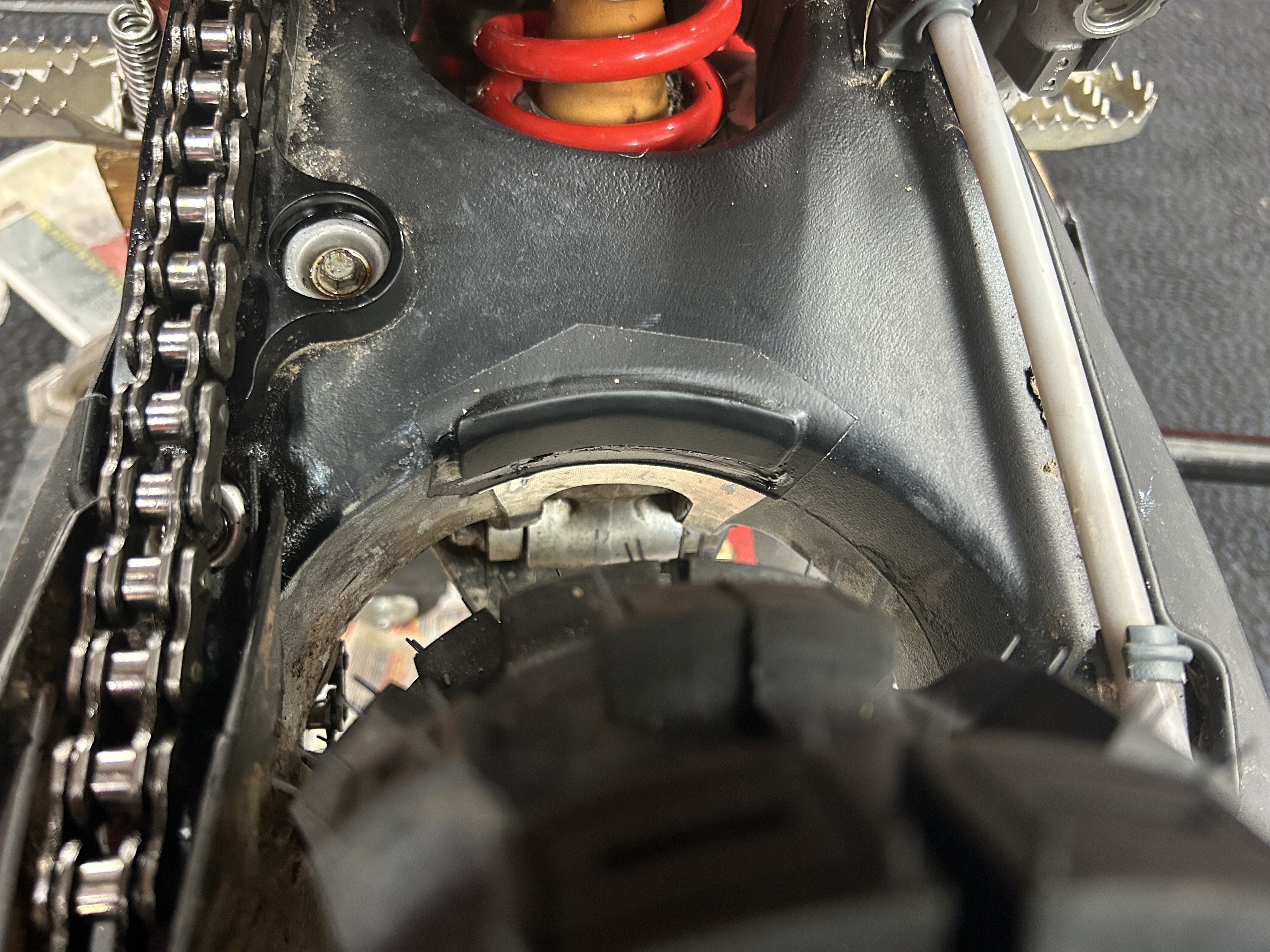

I cut and shaped a bit of Ali to fit where the flap touches so that will wear out instead of the swing arm
I bonded it on with Tiger Seal the stuff used to stick car trim on good stuff

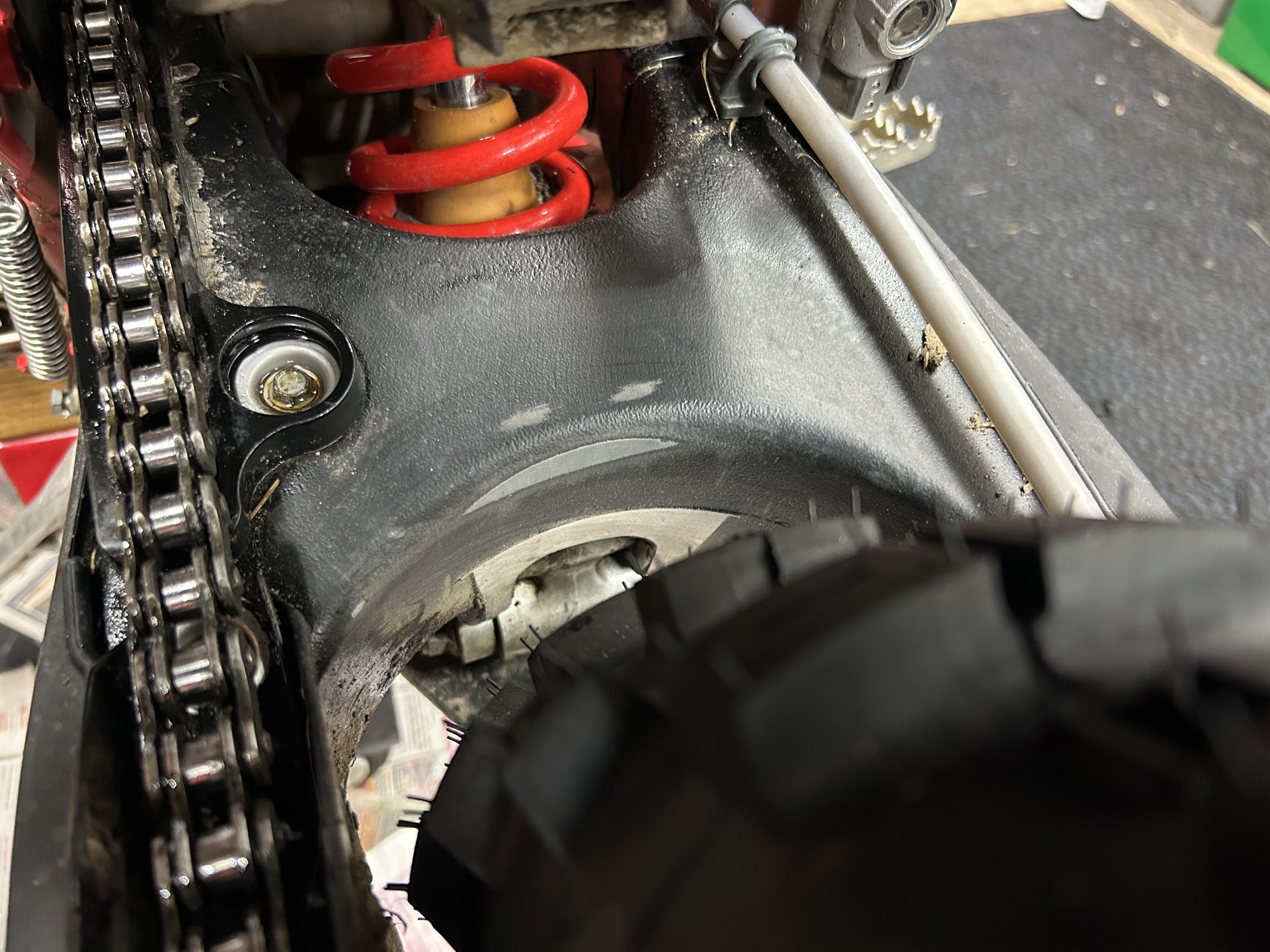

I sprayed it this morning with some stone chip for colour mainly because it's what i had kicking around not too worried about the finish it will be covered in crap next time i'm out
with the mud flap fitted and look at my shiny new non gay tyre

poor original design  ?
Probably, but i have found since looking at this that almost all bikes with the mud flap set up like this suffer from it. If you take it off then the rear shock gets destroyed with all the crap hitting it so its the lesser of the two evils i expect.

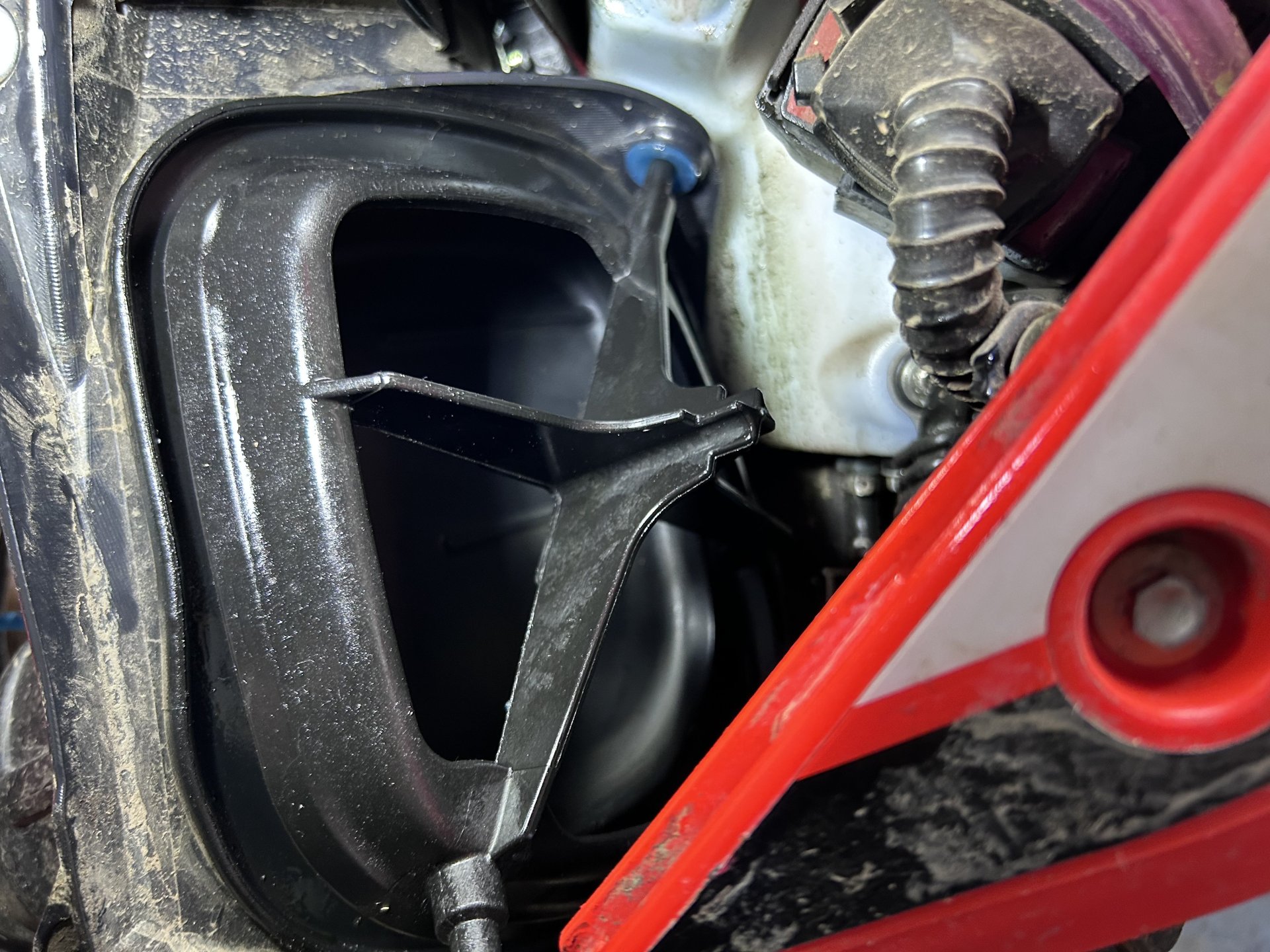

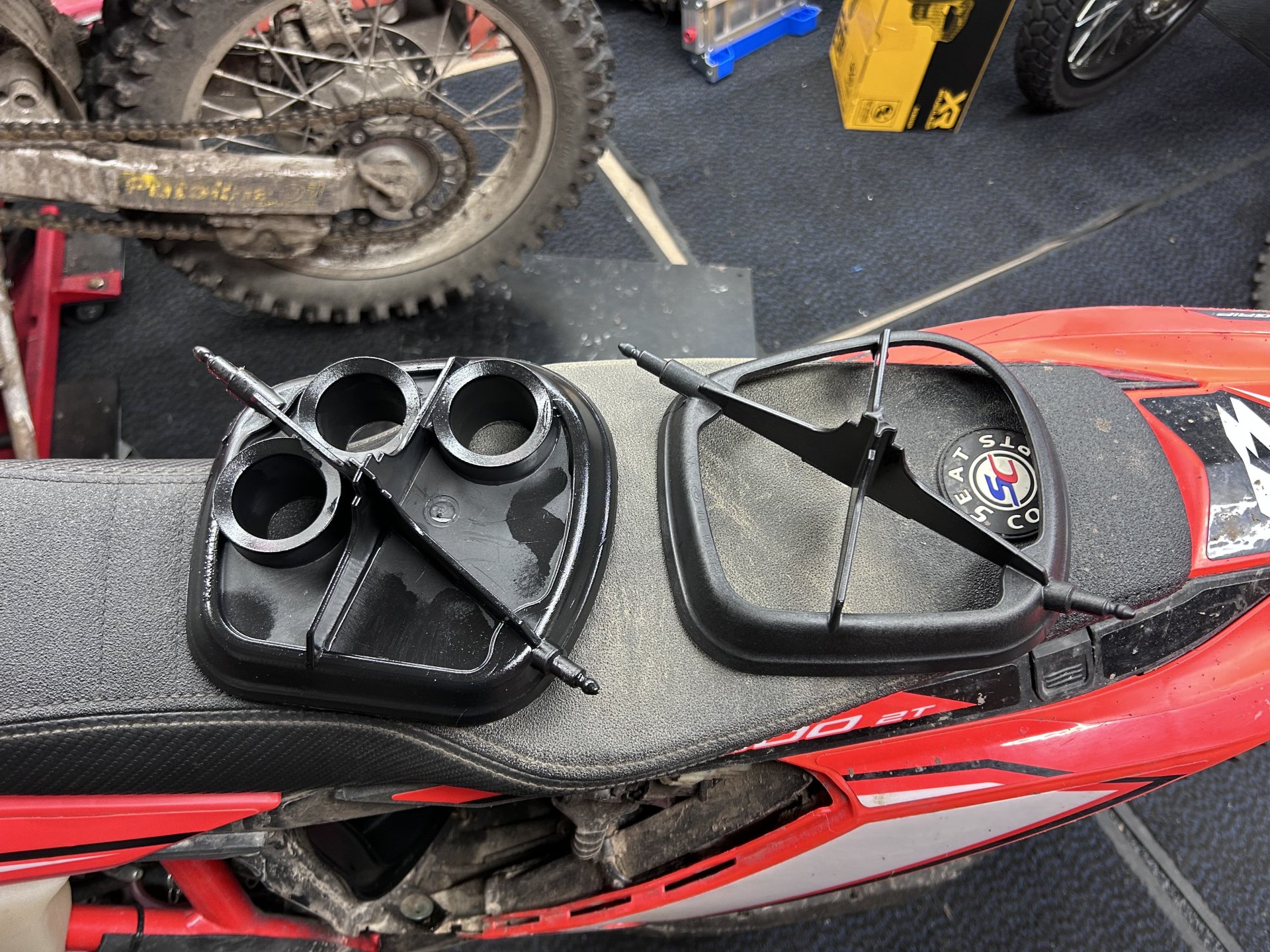

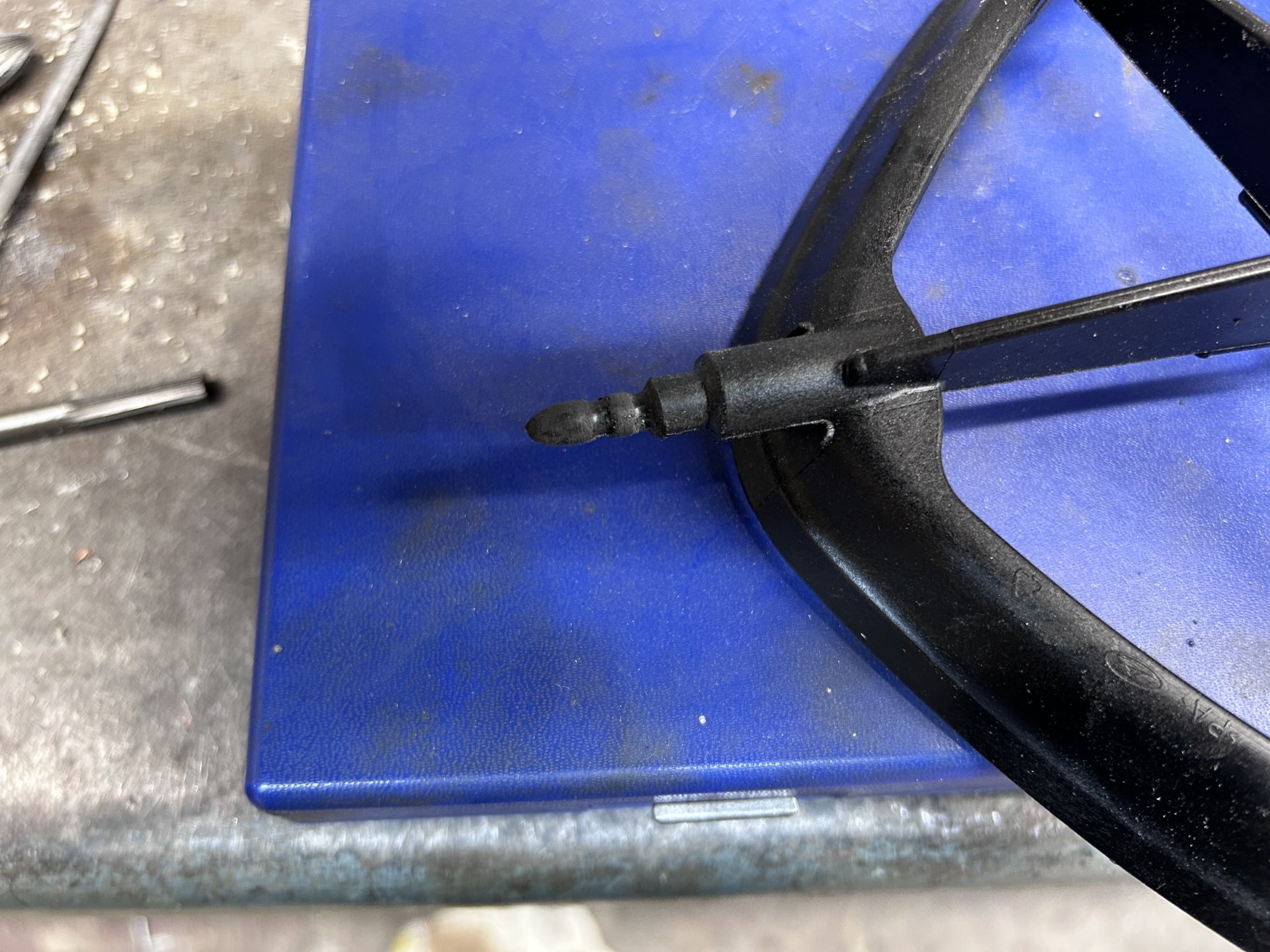

On the Beta group page someone pointed out the difference between the X Trainer and RR air filter cage and said on my bike their interchangeable which sounded correct as they use the same air filter. So i ordered one and it arrived tonight
The one on the left is for the X trainer looks a bit more restricting than the RR one. The bike is running a little rich from new and is definitely thirstier than the 2022 bike so hoping this will help lean it out a bit without messing with the jetting.
So put a clean filter on and fuck it don't fit. I placed the cage on a piece of paper and drew around it and the footprint of both cages are identical it's that locating spigot thingy is about 6mm longer than the X Trainer one
I got my needle files out and started filing a new locating bump, after about 30 minutes it was done and it fits just need some time to test ride it now
