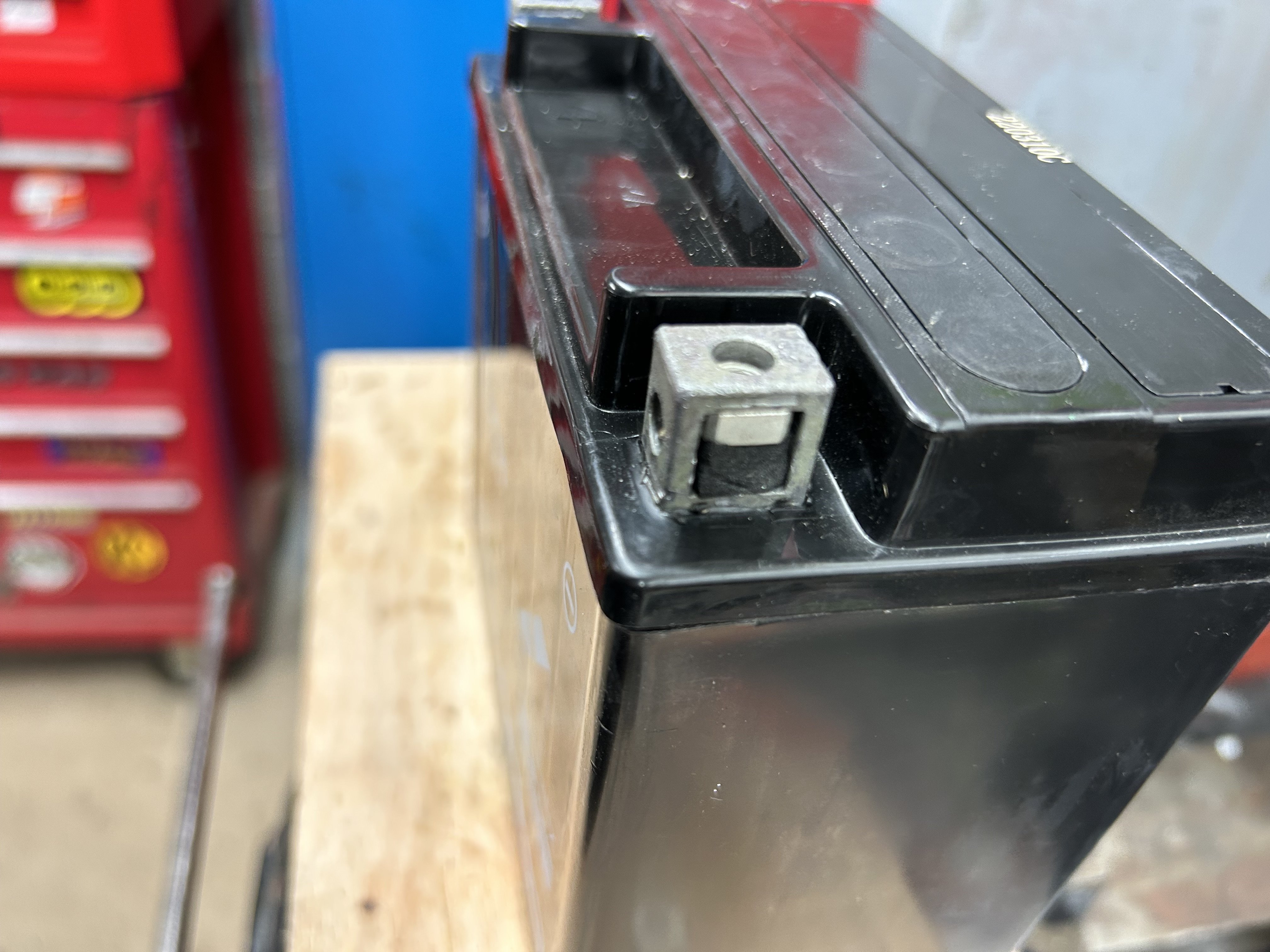

Got a new battery for the bike today, a little trick i do is to put a piece of foam rubber under the battery terminal nuts to hold them in place it also helps start the screw when you have a few extra accessories added to the battery terminals making the screw too short to reach the nut

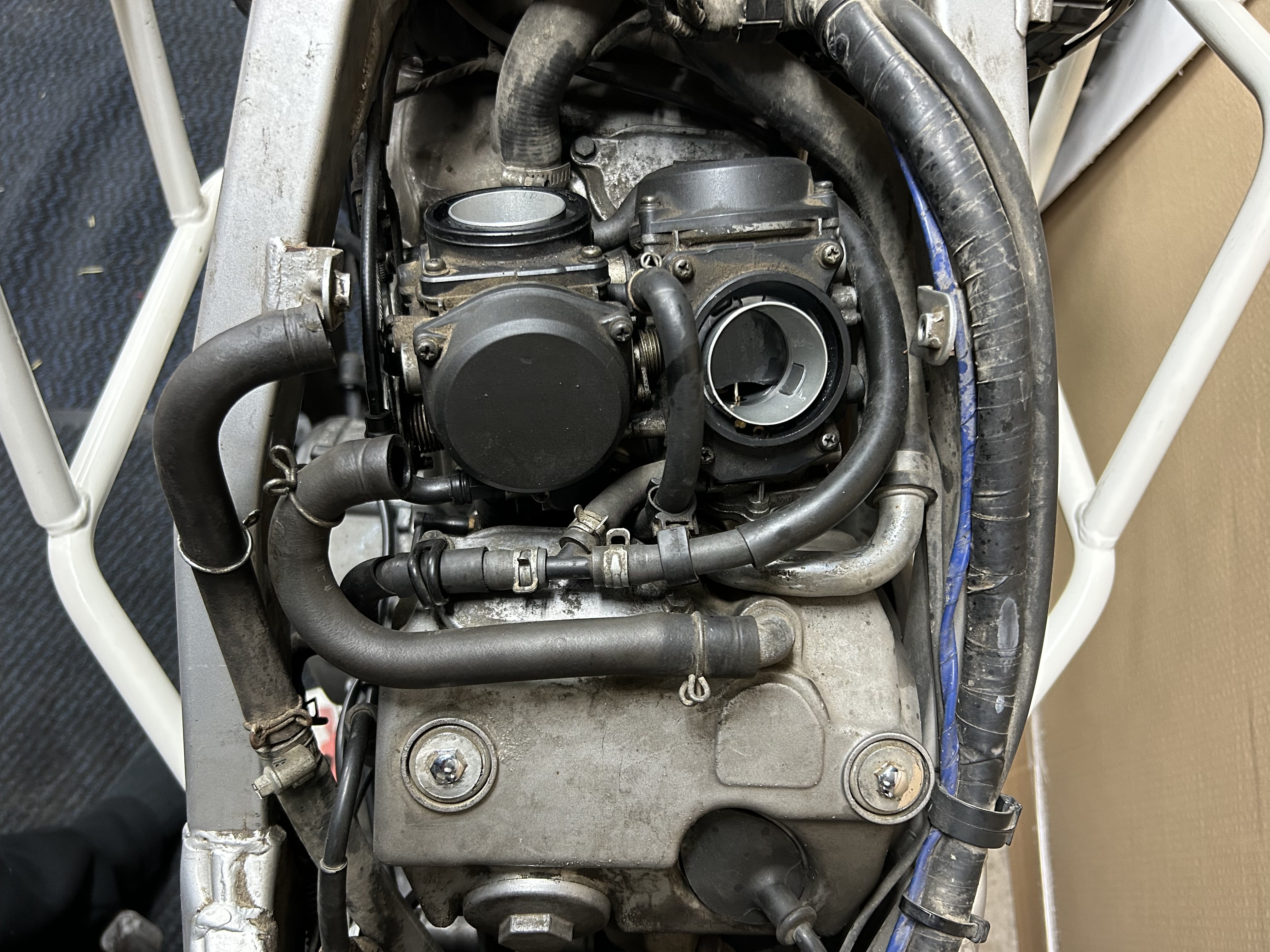

I also bit the bullet and stripped the carbs off the bike to clean them out, couldn't see anything wrong with the main jets but both pilot jets looked blocked so cleaned them out and blew all the fuel lines out. It's now its running on both cylinders again going to have run it at least once a month from now on just to keep it going and maybe one day i'll clean the outside of the carbs LOL
