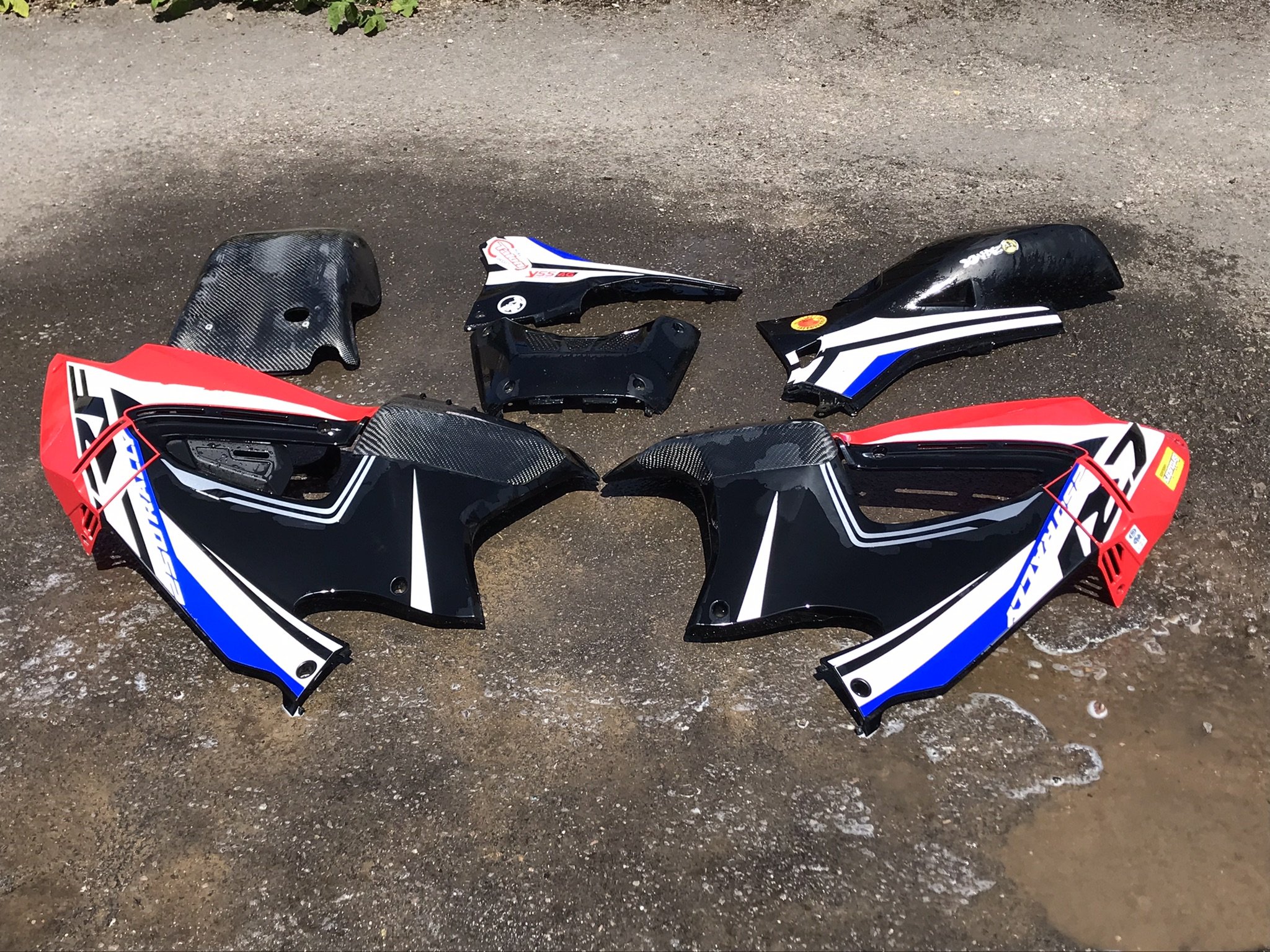

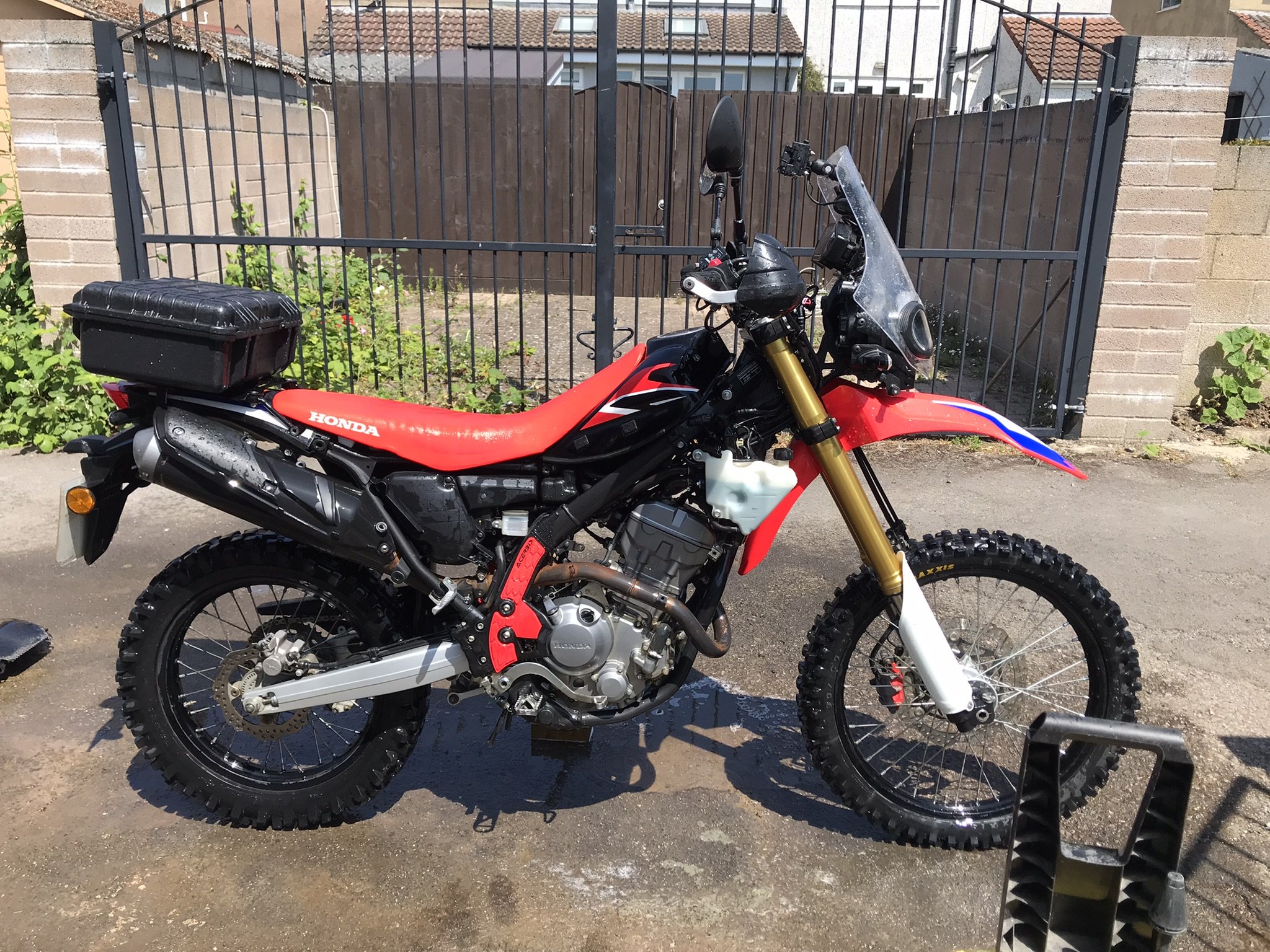

So after my two day trail ride I confirmed to myself that the Rally (CRF250 RLA) needs some attention to the rear shock.  First of all it needed a good clean so off with the bodywork and get on with it...........
Bodywork drying in the sun.........

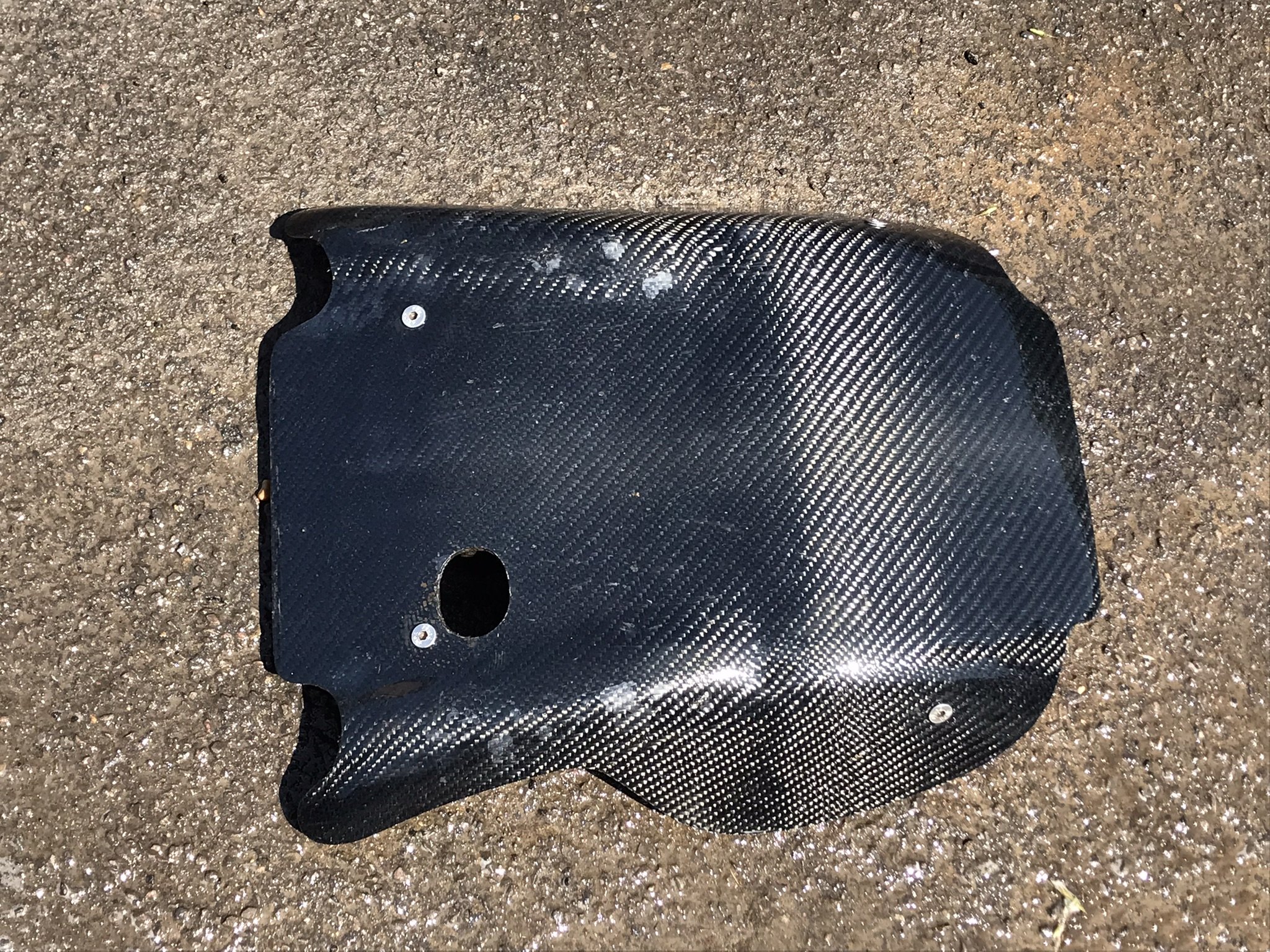

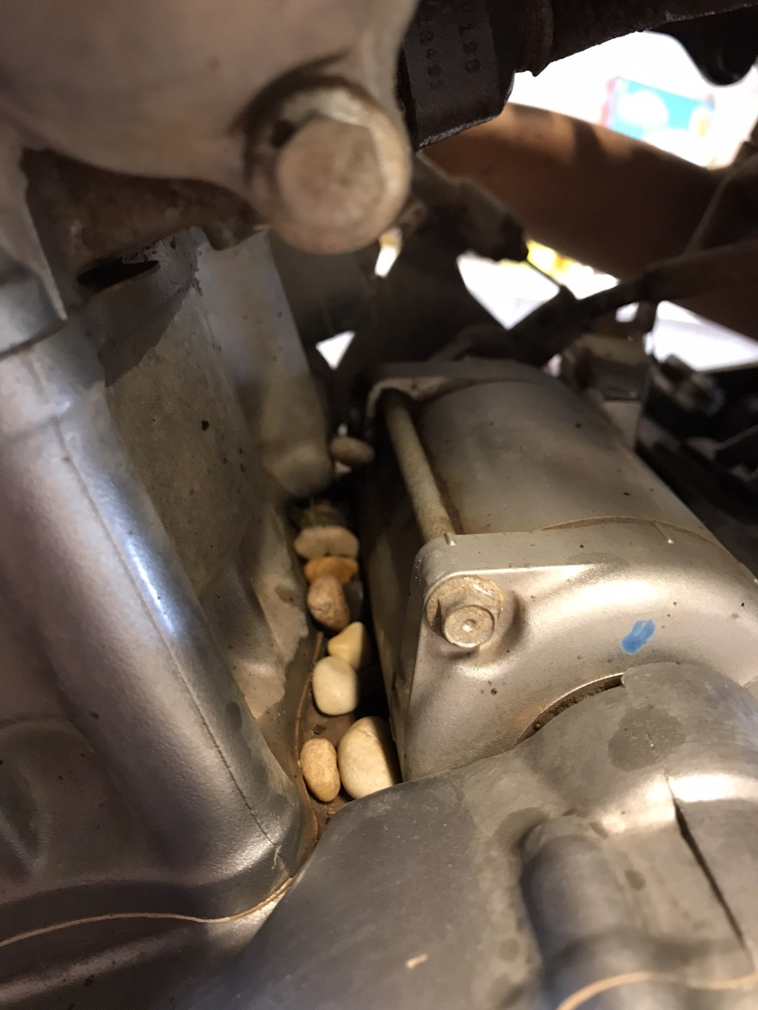

Found some more pebbles :classic_rolleyes:

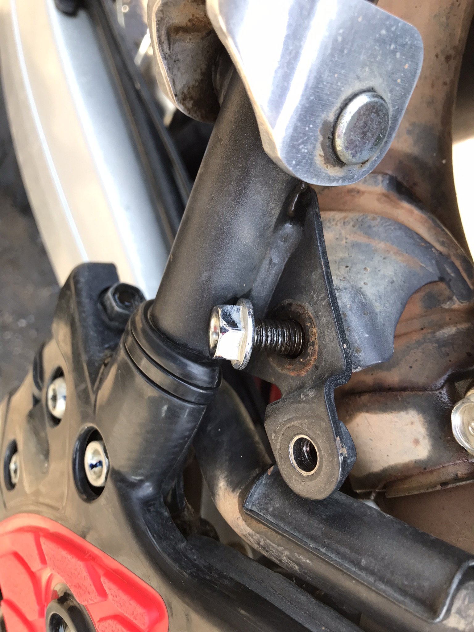

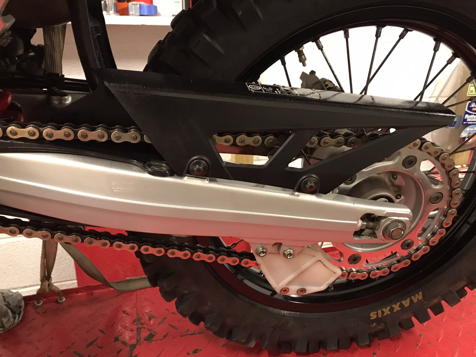

I also found this, a good illustration why you need to keep fettling a trail bike.  Luckily I didn't lost the bolt and it's been loctited back in now ..........

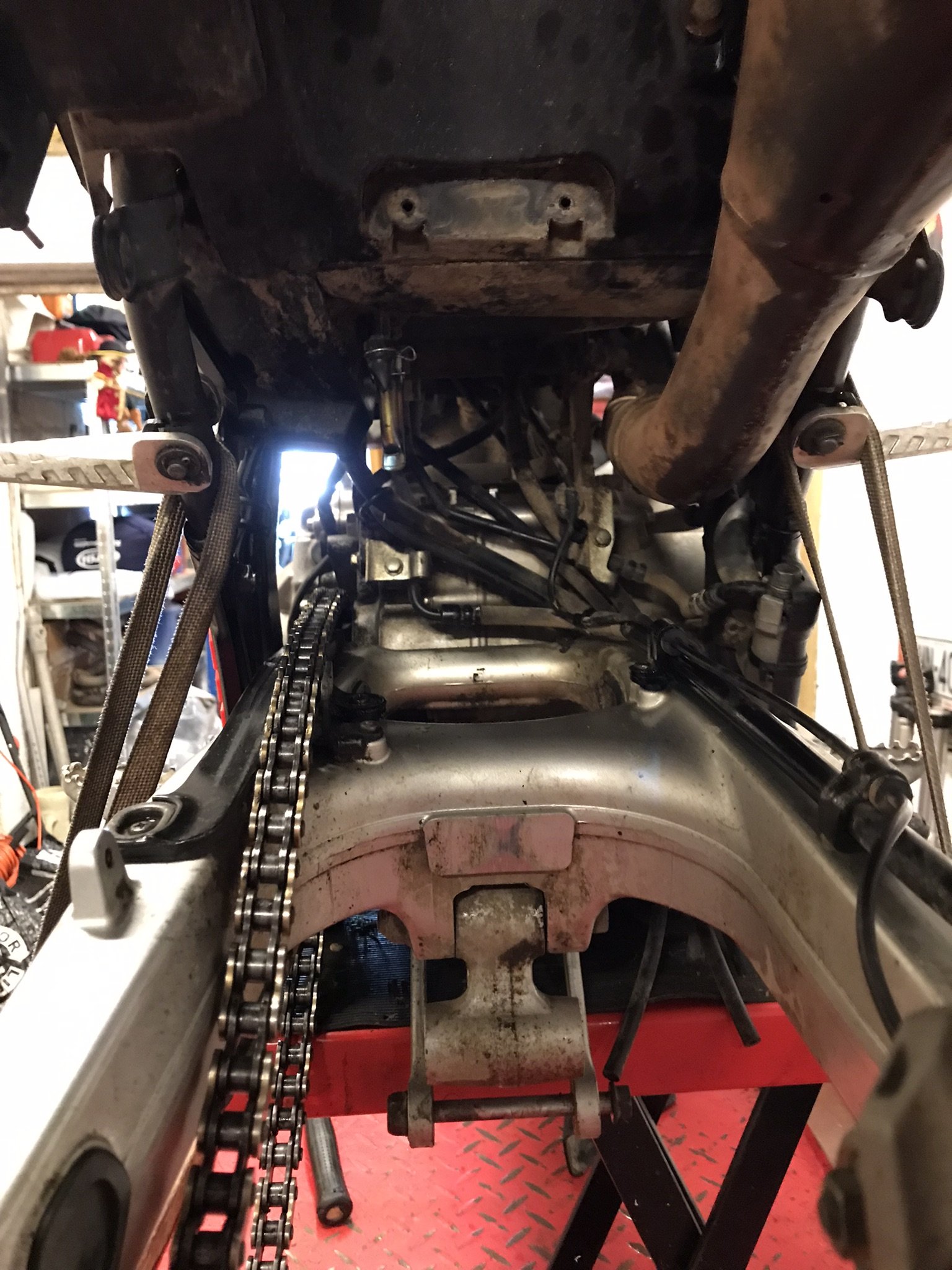

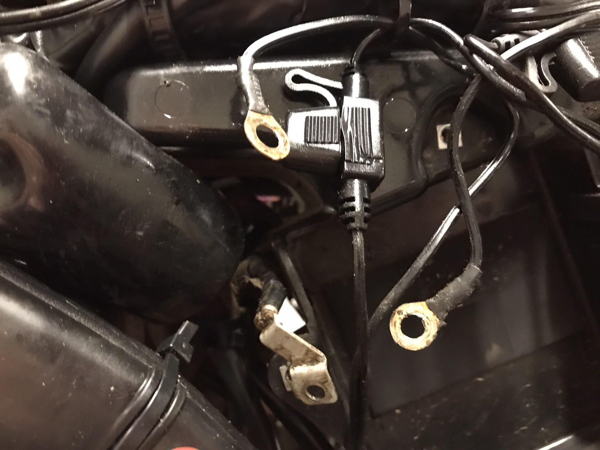

So onto the main job, getting the rear shock out.  Rear wheel out , remove shock guard , remove battery to give room to get at the top mount bolt on the shock ..........

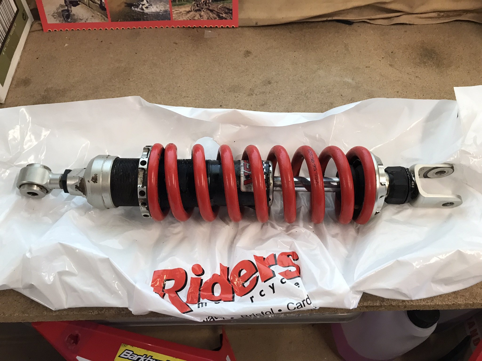

and the shock is out.  I'll take it into work tomorrow and give it a clean in the parts cleaner to see what need to be done.  It's five years old now and the rebound adjuster is seized so I'll have to see if it's worth rebuilding or get a new shock............

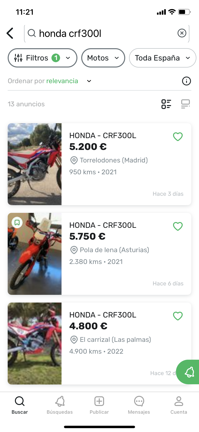

Here you Pete, a quick scan on Millanucios brought up these three second hand ones. Must be available new as well?
They're asking nearly new price!

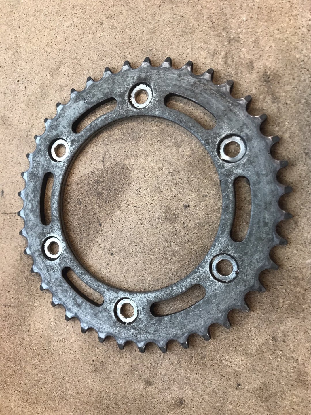

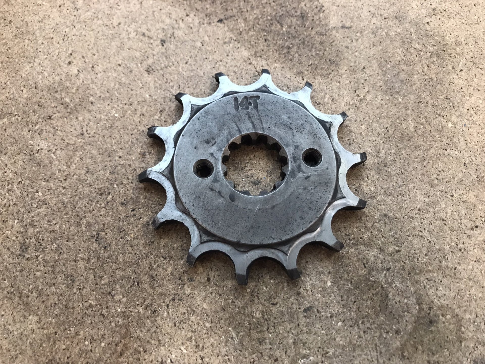

The shock was taken to James Packwwod racing to sort out the non-working rebound adjuster.  I then fitted new sprockets front and rear as the bike still had the originals on there, the front was well hooked ..........
But the rear wasn't too bad so I'll keep that one as a spare ................

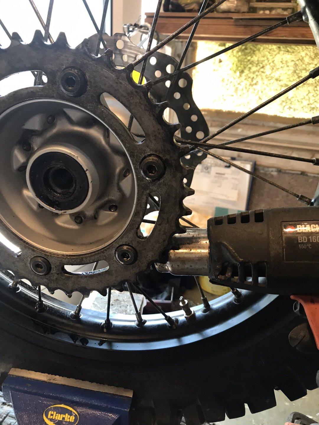

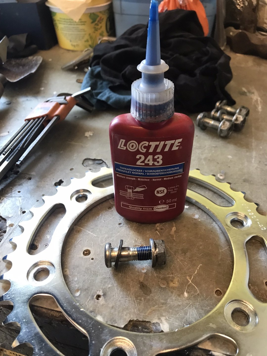

Heat up the rear sprocket bolts BEFORE trying to undo them ..........
and then fit them using blue loctite ............
and it's done..................
