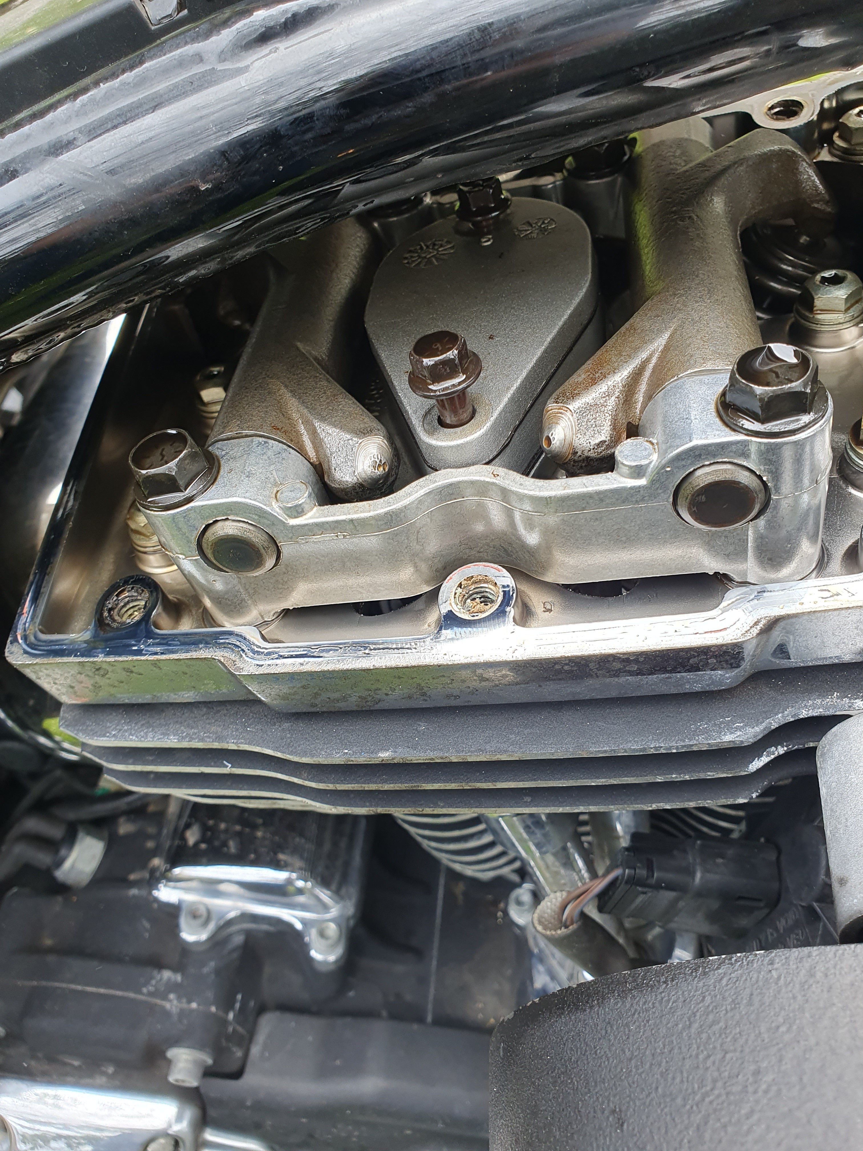

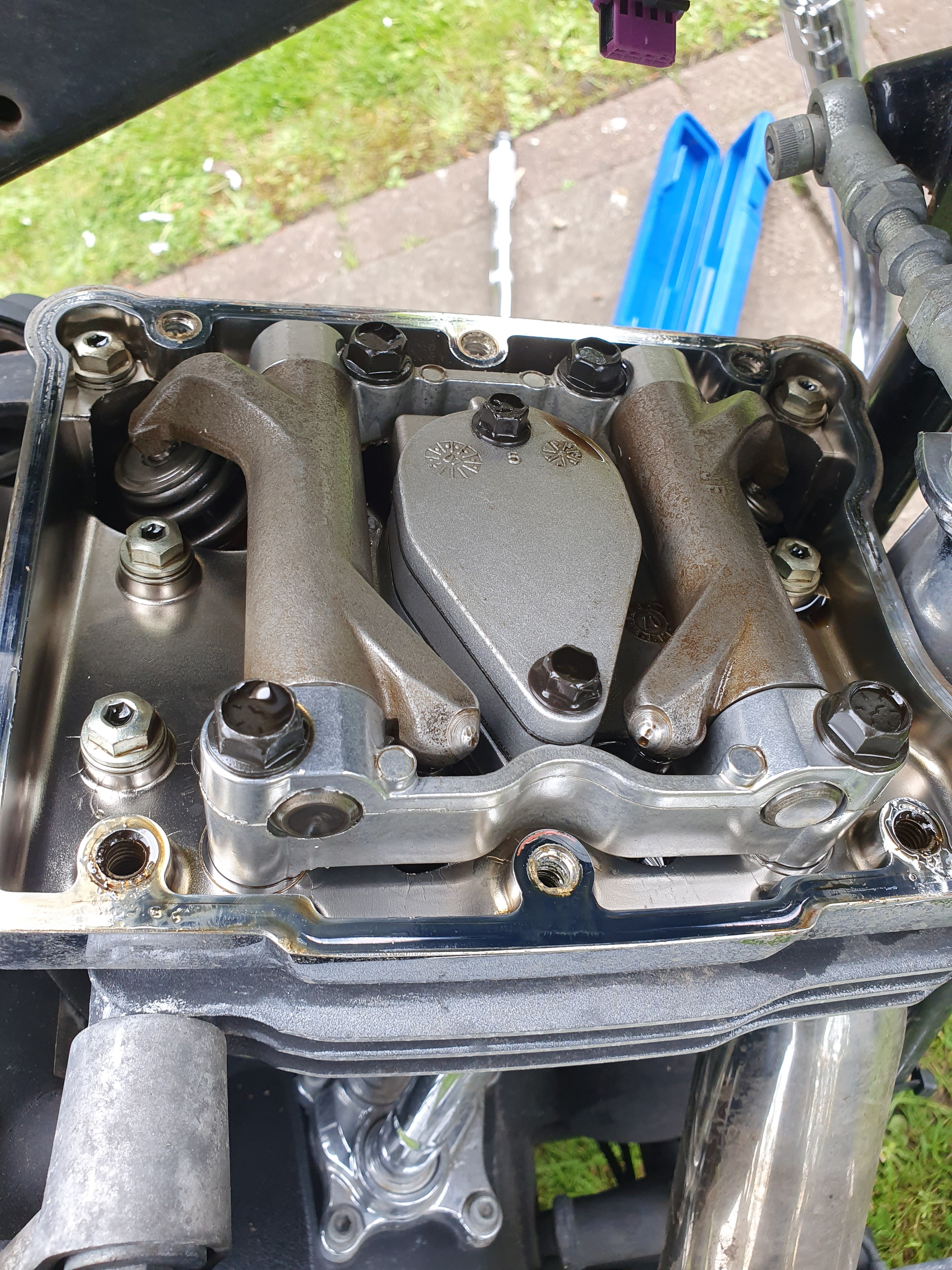

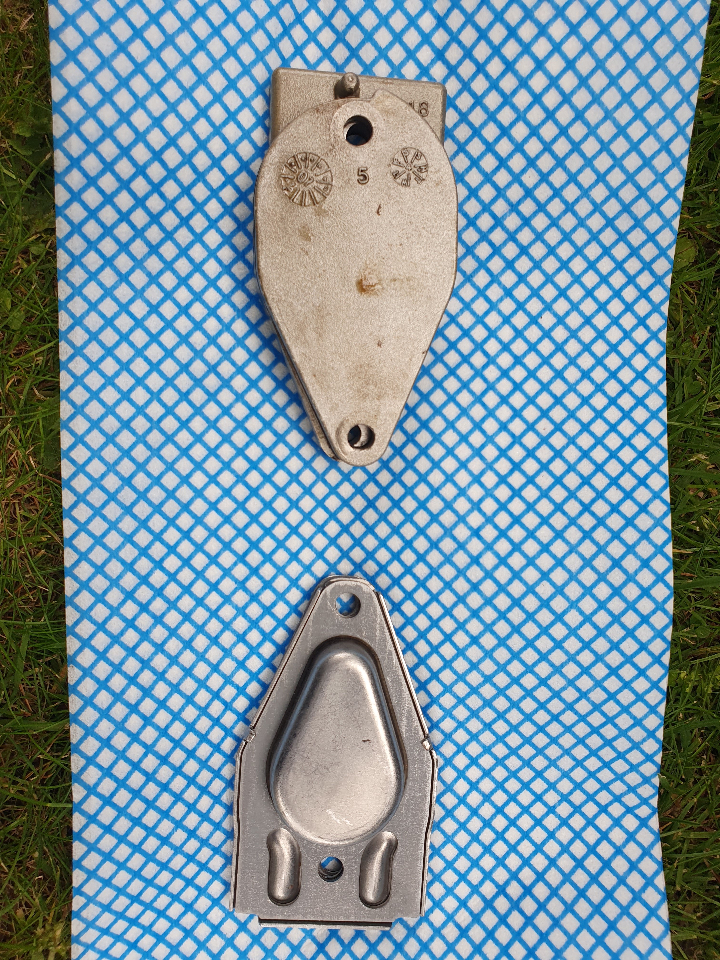

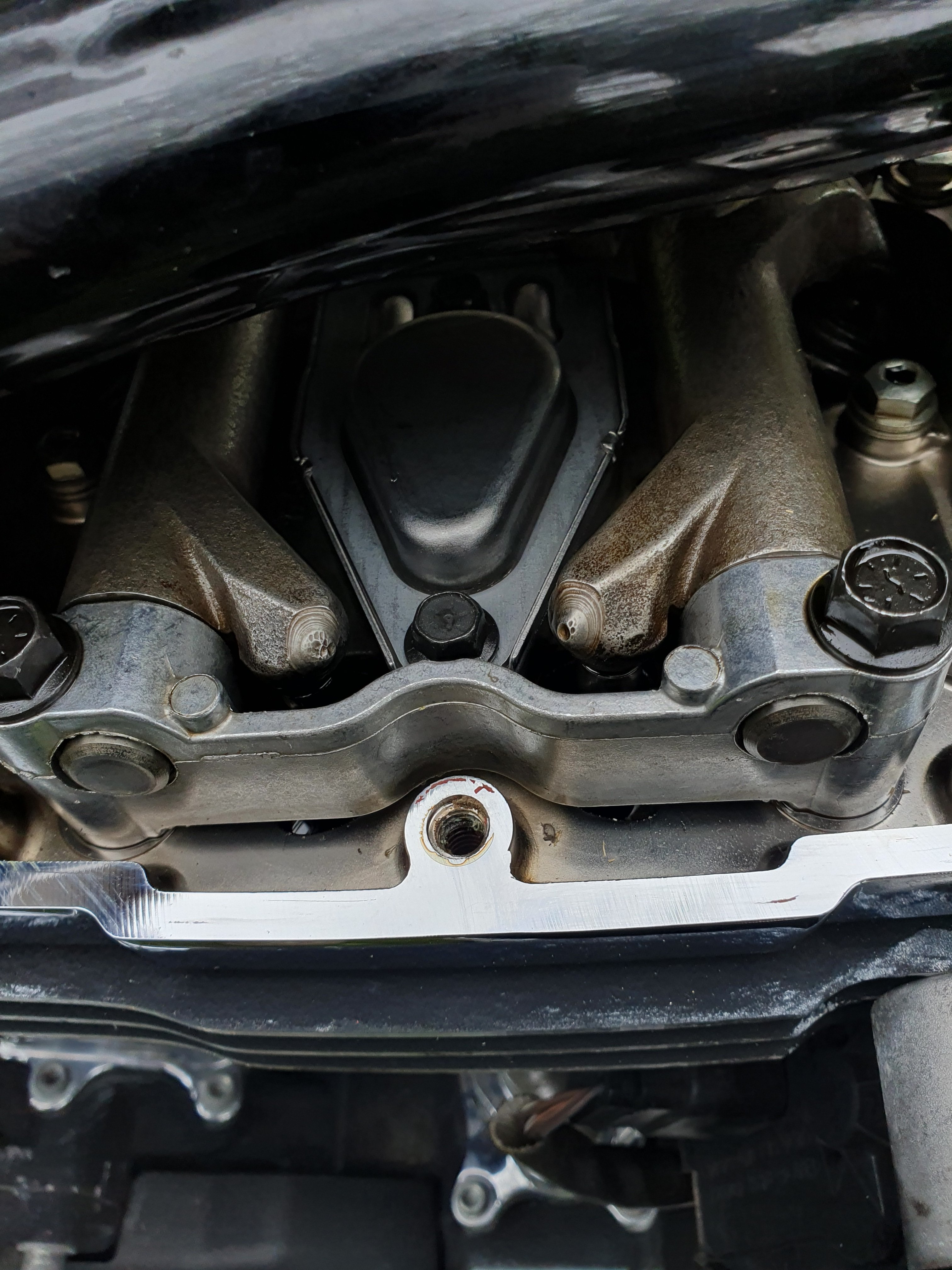

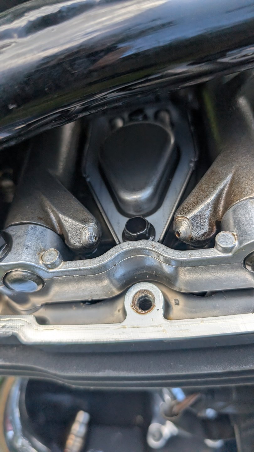

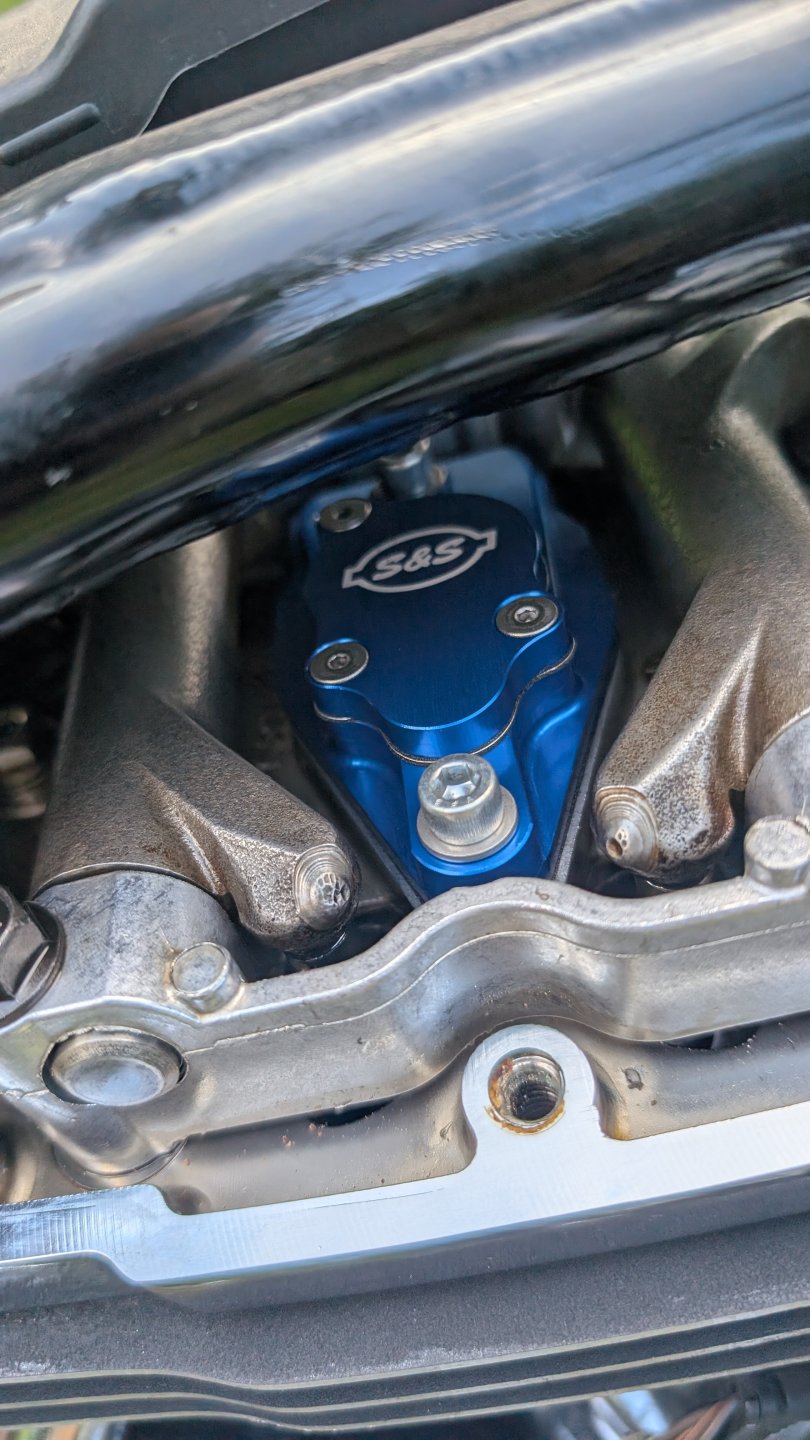

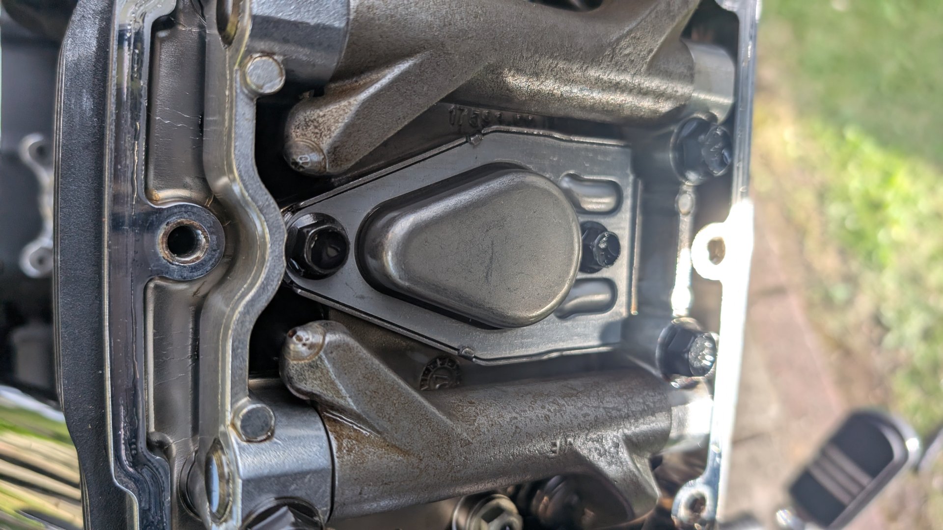

Buckster Posted May 18, 2023 Share Posted May 18, 2023 I had time today so I fitted the new rocker breathers, rear cylinder is a pain because of clearance with the frame so I had to get a 7/16 torque extender which I ended up ordering from the states. Anyway the new style breathers assemblies which were gifted to me by Edinburgh Harley Davidson solved some of the clearance issues. Hopefully no more oil guffing into the air filter for a few thousand miles. First the rear cylinder, removing the old breather. Comparing old and new. New breather fitted. Then the front cylinder. It all looked nice and clean in there which is a good sign. Gaskets looked okay but I fitted new ones anyway, put it all together and warmed the motor up and no leaks so jobs a good one. Couldn't do a test ride as the mot ran out yesterday, I must make a note on the calendar. Going in on Tuesday morning for that. 7 Link to comment Share on other sites More sharing options...

Pedro Posted May 18, 2023 Share Posted May 18, 2023 New one looks Chinese! Which is good, they can make things the old planet killing way, quality! 2 Link to comment Share on other sites More sharing options...
Buckster Posted May 18, 2023 Author Share Posted May 18, 2023 7 minutes ago, Pedro said: New one looks Chinese! Which is good, they can make things the old planet killing way, quality! It's American. 3 Link to comment Share on other sites More sharing options...

Buckster Posted July 23 Author Share Posted July 23 Update! This definitely improved things as in reduced the amount oil in the air filter but didn’t cure it completely. Last week I saw that S&S had come up with anew breather design that they officially say significantly reduces oil blow past in the breathers, unofficially they say it cures it completely so on impulse I reached out and bought a set which they discounted for me. I got them yesterday. They ooze quality but hopefully not oil. I will fit them next week. 1 Link to comment Share on other sites More sharing options...

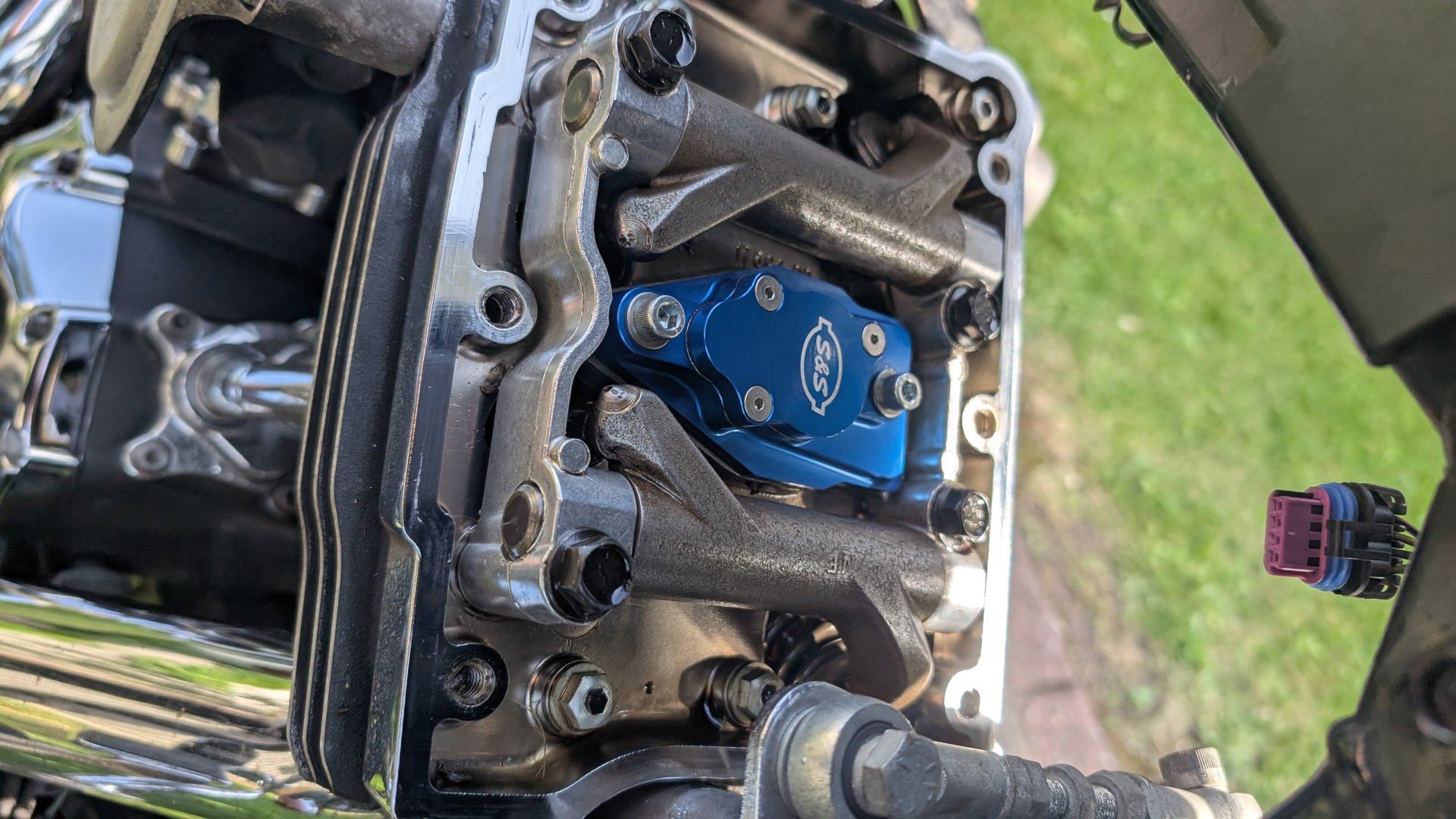

Buckster Posted 8 hours ago Author Share Posted 8 hours ago All done now and early indications are it has cured the oil burp. The new breathers look too pretty to cover up but I'll know they are there. 3 Link to comment Share on other sites More sharing options...
