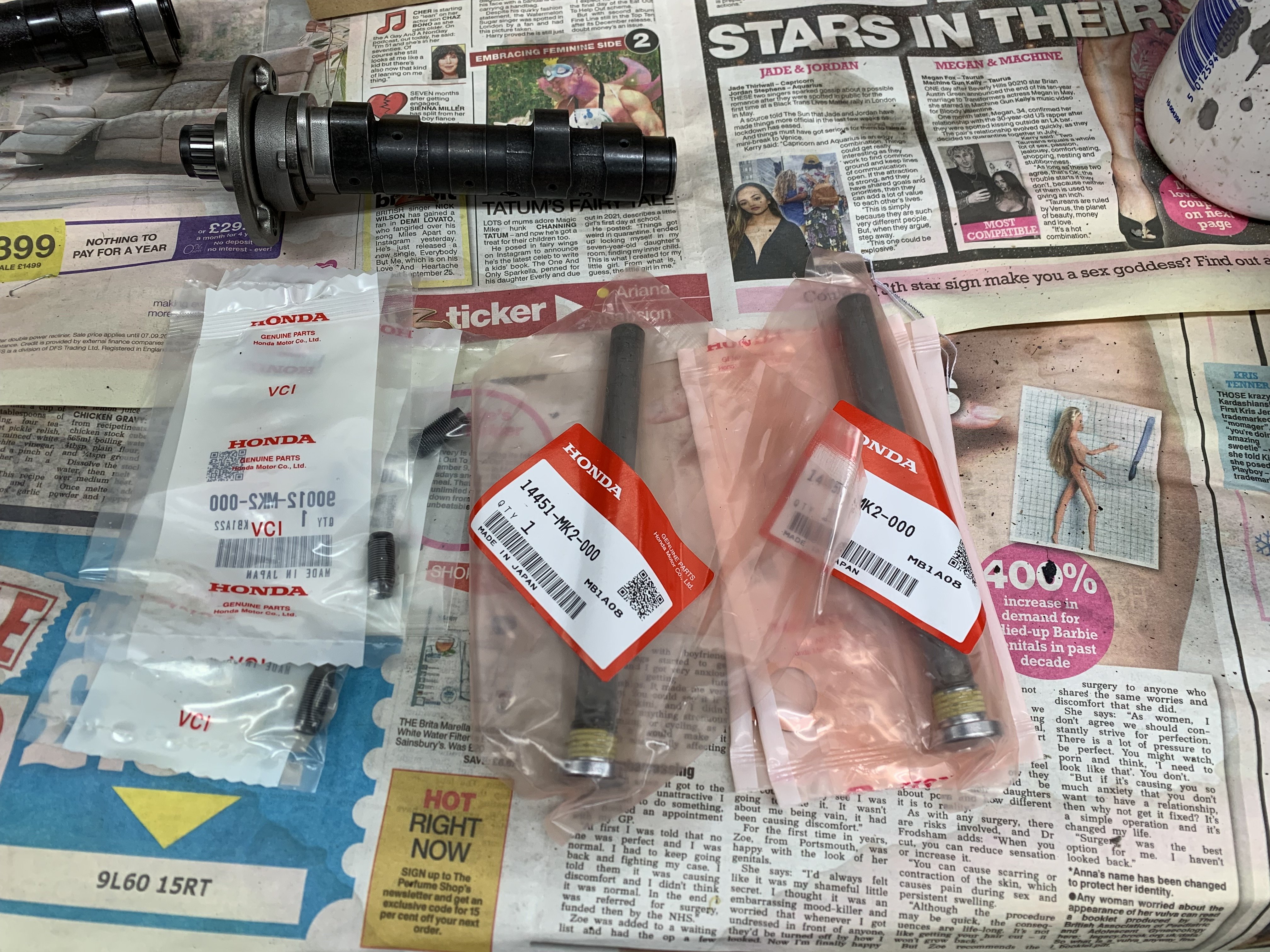

XTreme Posted November 2, 2021 Posted November 2, 2021 2 minutes ago, Sir Fallsalot said: A few new organs to transplant into the monster were waiting for me when i got home from work tonight not much there for £534 After a few hours on the operating table the monster lives again lets hope it lives longer than a KLR this time. I'll finish putting it together tomorrow night take it for a short run then drop the oil and hopefully an MOT on Thursday 3

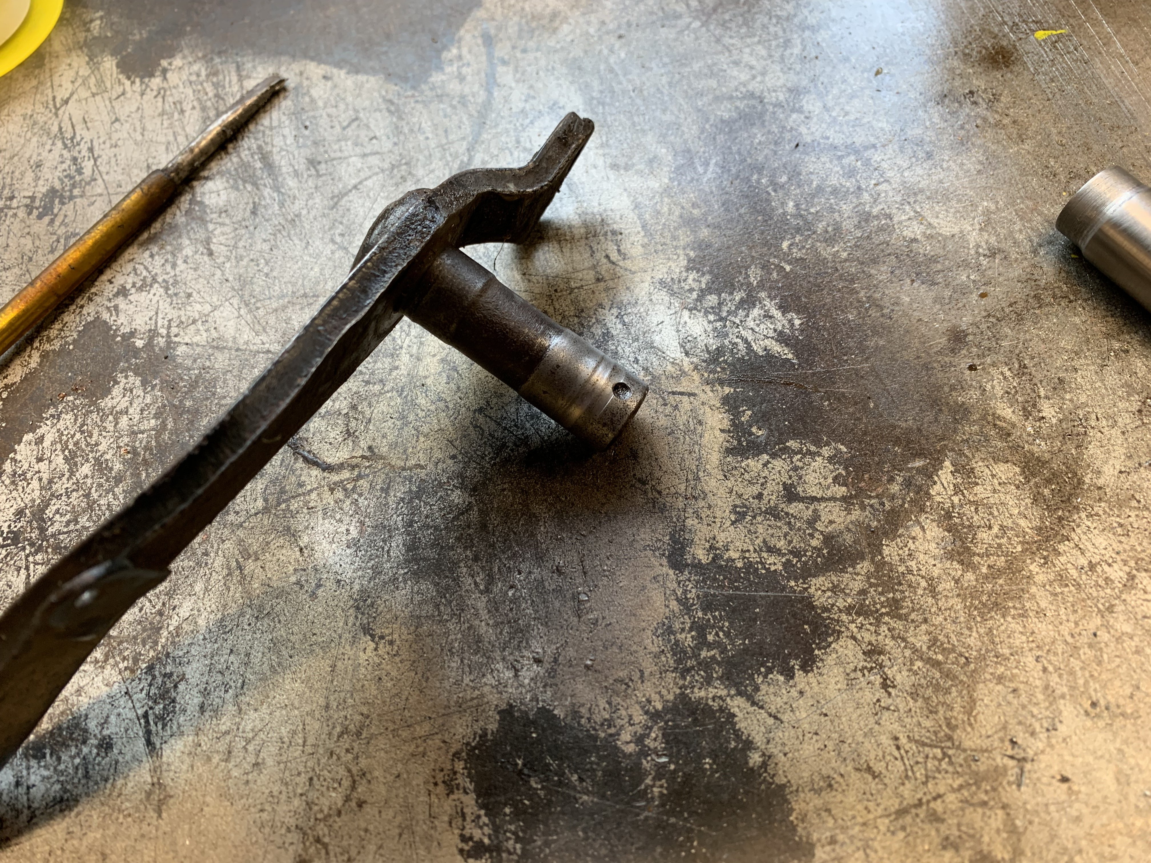

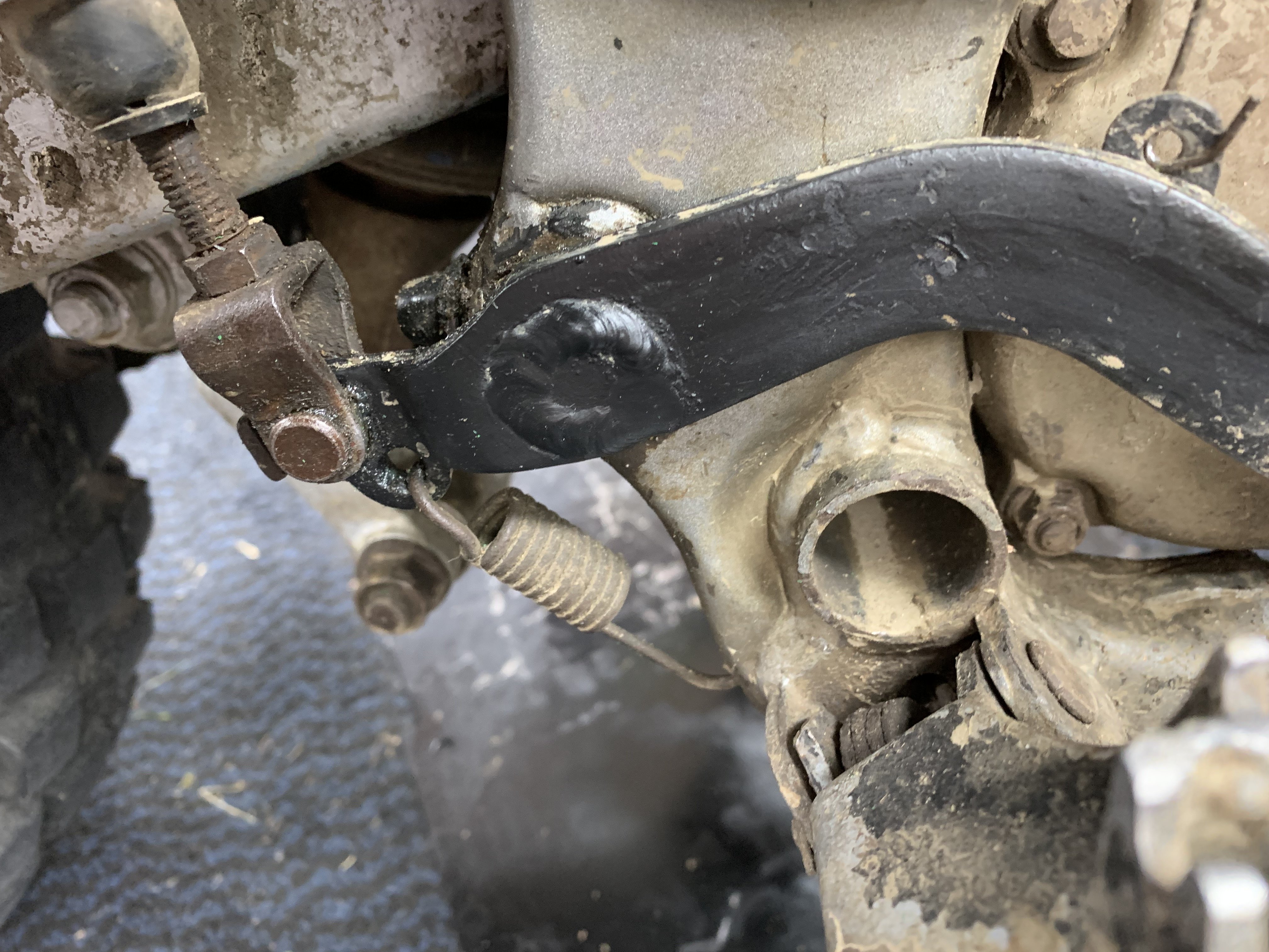

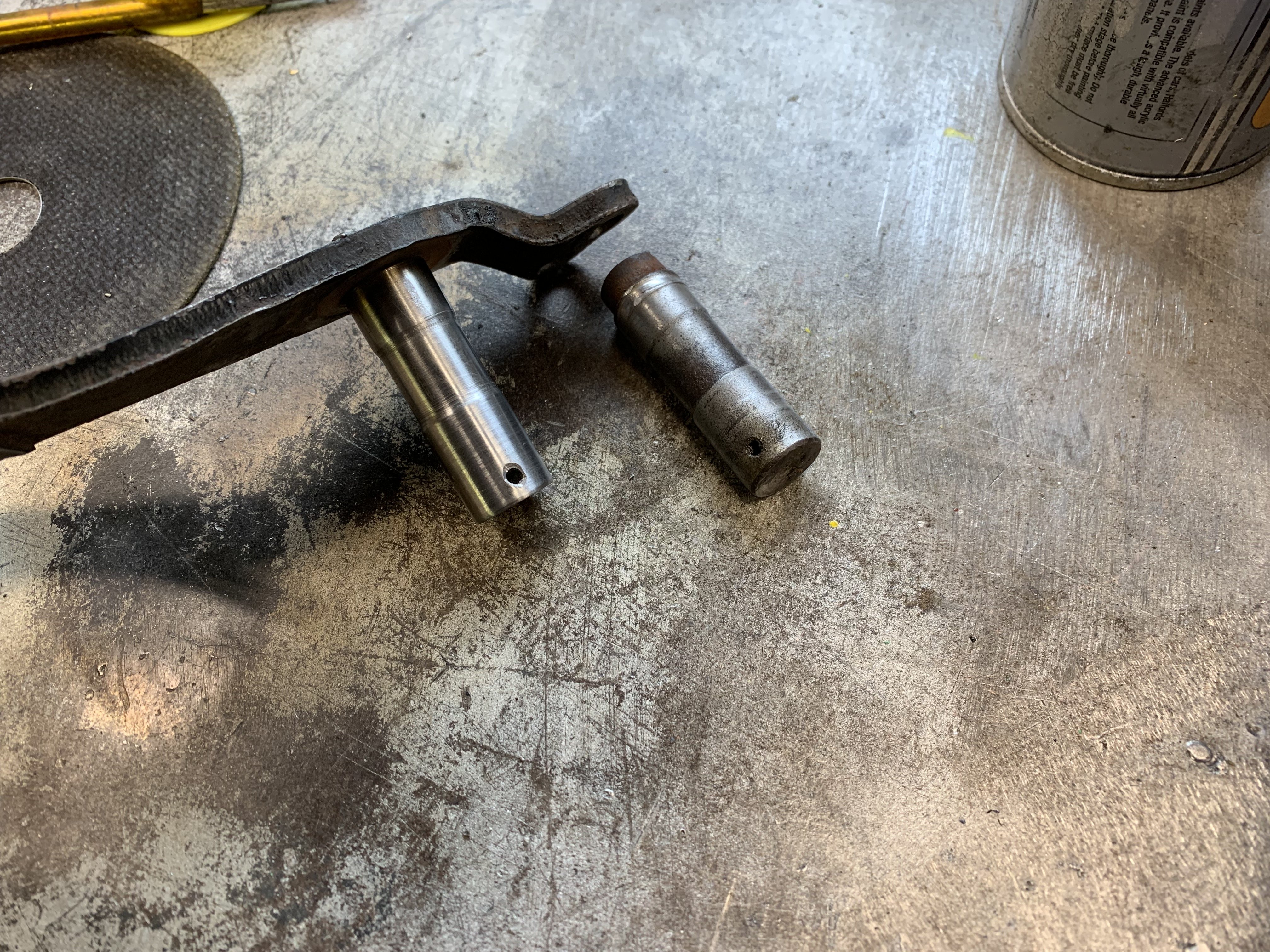

Sir Fallsalot Posted November 5, 2021 Author Posted November 5, 2021 I had lots of wear on the brake pedal shaft and the hole in the frame. Decided to do something about today. Drilled the hole in the frame slightly larger and turned up a new shaft quite enjoyed doing it and pleased with the result Old one looking poorly New one all shiny pity you wont see it when fitted Then went out for another test ride rear brake travel much improved and i decided i'm so glad i stumped up the cash to fix the dog i forgot how much i enjoy it nothing like a big single thumping away between your legs 5
boboneleg Posted November 5, 2021 Posted November 5, 2021 3 minutes ago, Sir Fallsalot said: I had lots of wear on the brake pedal shaft and the hole in the frame. Decided to do something about today. Drilled the hole in the frame slightly larger and turned up a new shaft quite enjoyed doing it and pleased with the result Old one looking poorly New one all shiny pity you wont see it when fitted Then went out for another test ride rear brake travel much improved and i decided i'm so glad i stumped up the cash to fix the dog i forgot how much i enjoy it nothing like a big single thumping away between your legs That's superb Fred, how did you fix the shaft to the pedal ? 1
Sir Fallsalot Posted November 5, 2021 Author Posted November 5, 2021 7 minutes ago, boboneleg said: That's superb Fred, how did you fix the shaft to the pedal ? Its welded on the outside ground the old weld off punched out the old shaft pushed the new one in and rewelded it 1
boboneleg Posted November 5, 2021 Posted November 5, 2021 1 minute ago, Sir Fallsalot said: Its welded on the outside ground the old weld off punched out the old shaft pushed the new one in and rewelded it That's what I thought you'd say but I didn't realise you could weld , top man what say you @XTreme 3 1
XTreme Posted November 5, 2021 Posted November 5, 2021 7 minutes ago, boboneleg said: what say you @XTreme 2
Sir Fallsalot Posted November 5, 2021 Author Posted November 5, 2021 30 minutes ago, boboneleg said: That's what I thought you'd say but I didn't realise you could weld , top man what say you @XTreme Well there's welding and there's the thing i do, I was happy with this weld current was a bit high but couldn't be arsed to do a test weld first and no grinding after, bonus 6

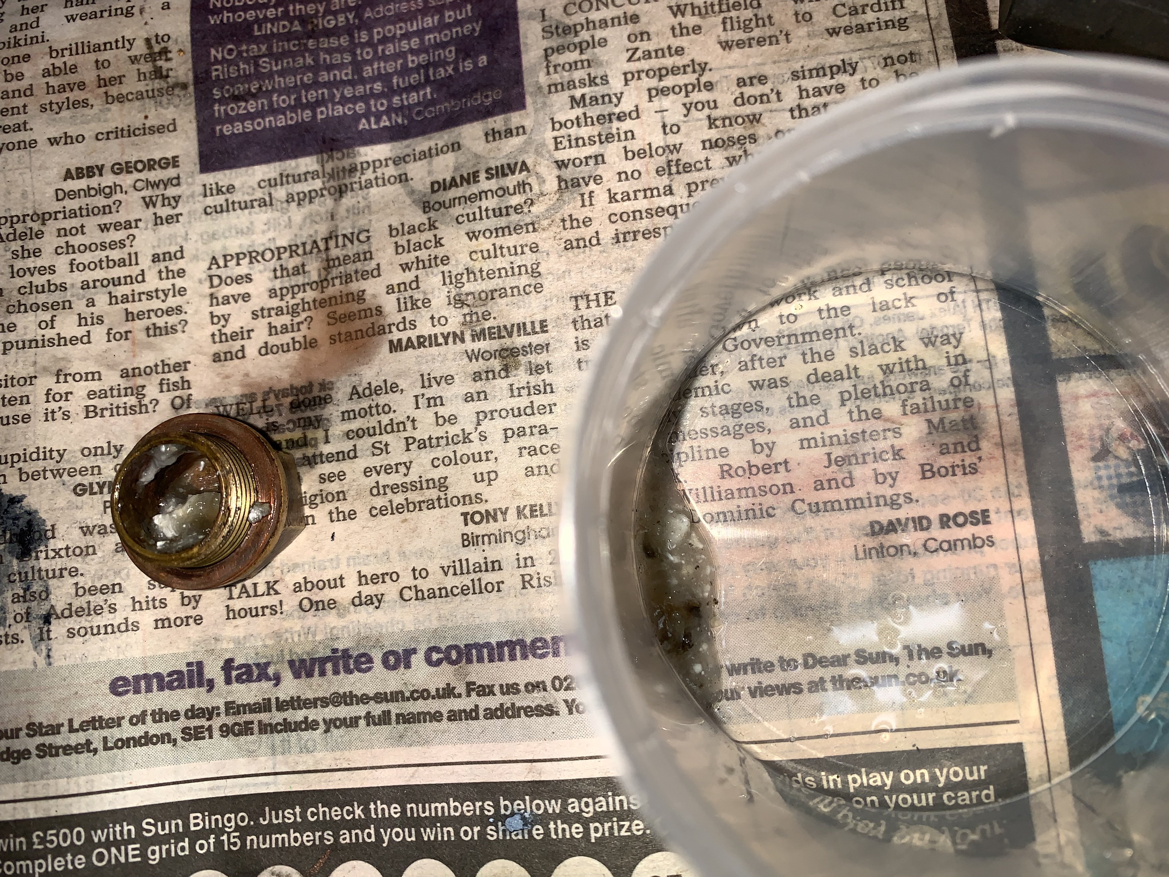

Sir Fallsalot Posted December 3, 2021 Author Posted December 3, 2021 Took the bike out to warm it up for an oil change tonight and the bloody thing went all fluffy on me for a short while so when i got home i took the float bowl sump bolt out for a look, I think I've found out why the bike died on me on the way home last ride What the fuck is that shit the carb was spotless when i put the bike back together and so is the tank. The crap in the plastic container was in there as well 3
XTreme Posted December 3, 2021 Posted December 3, 2021 11 minutes ago, Sir Fallsalot said: Took the bike out to warm it up for an oil change tonight and the bloody thing went all fluffy on me for a short while so when i got home i took the float bowl sump bolt out for a look, I think I've found out why the bike died on me on the way home last ride What the fuck is that shit the carb was spotless when i put the bike back together and so is the tank Somebody's cum in your carb? That's the sort of deviant behaviour that DA used to get up to! What you say @Tym? 2
