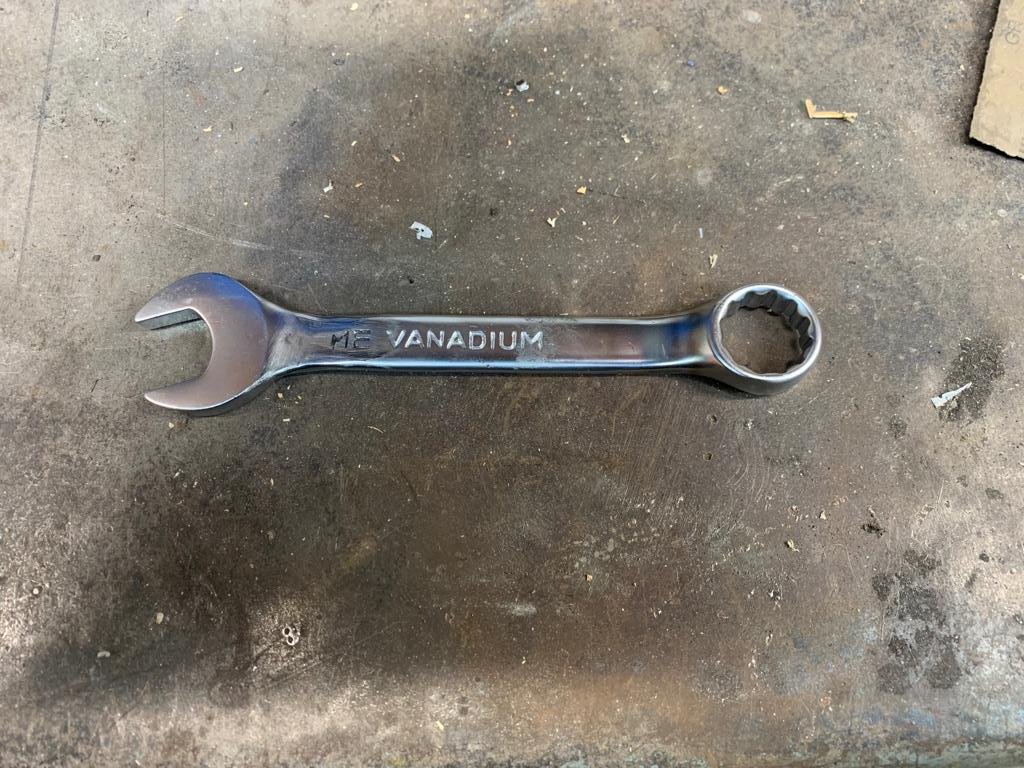

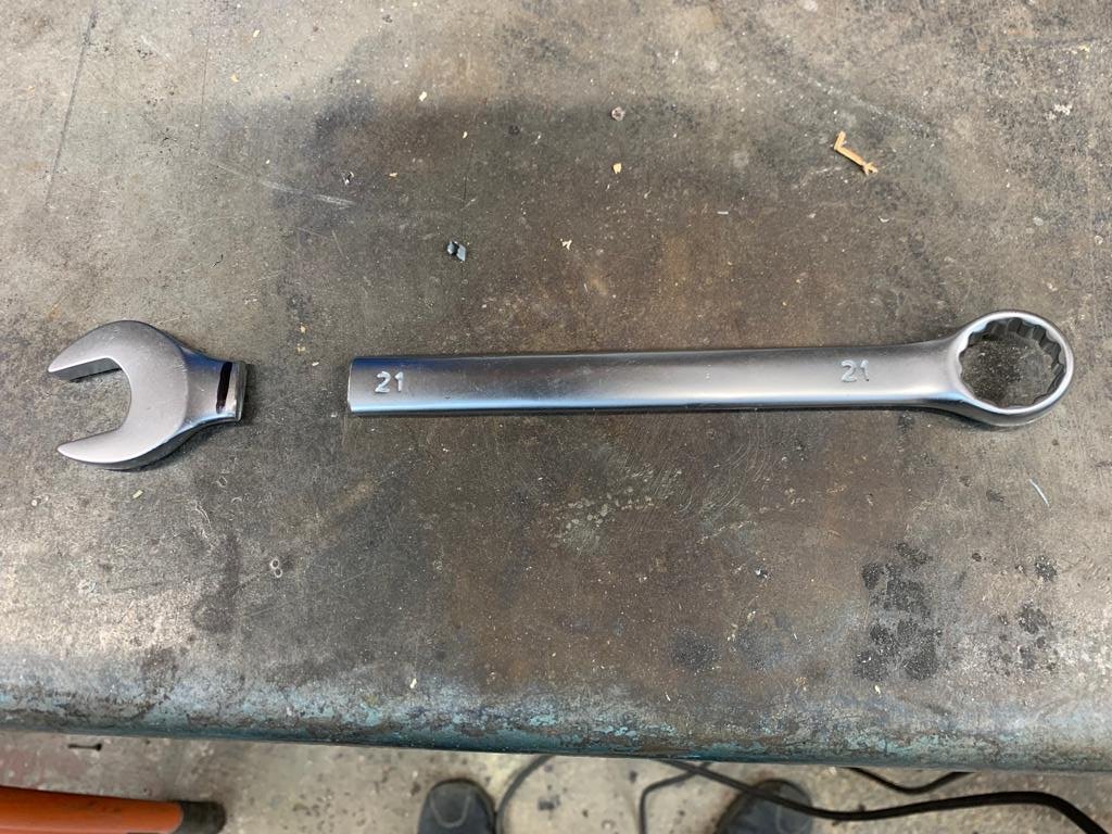

Boring post for the non mechanical members here but tonight's project was a result of drowning the bike last weekend, i found the factory spark plug spanner wouldn't work with the bigger tank fitted as the ring is a six point and there's not enough space for the spanner to work, i needed a 12 point for it to work so i bought a cheep spanner to modify and it arrived today
267957474_WhatsAppImage2022-11-16at7_24_56PM.jpeg.f6bbe265ff15dd5e6be28fd057b72647.jpeg
First job was to shorten it as its too long to fit in my tool bag so off with its head

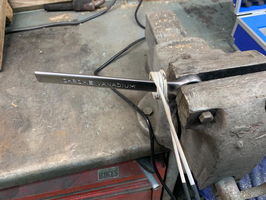

Then i need to straighten it, the crank at the end made it an awkward fit i used a cheapo induction heater i bought years ago to get it red hot to bend really useful tool
1189407273_WhatsAppImage2022-11-16at7_24.55PM(3).jpeg.9a8cb7d1ebae0e0ab1ca8831226a0b05.jpeg

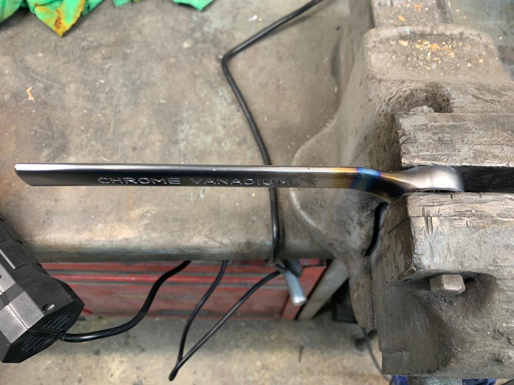

now straightened its easier to use in the space
1133338335_WhatsAppImage2022-11-16at7_24.55PM(2).jpeg.09bf9f7ba776254f3c31fb35f1e53234.jpeg

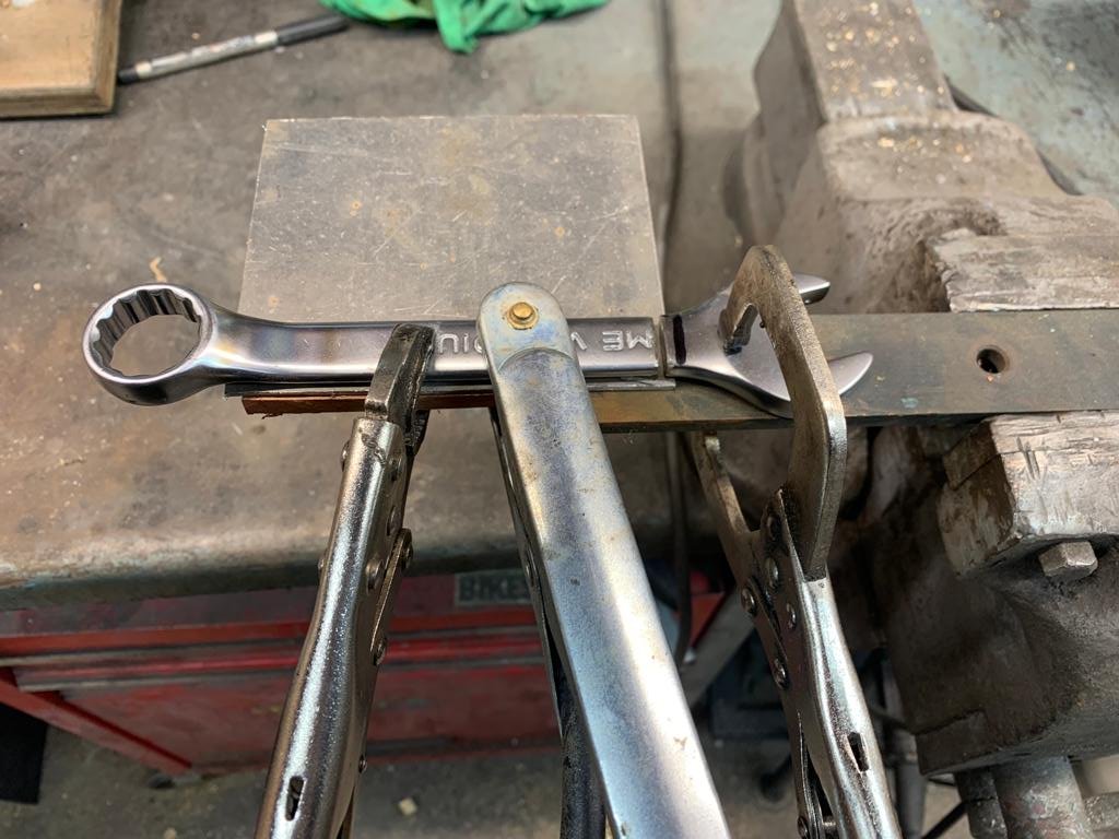

Ready to weld the open end back on wasn't going to bother but it might come in handy one day
1846536009_WhatsAppImage2022-11-16at7_24.55PM(1).jpeg.8f5c6f289edb3cc7c3b09da92271fdb9.jpeg
Welding done
1615807582_WhatsAppImage2022-11-16at7_24_55PM.jpeg.81ac668e177a4a48569e0436f1cb036c.jpeg

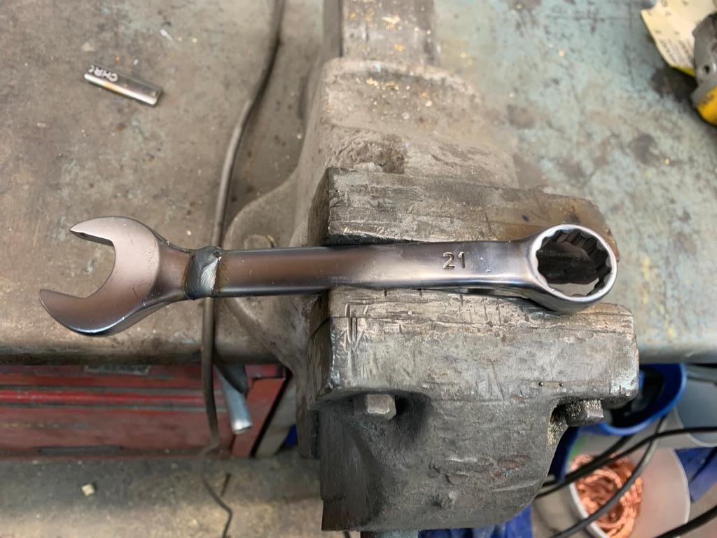

All ground back and cleaned up, works a treat hopefully i'll never need it again LOL
1927885595_WhatsAppImage2022-11-16at7_24_54PM.jpeg.6e72ce5c5fba0f43ad6e094b31b10351.jpeg

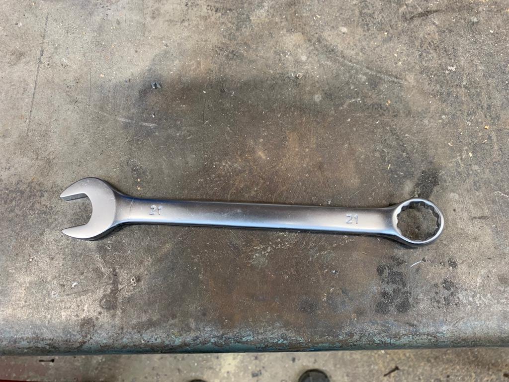

Welding done
What did you cut through it with? If I took an angle grinder to something like that it wouldn't be a nice clean cut like you have there, it would be a skittish mess 😆

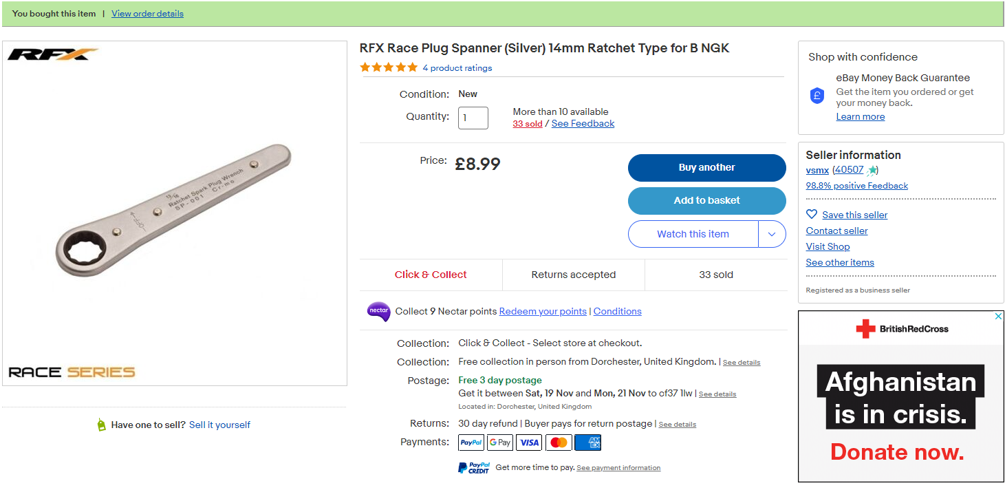

Well my effort was wasted, i mentioned it to a mate last night and he said i got to get myself one of these
I didn't even know they made such an animal so i ordered one, should be here by the weekend
Got to use the 1mm thick slitting discs
