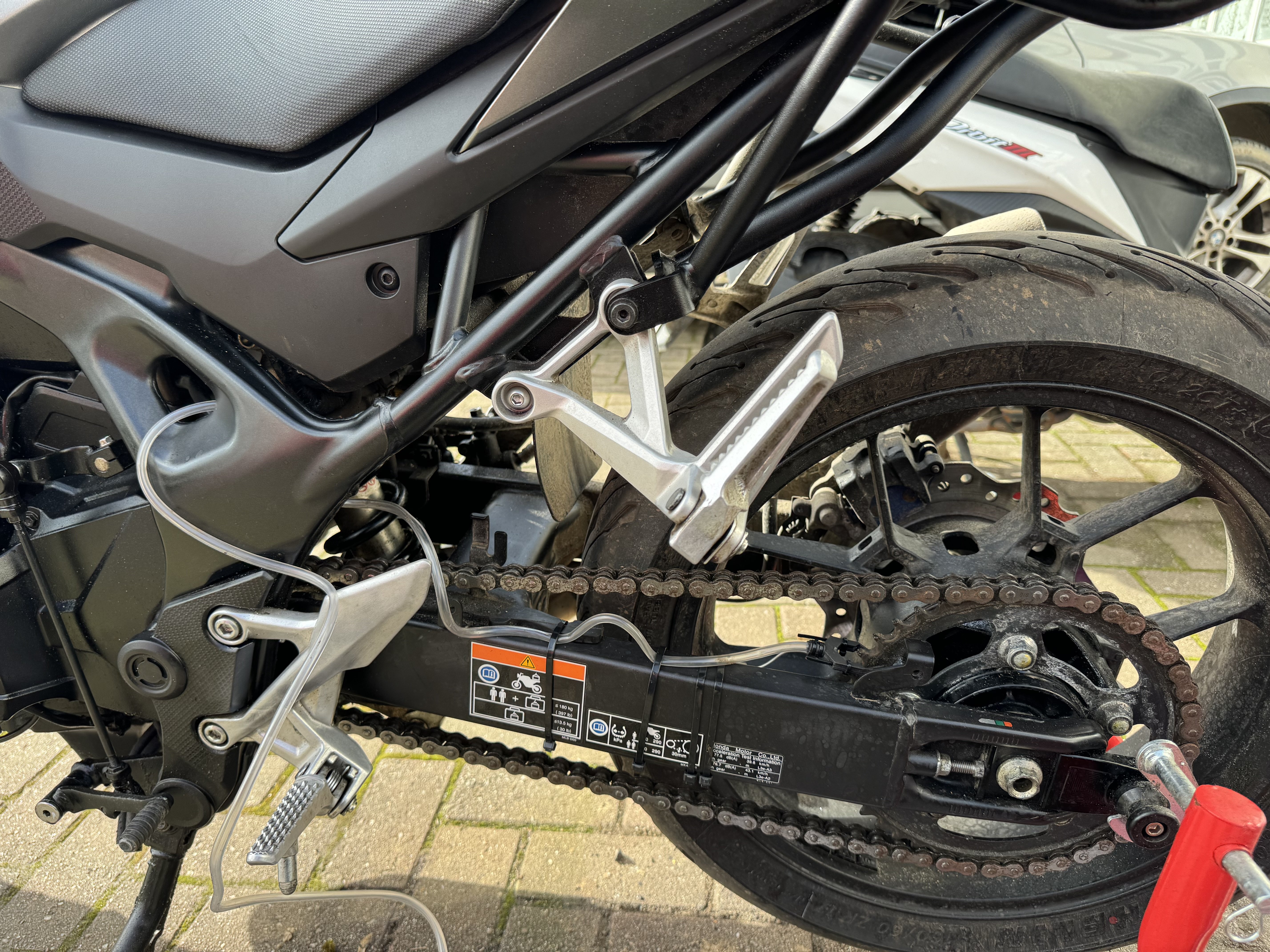

Well a year and a bit later I got around to fitting my Loobman.   It went on easy enough and seems to work as intended but I suppose only time will tell as to how effective it is.

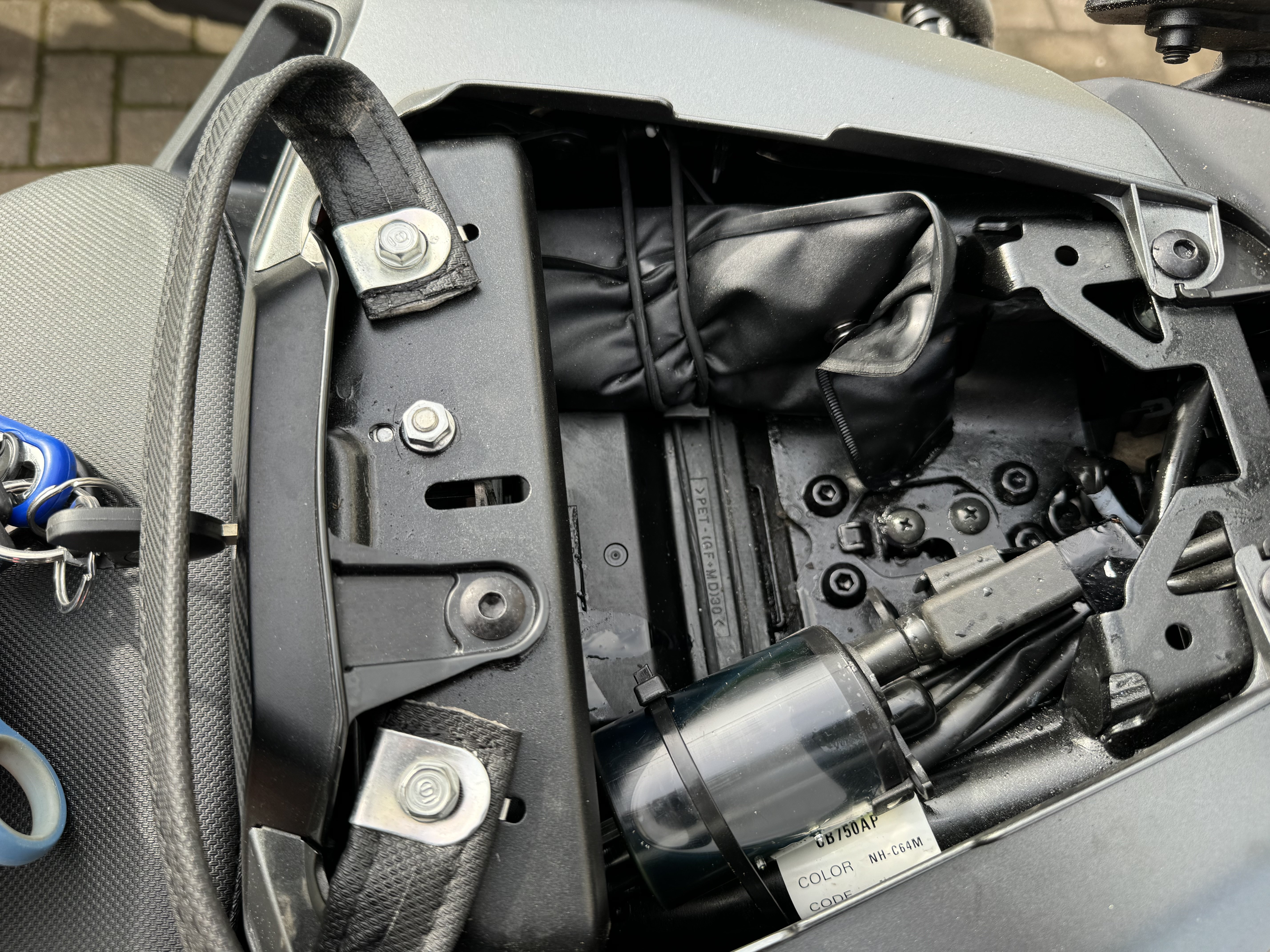

I managed to tuck it away so it’s not very visible.   The idea is you press down the plunger on the oil reservoir before you ride for 10 seconds and that releases a measure of oil the drips onto the sprocket and eventually the chain while you ride.  It was developed by three guys working as despatch riders.  Apparently.

Reservoir under the back seat.

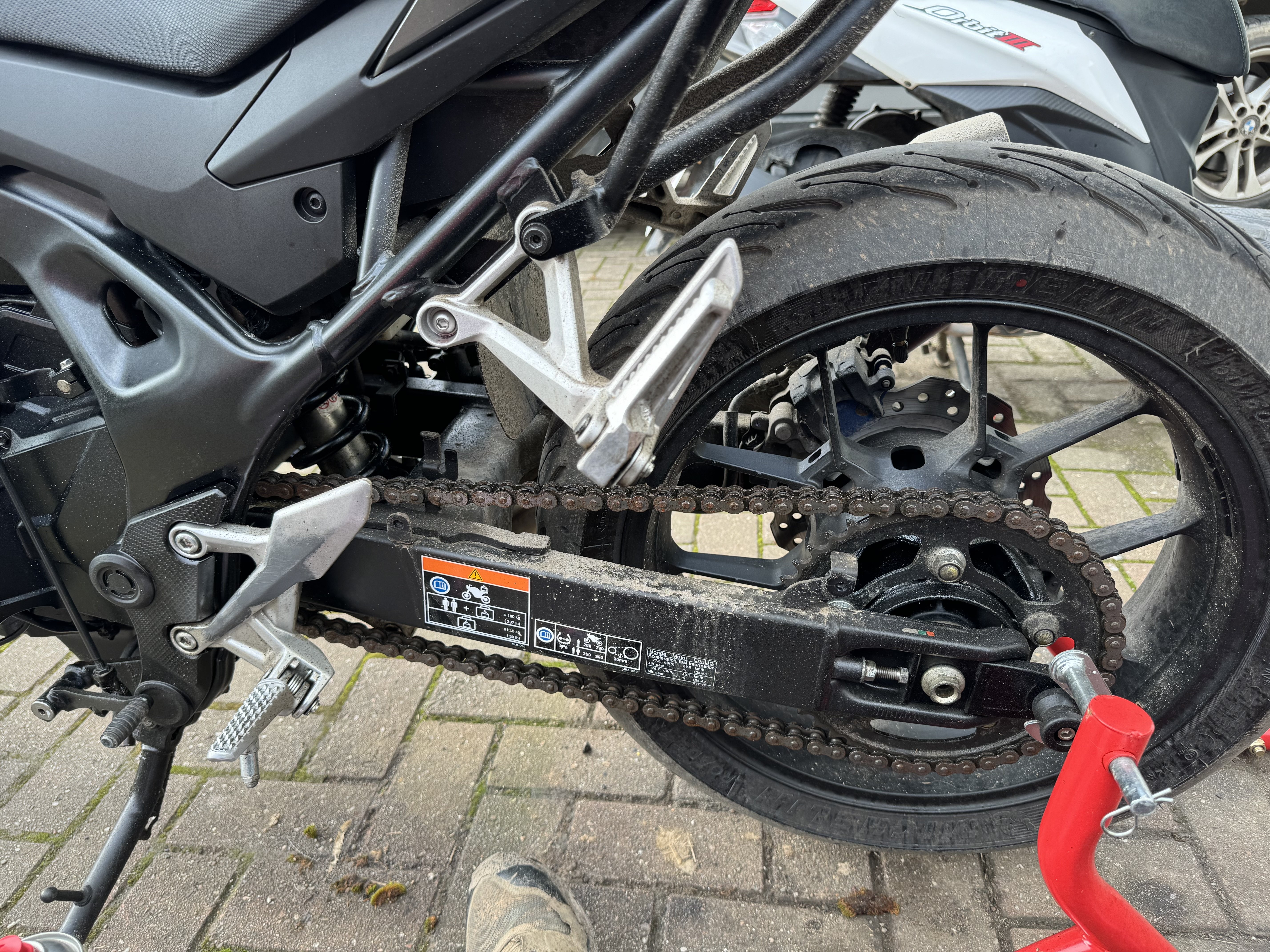

It's not dripping near the back wheel it is dripping directly onto the sprocket on both faces then centripetal force pushes it onto the chain.   No different to oiling your chain from a can.   I am done with these bloody chain waxes and stuff they just don't keep the chain clean especially in winter.    I have been using good quality stuff this winter on the Hornet, exactly as described and the chain has flash rusted twice, bloody annoying.

I was using this stuff, and it wasn’t cheap.  Not at all happy with it.
I used Banana Slip before that and some Wurth stuff before that.   I’m fed it with it all so going back to regularly oiling my chain.   Each to their own but I never had problems doing that in the past.
