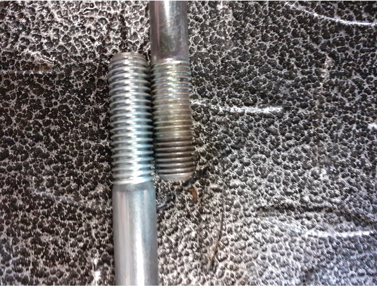

Side stand now only supported by the electrical connection, so I found something for it lay on and switched sides to the exhaust hanger bolts that needed to come out. Tea now drunk, Nightboat to Cairo by Madness is playing, love that song. A 10mm bolt about 4 inches long and a smaller 8mm bolt came out with no arguments. Time to start fitting the first bash plate bracket bolts in their place. I found the two replacement bolts which are slightly longer to allow for the thickness of the brackets. The larger one goes in and I start to turn it, but it doesn't feel right. I always put bolts in by hand so as not to wreck a thread and it wouldn't even start. I took it back out and compared it to the Yamaha original. I'm no thread expert and I have middle aged eyes these days but the pitch looked closer together on the original bolt. Bad picture below, the grubby one is obviously the original bolt. I found a nut that would run down the Altrider bolt, it wouldn't go near the Yamaha one. Anyway, out came the plastic bags and I refitted everything. I've emailed the manufacturer for advice. Worst case scenario, I buy my own bolt, but I could have wrecked the thread on the bike if I'd gone in gung ho with a ratchet.

Yen, get yourself one of these.    One of the best things I ever bought.  It has bolt size gauge, thread gauge and length.
https://www.pro-bolt.com/progauge-bolt-measuring-tool/
I think I will, thank you for the link. I normally press the bolts together and the threads fit together, locking into each other.

Just had an email from across the pond apologising and offering to Fedex a replacement bolt today. I can't argue with the speed of response seeing as I only emailed on Saturday afternoon.
That simple reply will give you confidence to use them again i know it would with me
My replacement bolt was waiting for me when I got home from work yesterday.

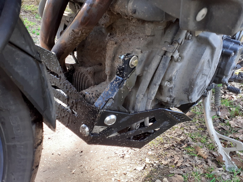

It's on, only had a single washer left over as well!!!!
Lost two sockets somehow. The good thing about having my sockets and ratchets in order on those plastic things is that I know when something is missing and what it was. One was a hex/allen socket which had I found had stayed in the side stand monster bolts that I had trouble undoing at the very start of this thread. One down two to go.
The other was a 6 sided 14mm socket. I knew it had dropped off of one of the bolts as I was working round the skid plate tightening fasteners and it was easier to get a 12 sided 14mm and carry on and I thought I would look for it afterwards. I hadn't seen exactly where it went to but  it hadn't sounded like it went far or even on the floor if you know what I mean. I did about 5 circuits of the bench with a torch, even rechecked all my magnetic dishes in case it had stuck underneath. Finally it occurred to me that I hadn't looked inside the new bash plate.....that's where it was. Long screwdriver pokey time to get it within reach.
Went out for a brief ride to make sure all was well and that my side stand was not going to fall off. The bash plate reverberates a bit so I stopped once to make sure all the bolts were tight in case I'd missed one, but no, looks like that is just what it does.
