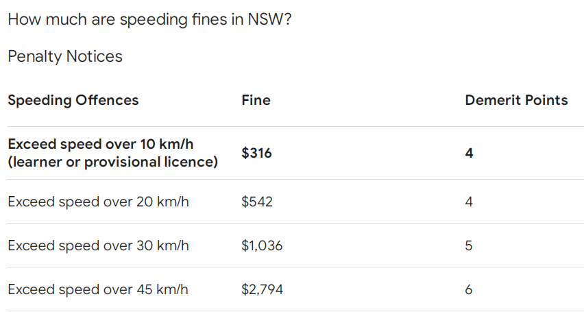

That's cruising at around the speed limit, around here speeding is treated like murder with ridiculous penalties and at my age I prefer to take it easy, you may find the same if you ever grow up.

Another thing here is that if you get a speeding ticket they can suspend your bus permit.

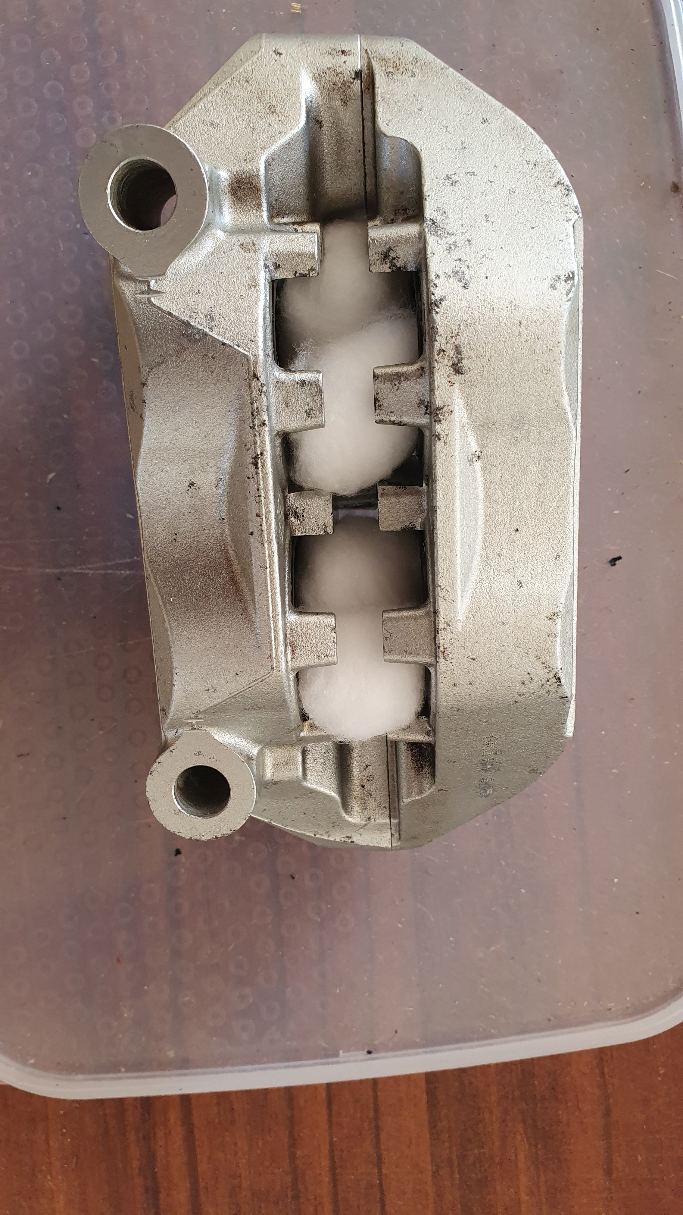

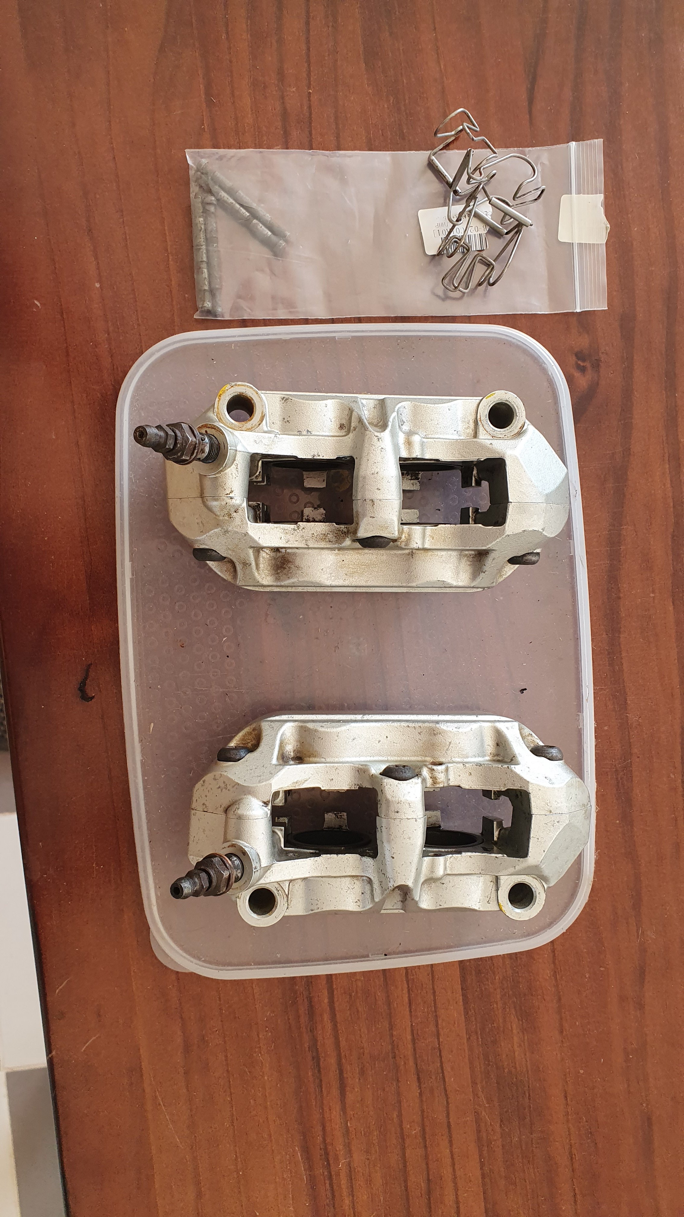

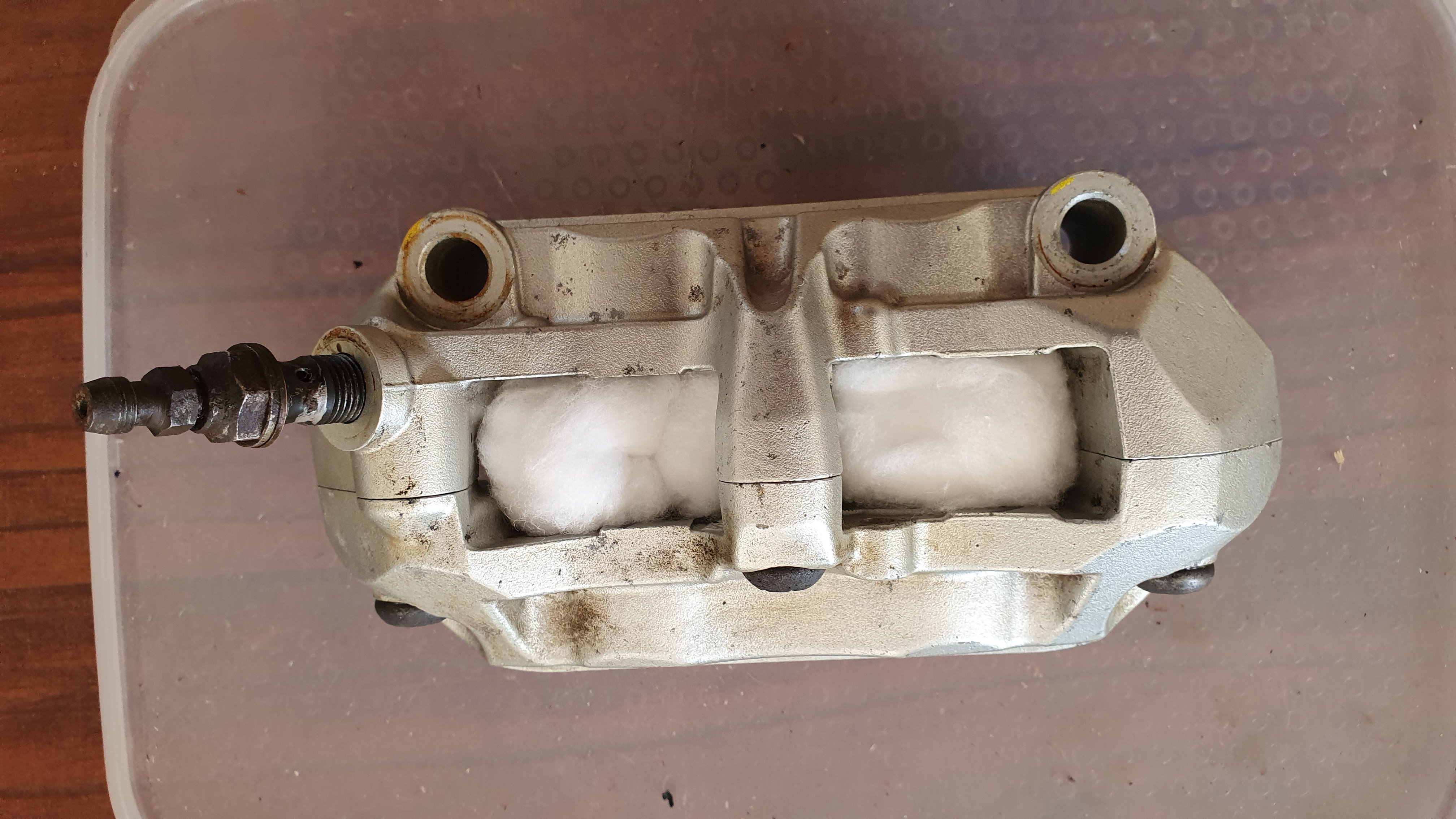

Calipers are done, forgot to take photos but its a pair of calipers, the pistons cleaned up nicely and slid in like a Welsh shepherd getting into a well oiled gumboot.
Next episode will be when the VHT cast aluminium paint arrives and once painted I can fit the pads and bolt them onto the bike, then a quick bleed and the major hurdle is out of the way.

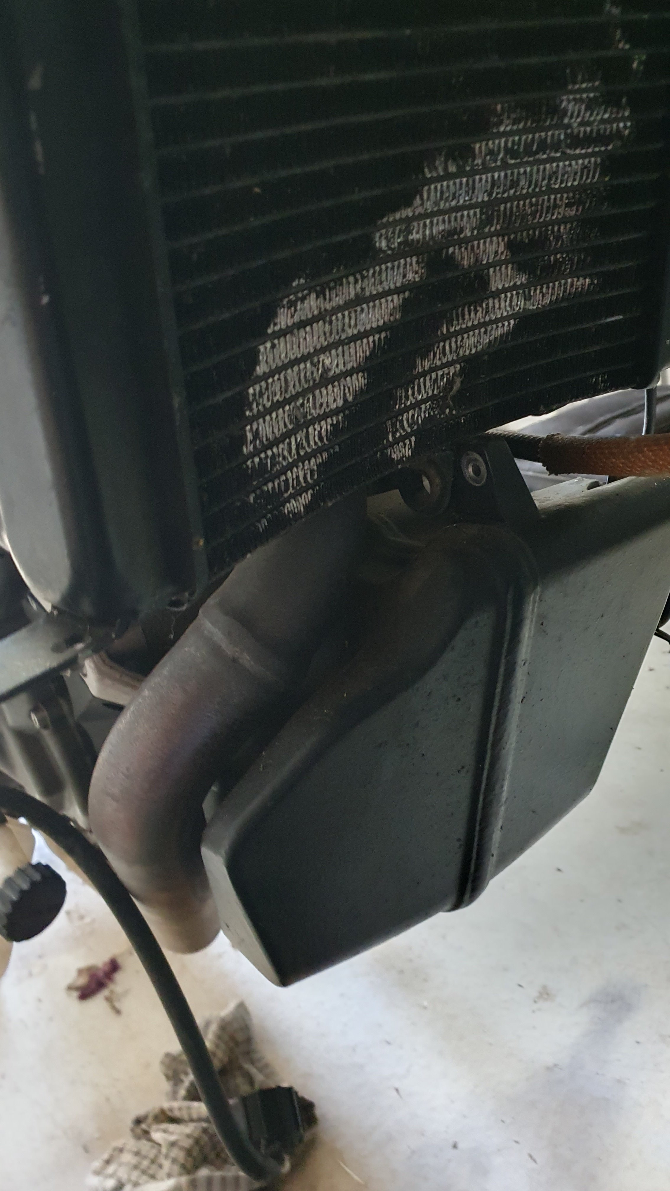

Started to remove the radiator, the fins are a bit flattened in one area so I thought I'd lay it flat and smooth them out with a skewer but I'm not so keen to remove bits if I can avoid it.

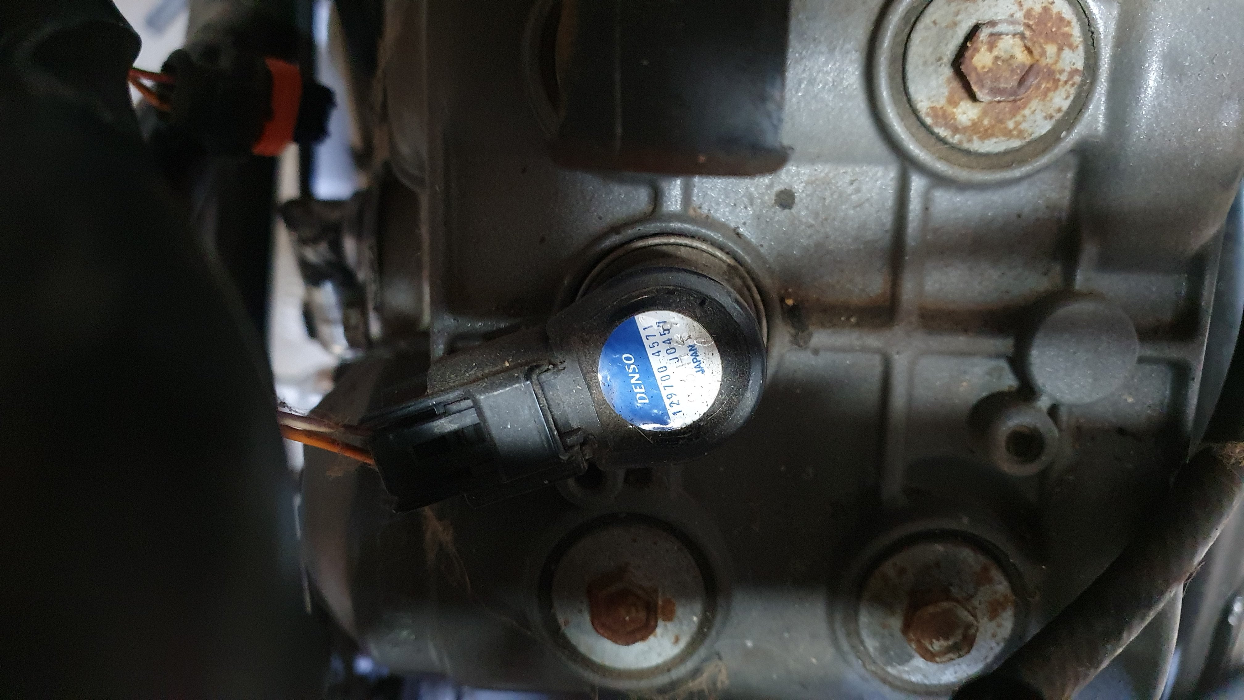

I have unbolted it to move it forward to get at the front sparking plug so I might do the plugs first, they have a connector on them I've never seen before and I wonder what is the best way to take it off.
Don't want to damage it as it would probably take a year to get a replacement.
So here you go, calipers, one ready for paint, spark plug cap and damage to the radiator, as it doesn't leak I thought of giving it a quick spray.
That's know as a pencil coil. That's what used now instead of the HT lead and cap.
How many miles you done on this bike?
Should pull out after unplugging and could well be tight. Also known to be a basted if rust has got into it as it expands and locks itself in place.
Had a few out in bits.
There should be a small clip here which you can depress with a flat bladed screwdriver, then pull gently backwards on the connector.
