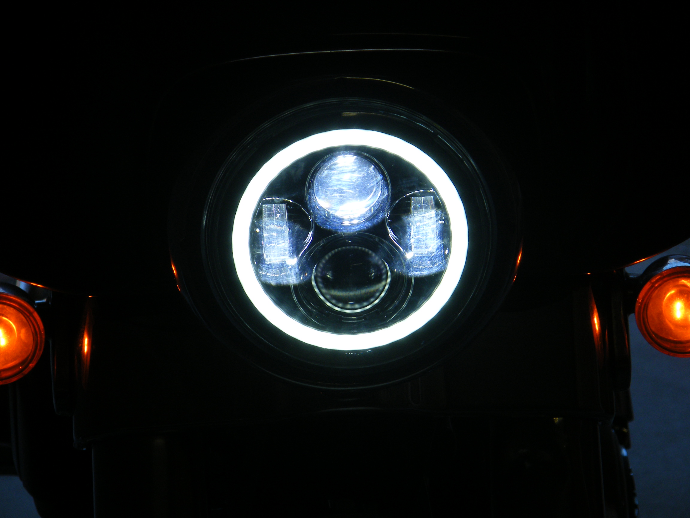

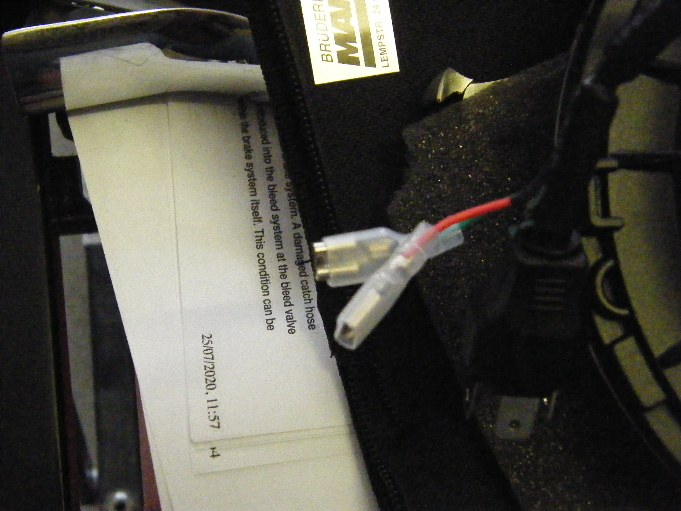

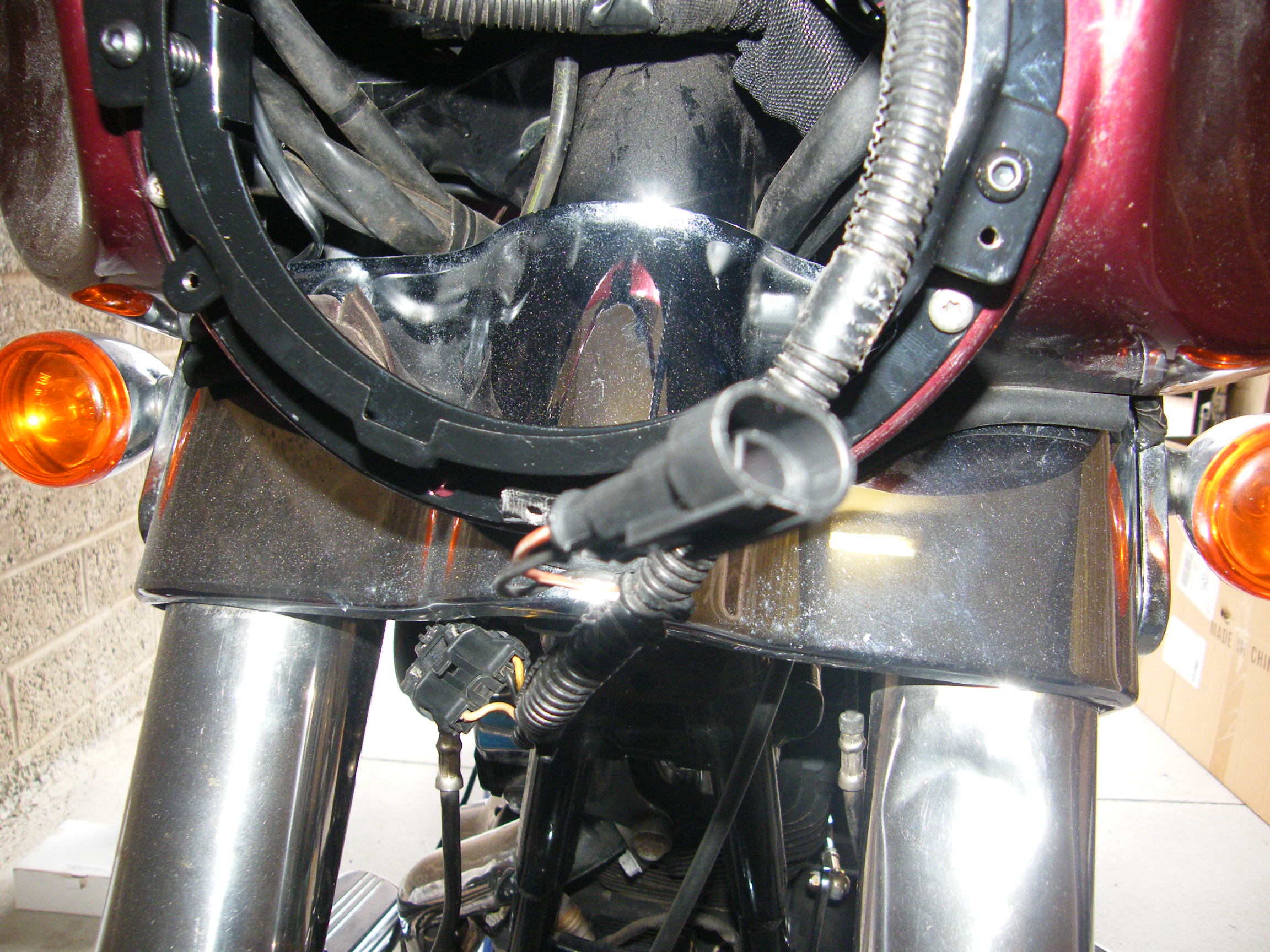

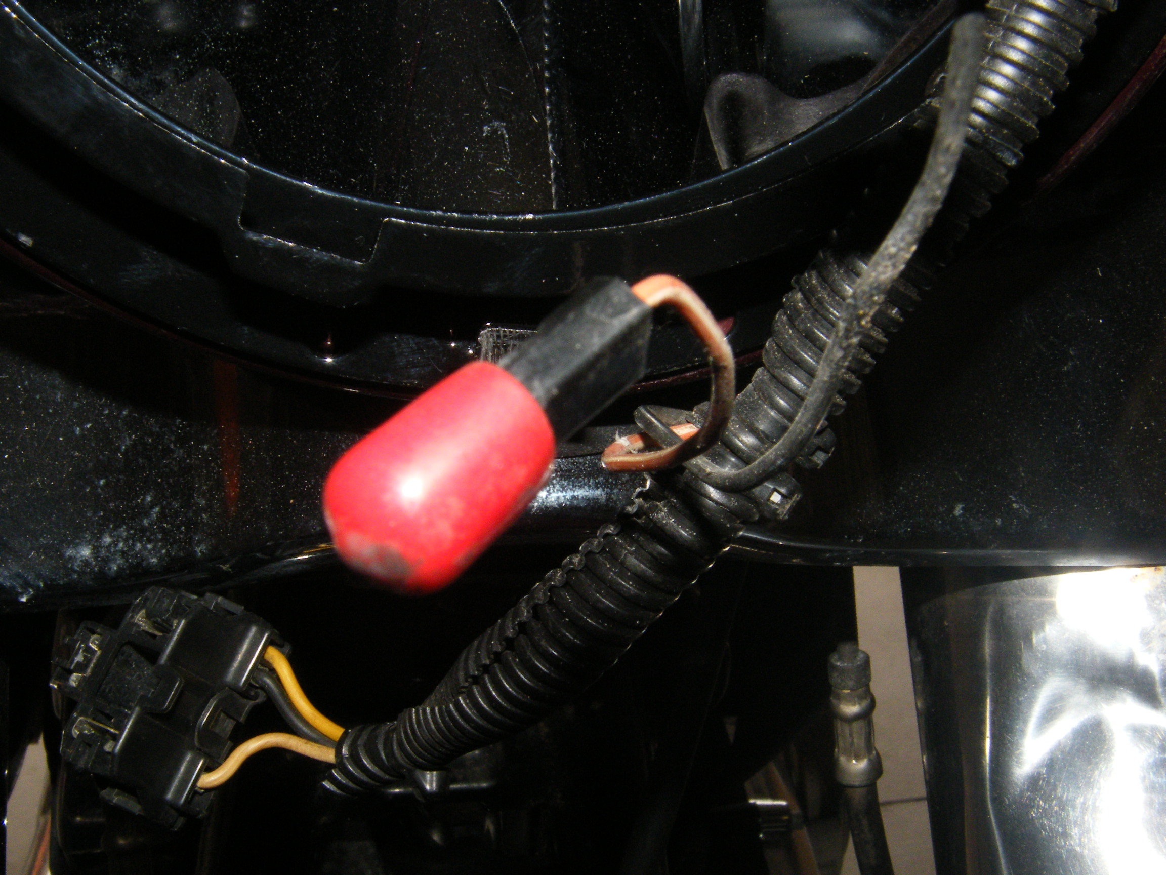

Well I fitted the electrical connectors and fired up the halo on the new headlight, I also modified the mount so the existing headlight rim fits better.
These were the spade connectors on the headlight and the bike.DSCF0126.thumb.JPG.f64f17be686d232ca1cc221ed580f412.JPG

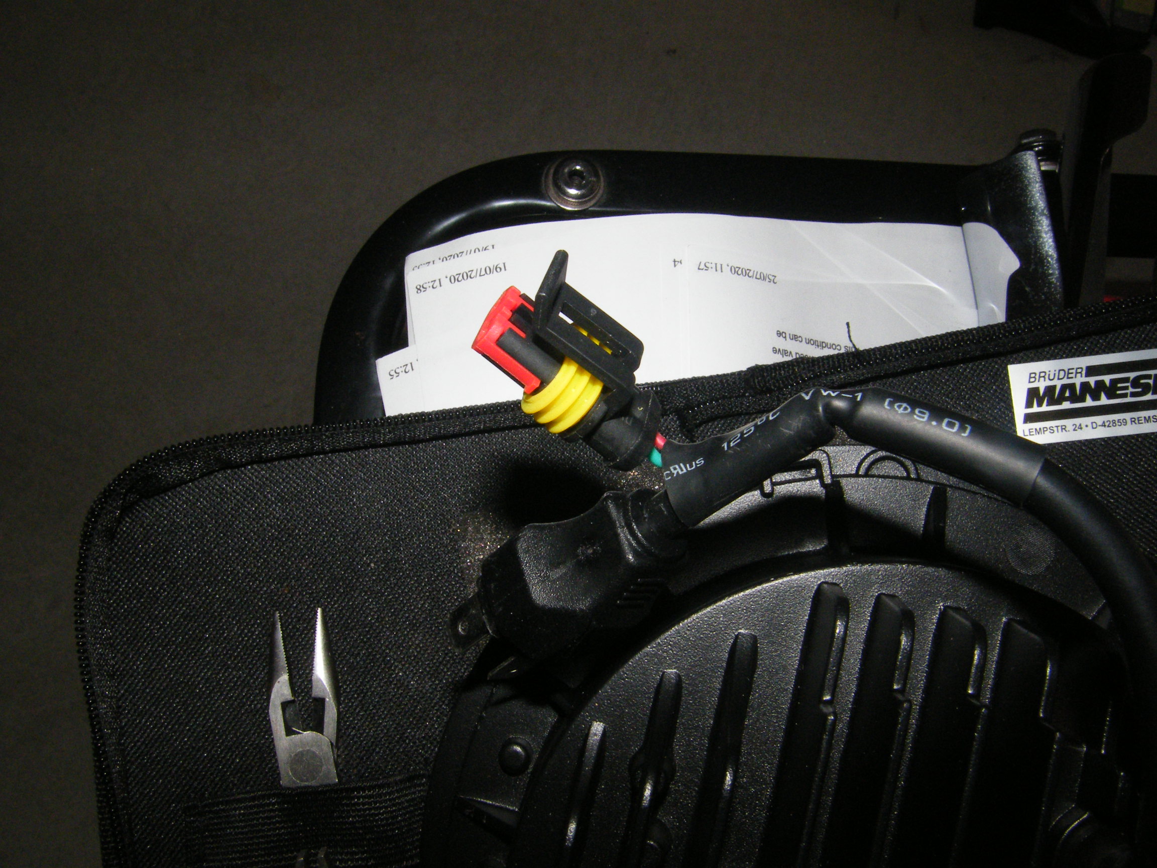

These are the new connectors.
DSCF0130.thumb.JPG.268ea16c1e6fd1283542f8bf13b398b5.JPGDSCF0129.thumb.JPG.f785b58063449a5912534250715ad28d.JPG

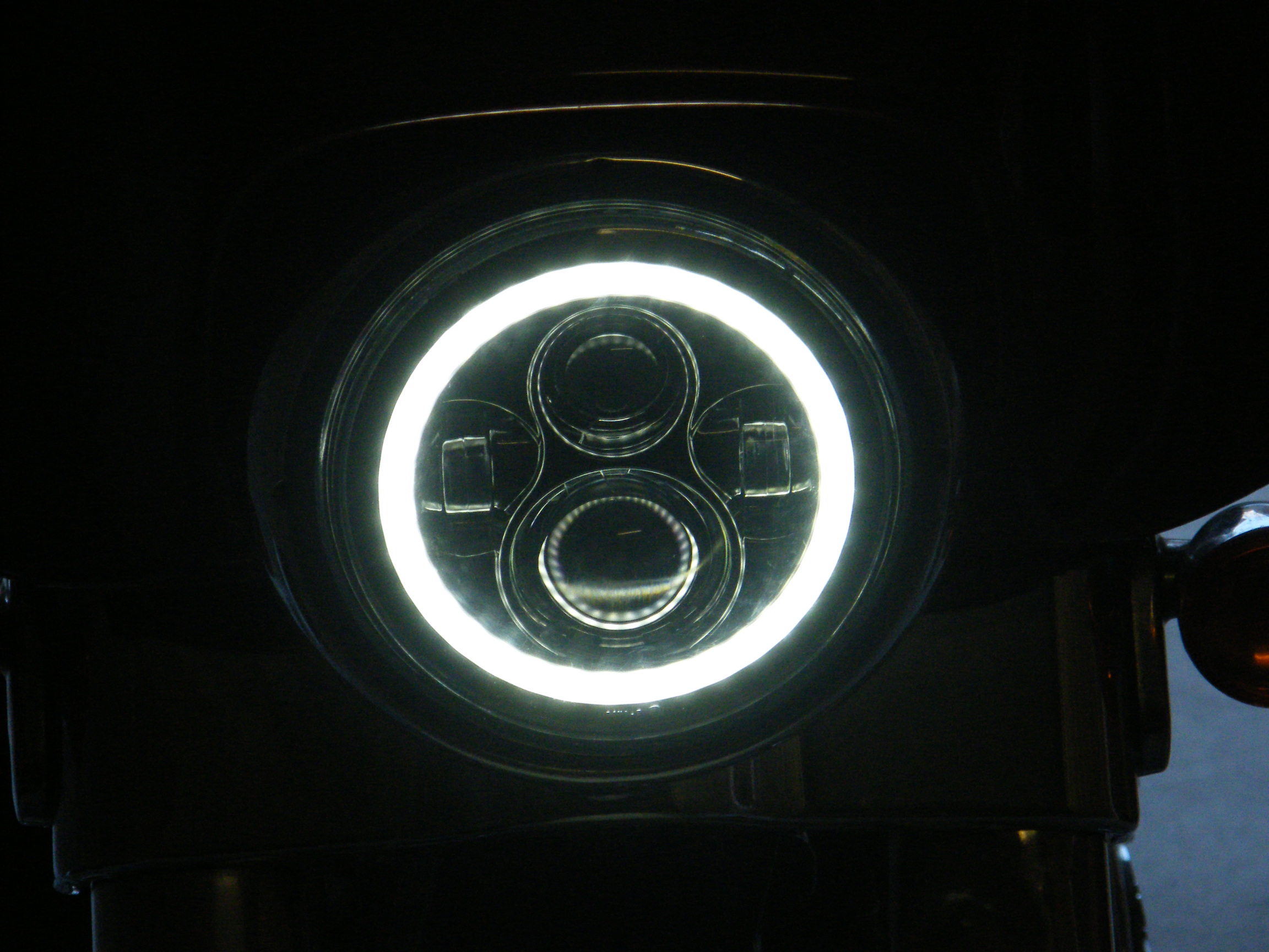

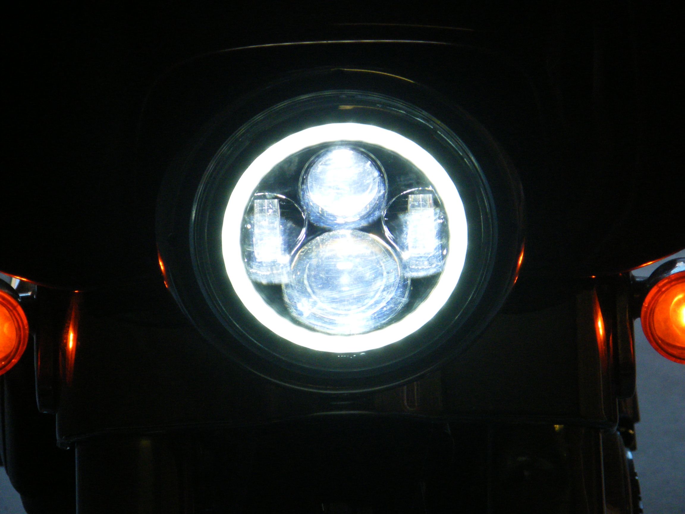

Here is how it looks.
DSCF0132.thumb.JPG.a6eb4623938bdc8090c8d637fc89dd2b.JPGDSCF0133.thumb.JPG.d3c225861dbfedbf53515fe2ee6efc2b.JPGDSCF0134.thumb.JPG.e3604924858c765ab7b3e3ea99019364.JPG

I think the headlight looks ace, I've used those type of waterproof connectors on lots of bikes, they're very good if a little fiddly to work with.

If you have the right tools it is straight forward, don't get the ratchet style crimpers, the best are the Engineer Precision made in Japan but there are other decent ones as well. I generally use the Engineer Precision crimper for the wire terminals then a generic type for the larger sleeve crimp.
