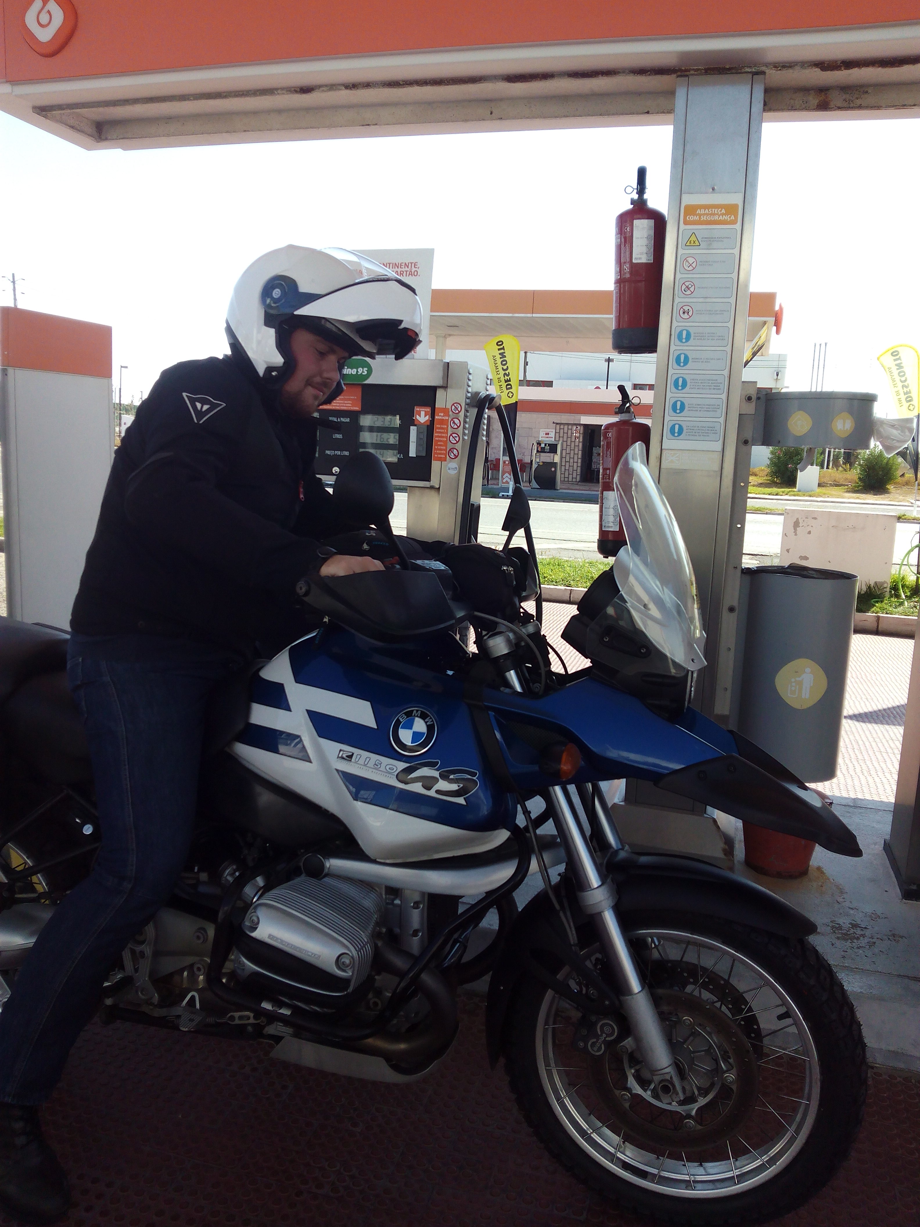

Fuel up and go, and go have a drink in the Algarve.

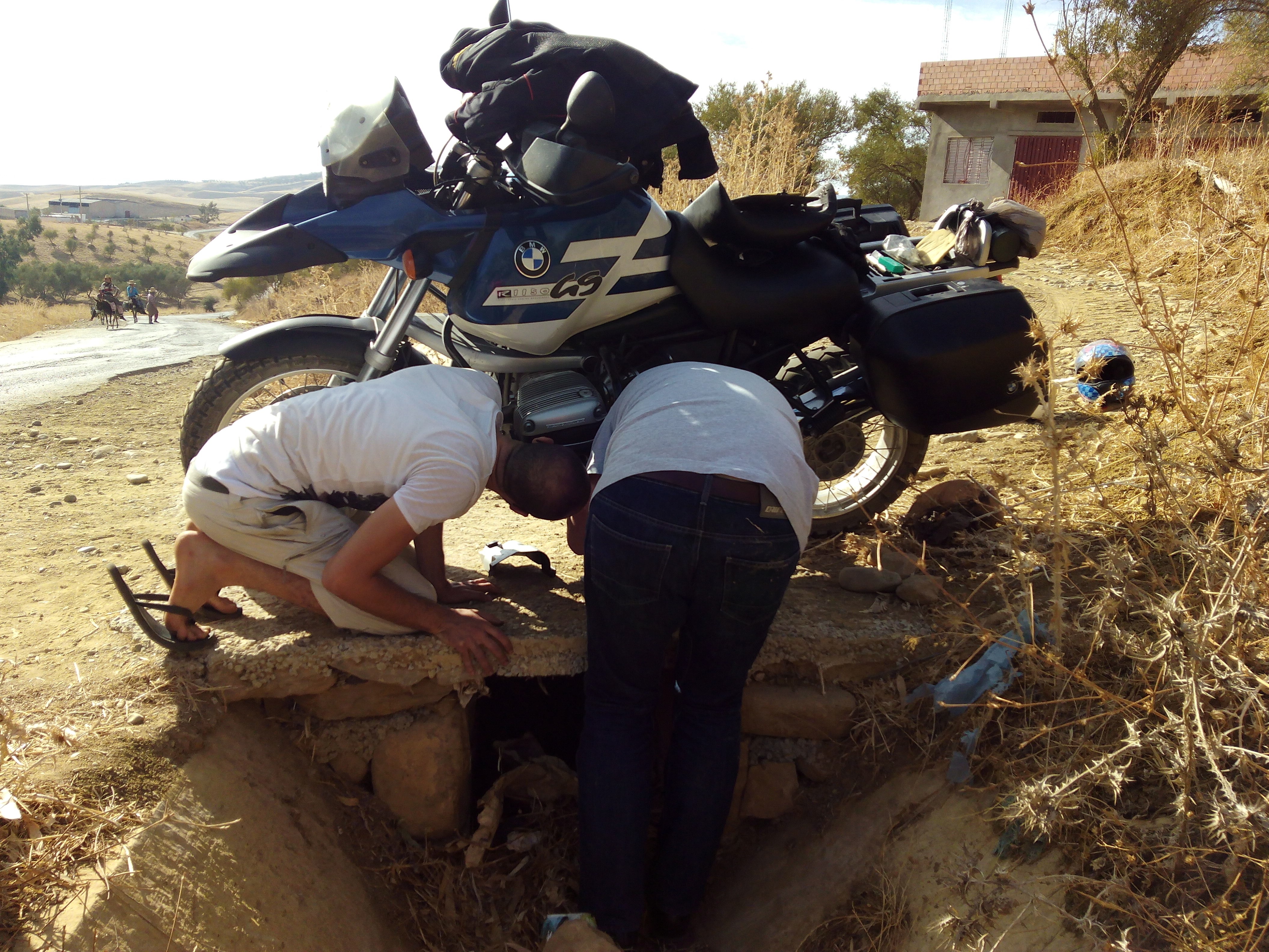

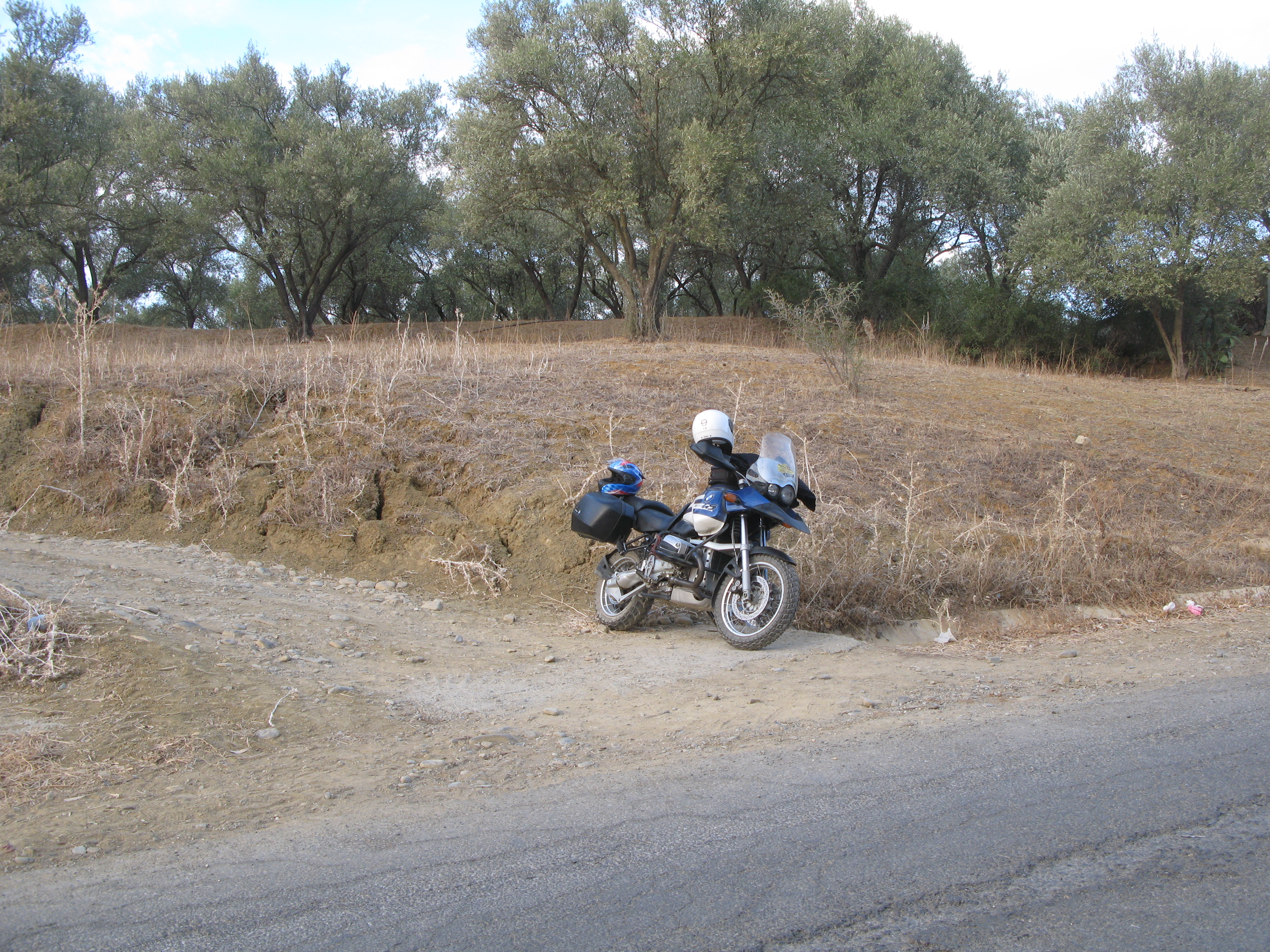

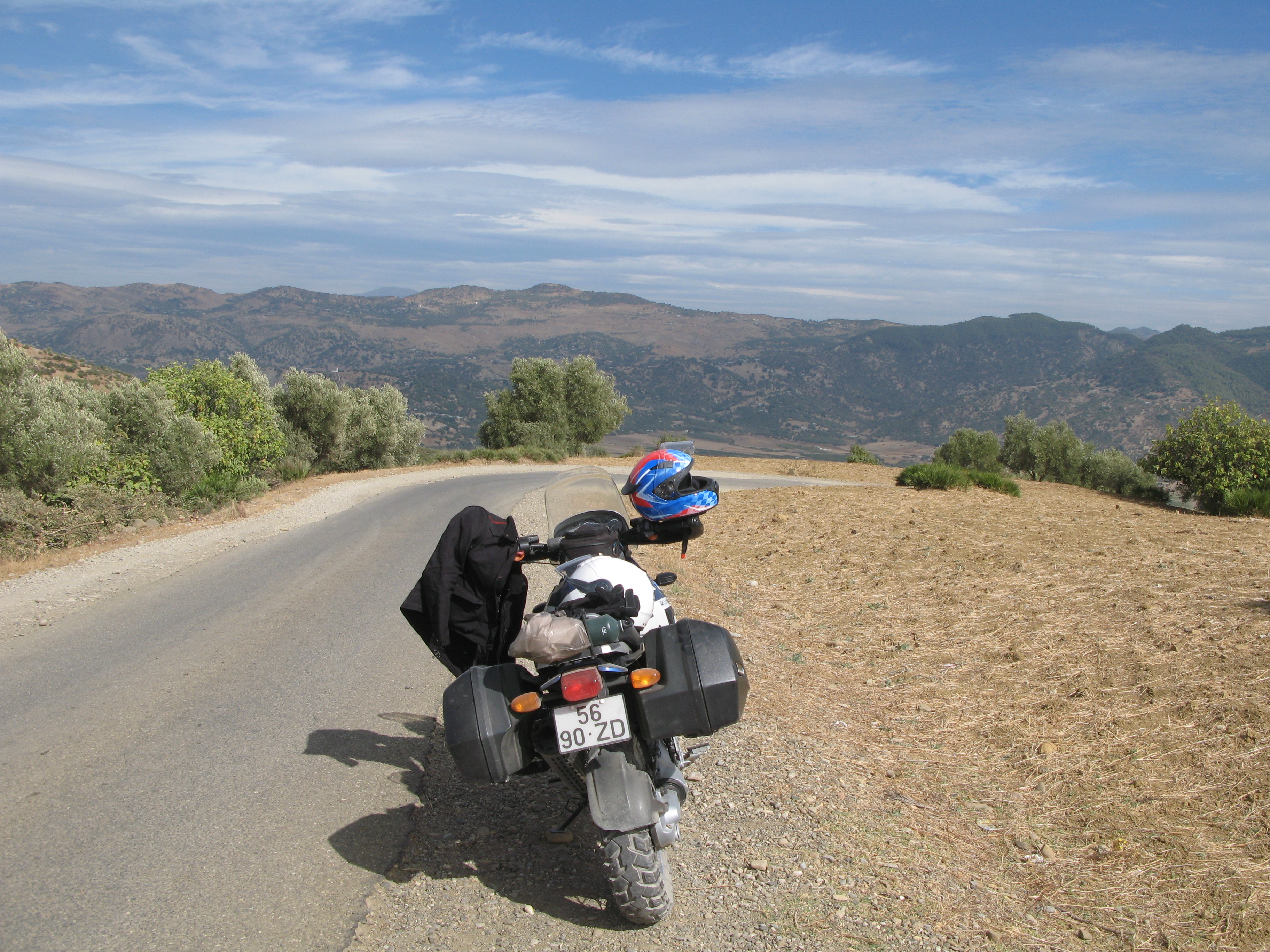

Not long after lunchtime, we're happily riding along and as we go though a very slight bump the engine simply dies. It makes no fuss, like if I just switch the ignition off.
We come to a stop and I start taking the seat off :
First, mess with the fuses, it does nothing.
Then, change fuses around, it does nothing.
Change relays around, it does nothing.
Look at the sidestand switch, it looks ok but I bypass it anyway. It does nothing.
So I call my friendly mechanic, he's an expert bmw dude and he tells me that if indeed all that I checked is ok then it could be the fuel pump.

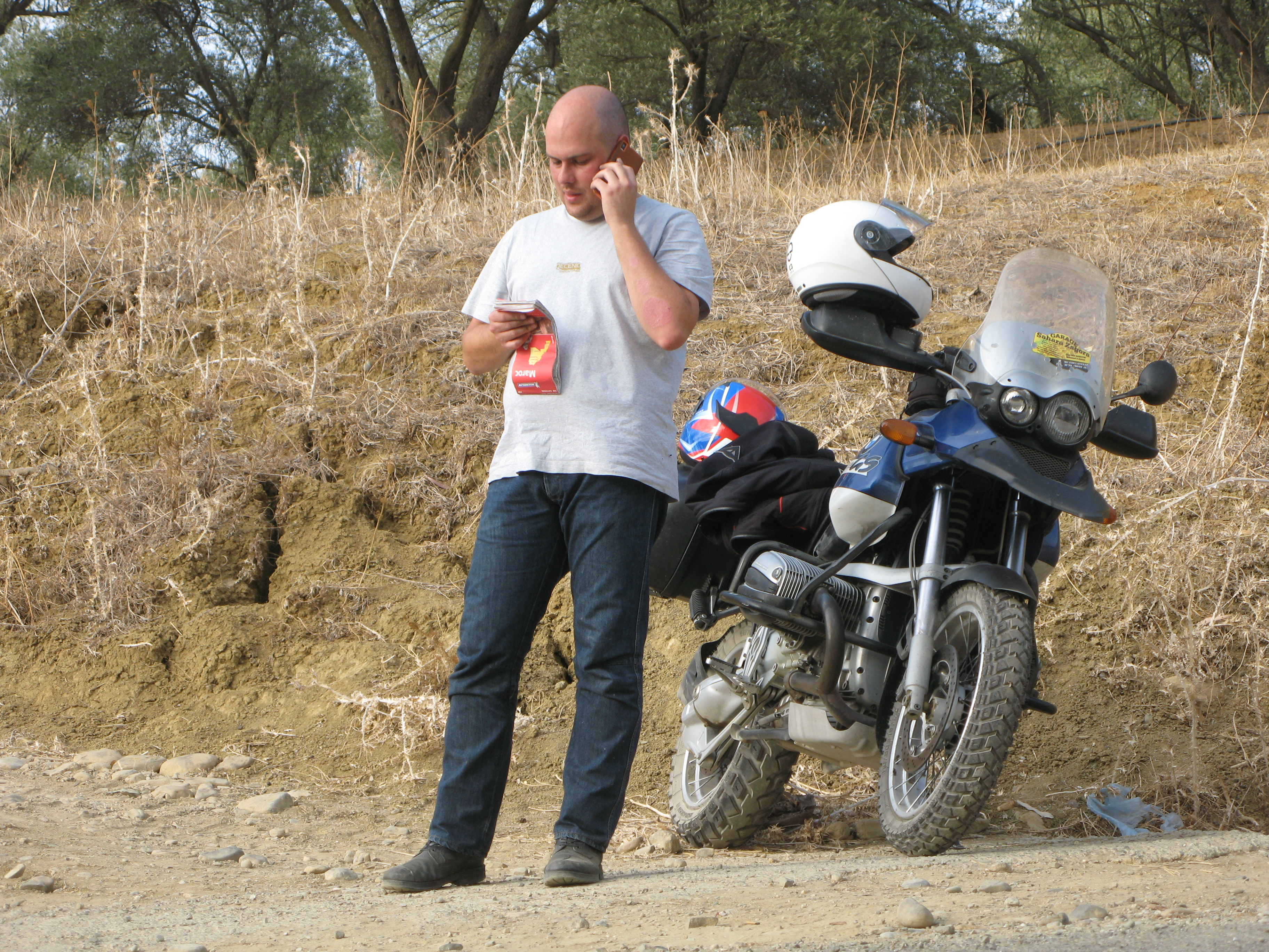

In the meantime, we are handling this with coolness, we've got a battery pack for the phone, it's early and light out, it's an adventure. Couple of people stop by and offer assistance, this is good because it means we're not exactly in the middle of nowhere. Getting back to it...
This is Aboukassim, and he's a star:
IMG_20151003_162633.thumb.jpg.00d81d5267b4064e1f4e958f348f6744.jpgIMG_0257.thumb.JPG.760c4be89103fe472c9c829523a5b86f.JPG
Aboukassim lives in Casablanca and is here visiting his family for a celebration. He rode a Yamaha R6 at the time, and this is him showing us films of him blasting past traffic on his R6 in Casablanca?:dancebanana:
He doesn't know how to help, and we appreciate his effort, he tells us he'll be back in a while...

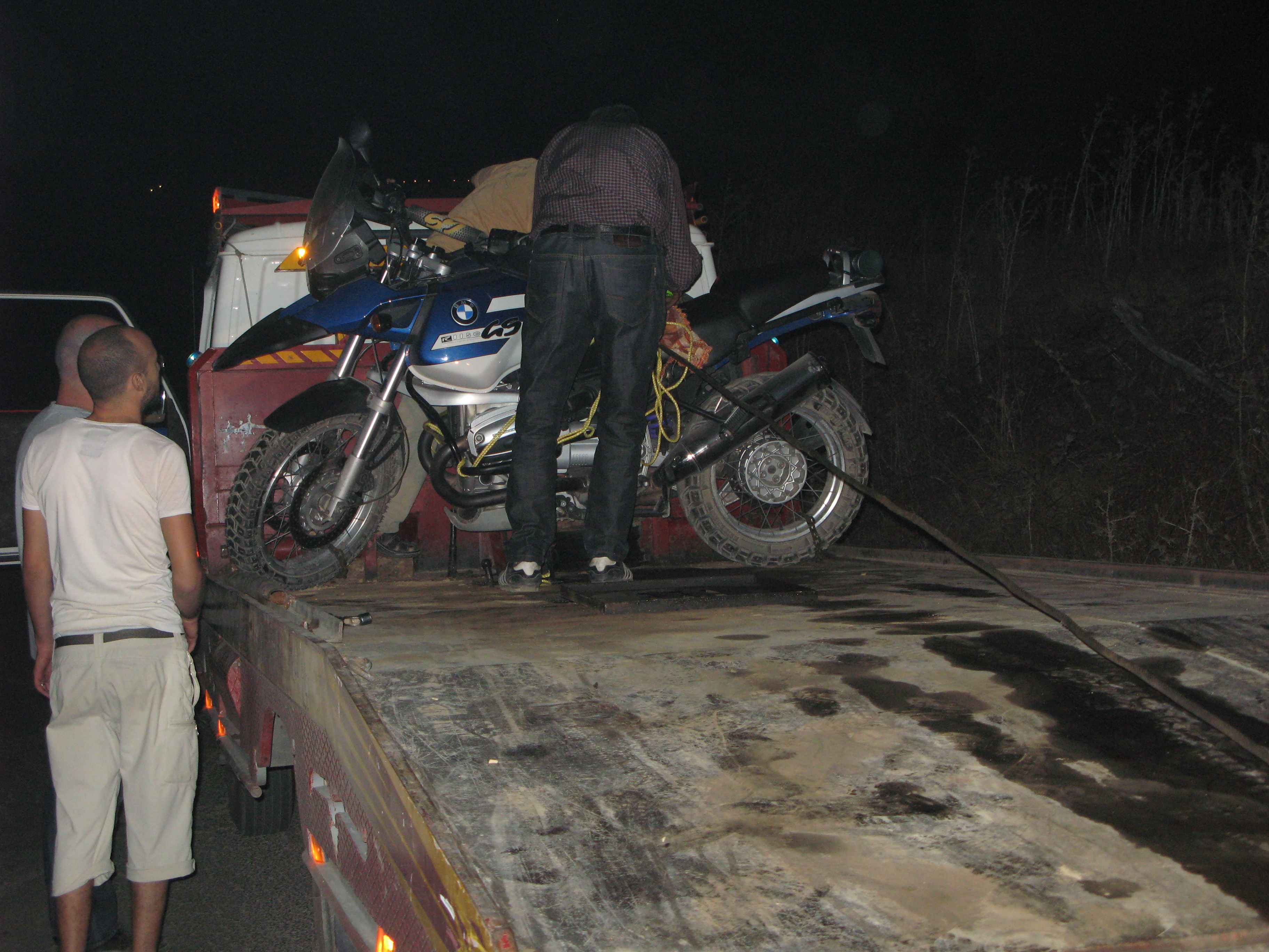

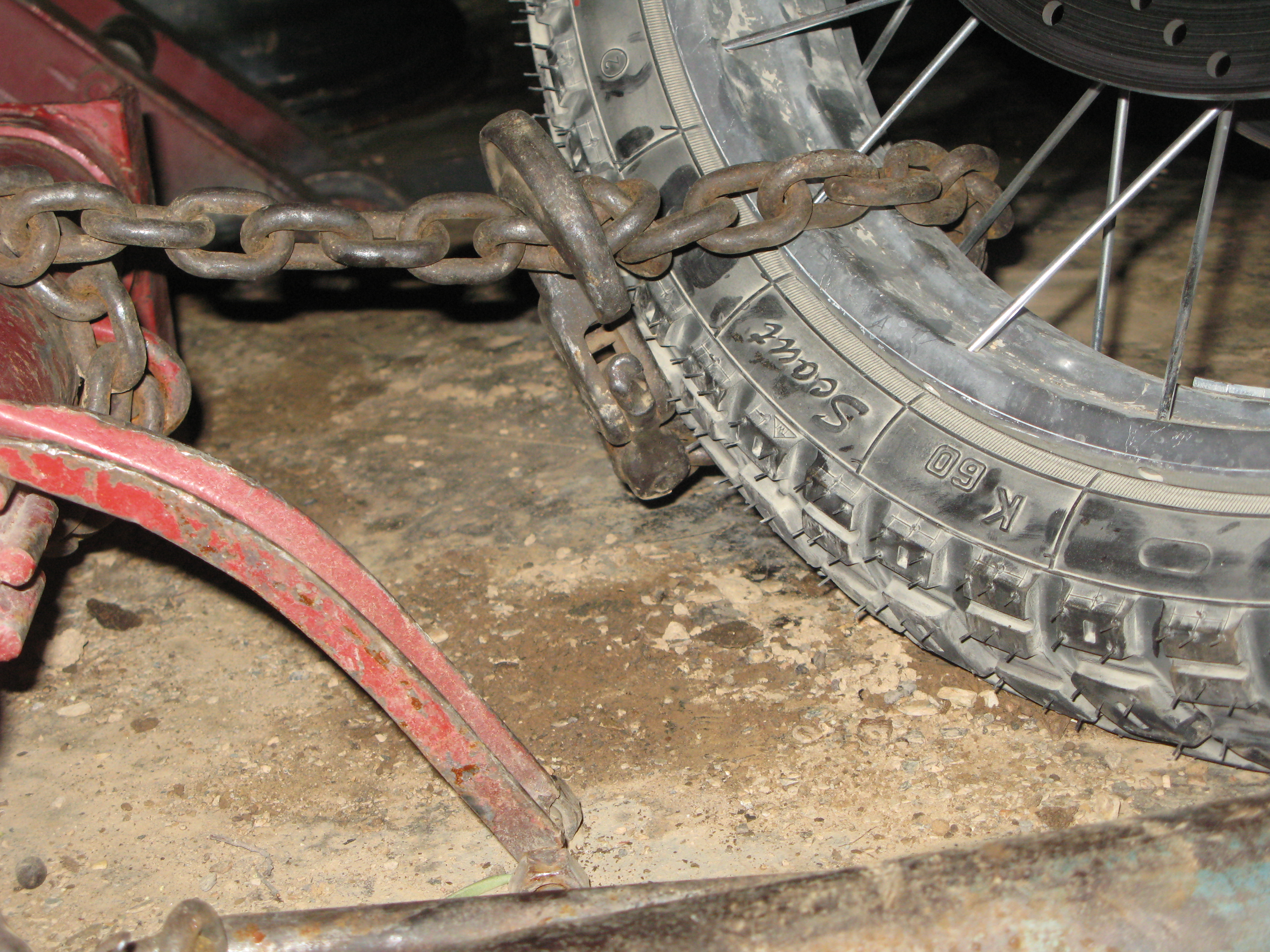

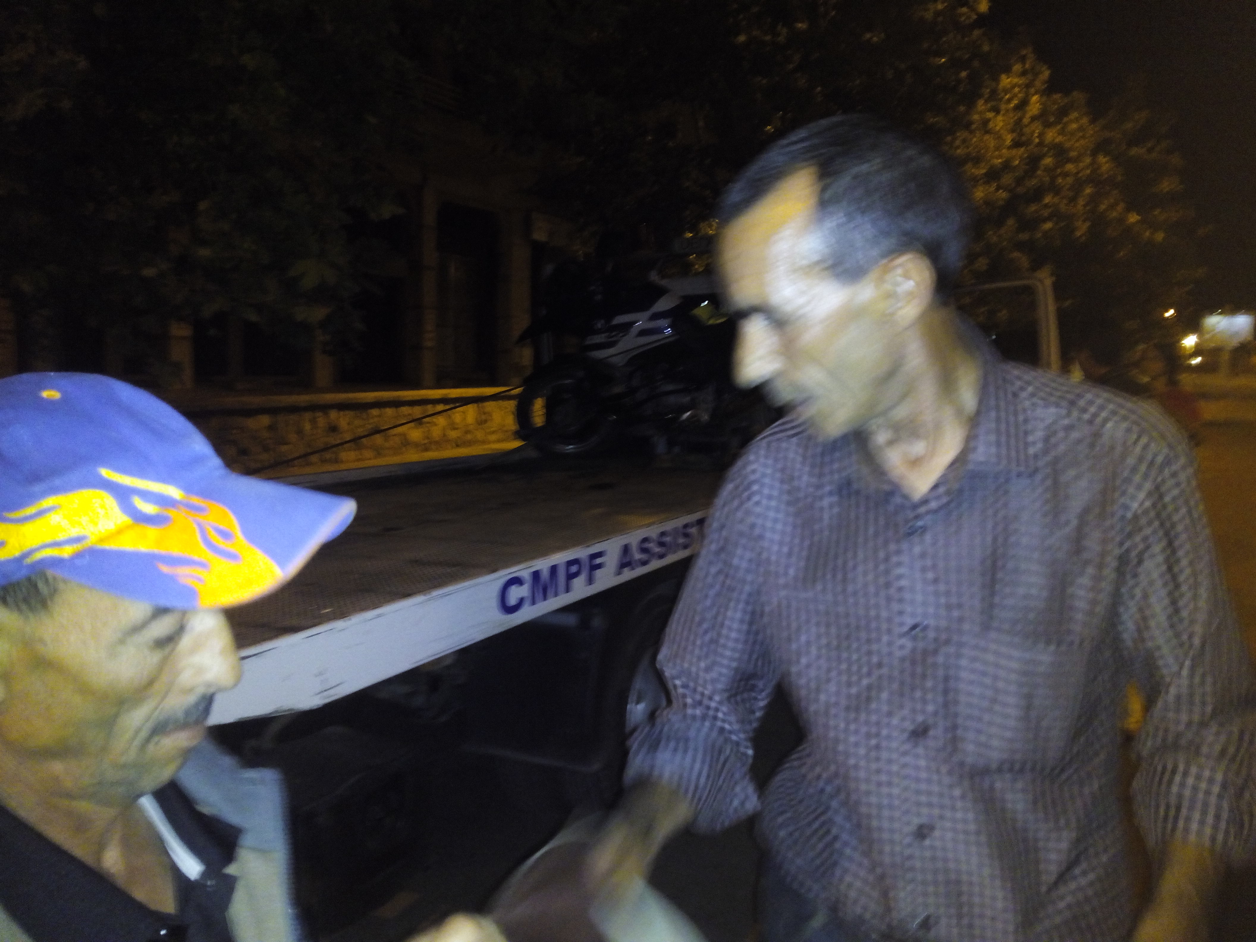

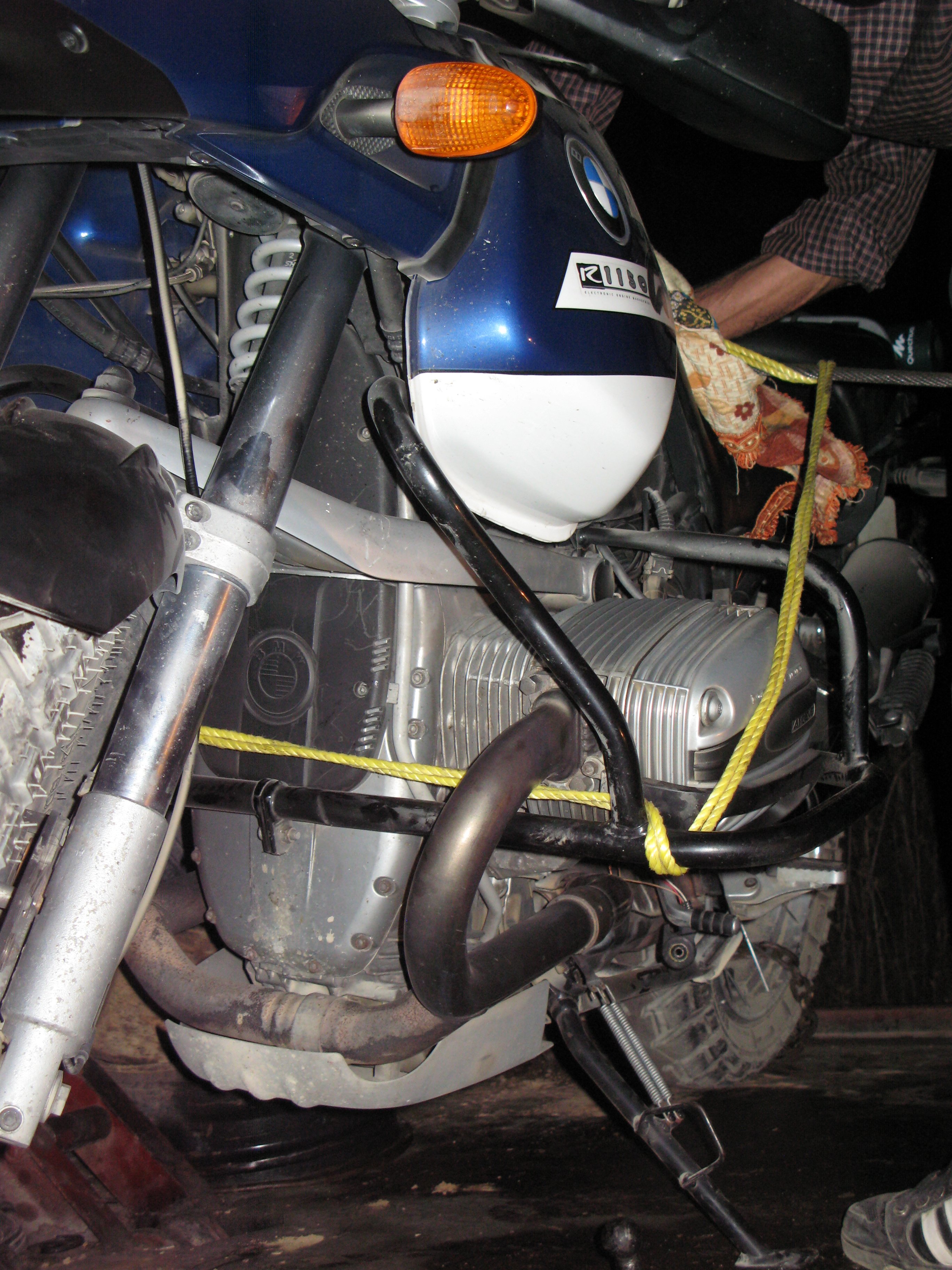

And after a lot of missed comunication we load the bike, onto a tilted metal sheet covered in oil, and used to metal cable on the tow hook to old it down, there was nothing else to use.
The yellow rope is just there to make them feel better, in case the engine protection bars fall off :classic_laugh:
Complete with "D" sticker from it's origin
We had the taxi ride from hell, the taxi itself wasn't too bad. There were to shocks left so it was pretty smooth, but we must have driven in first and second gear for two or three hours, I kept picturing the bike falling off so told them to stay behind. On second thought that wasn't very clever.

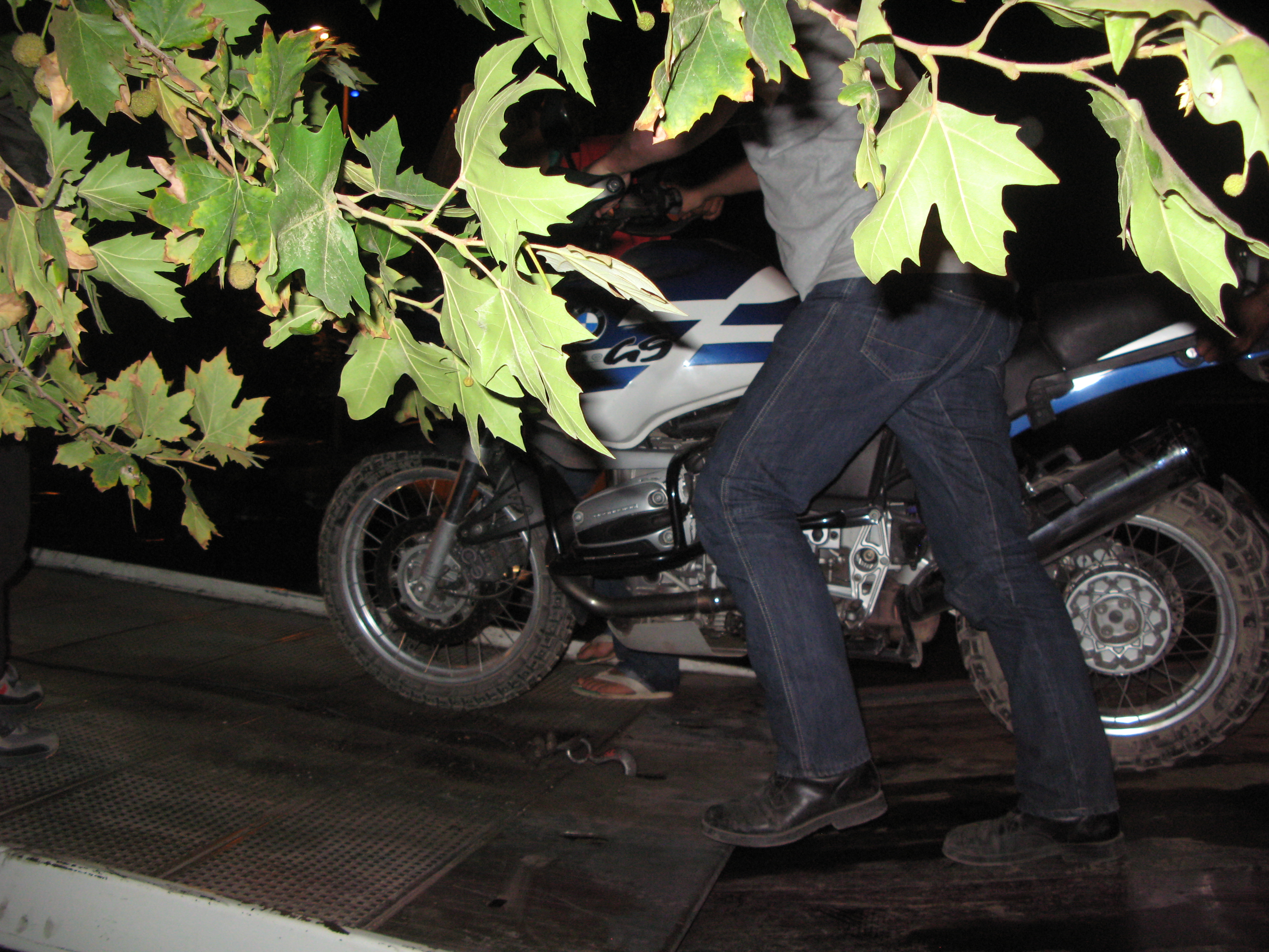

Eventually we made it to Fez, and all was going ok up until they decide to load the bike onto a different truck, which I do.
They then proceed to ask me for the bike papers, which I deny.
Thing is, I didn't really care about them stealing the bike because if they stole it Allianz would have to pay for it dearly. What I couldn't do was let go of the papers until my passport had been "disconnected" from the bike. To prevent illegal imports I can't get into the country with a vehicle and then leave without, I would be in burocratic deep shit.
A long argument ensued, between the tow truck guy, the second tow truck guy, the recovery company employee, the fixer, and myself. This carried on for a while with one of them trying to act tough, until Maria shouted at him. He clearly wasn't used to being shouted by a woman, so he was a little out of his depth.
Eventually we left the bike to be taken to the depot, and went to the hotel, not to get there until we searched the whole of Fez for it, driven by a taxi driver that didn't understand roundabout or traffic lights. It would have been great fun had we been in the correct state of mind.

I went to help unload it from the trailer to my mechanic's shop, and I was quite angry to see that what was wrong with it was that the fuel pump plug hadn't been completely plugged, meaning the clicky thing that hold the plug didn't click, this had been fitted a year previous by the dealership that fixed it upon the last return from Morocco, and it just took a year to loosen enough to not make contact, but not enough that it fell off either. I was so annoyed at that.
We tested the electrical wire that I stole off the tractor to make it run straight from the battery, and it was broken inside, making no contact even though it looked fine.
