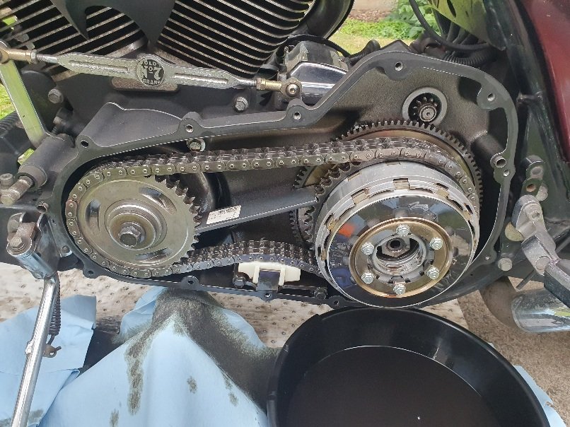

Buckster Posted August 20, 2024 Author Share Posted August 20, 2024 So here we go. The original setup. Despite what Marcel le manchild says, 60k is good going for the original compensator on this model year, the compensator is the cog on the left. Pre 2006 compensators last a lot longer as do post 2013although the standard self racheting primary chain adjuster can be a problem, as you may see i fitted a Hayden M6 tensioner many moons ago which may be why mine has lasted so well. On inspection there was not a lot of wear on the compensator except for the peaks but the belville spring basket was pretty well shot, this is why it was noisy and i was getting vibration. 6 Link to comment Share on other sites More sharing options...

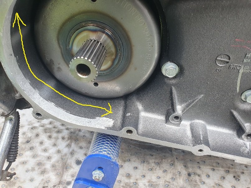

Buckster Posted August 20, 2024 Author Share Posted August 20, 2024 All new compensators require a new stator as the basket for the belville spring is welded to the old one. This being the weakness all newer types use a different system. I went for a Dark Horse motorsprocket as they are regarded as the best plus they will survive performance upgrades which I will do in the future. The inner primary case has a cast lip on the inside which prevents removal of the stator without removing the inner primary, I decided to grind this lip off as many others have done as it makes ongoing servicing of the alternator a lot easier. Here we are with the original stator removed. With the new one fitted. 5 Link to comment Share on other sites More sharing options...

boboneleg Posted August 20, 2024 Share Posted August 20, 2024 Is this where you ground the lip out ? Â 1 Link to comment Share on other sites More sharing options...

Buckster Posted August 20, 2024 Author Share Posted August 20, 2024 2 hours ago, boboneleg said: Is this where you ground the lip out ? Â How did you guess? 1 2 Link to comment Share on other sites More sharing options...

boboneleg Posted August 21, 2024 Share Posted August 21, 2024 12 hours ago, Buckster said: How did you guess? What was the point in the lip in the begining ? 2 Link to comment Share on other sites More sharing options...
Buckster Posted August 21, 2024 Author Share Posted August 21, 2024 8 minutes ago, boboneleg said: What was the point in the lip in the begining ? It just seems to be a casting lip, earlier bikes don’t have it. 3 Link to comment Share on other sites More sharing options...
