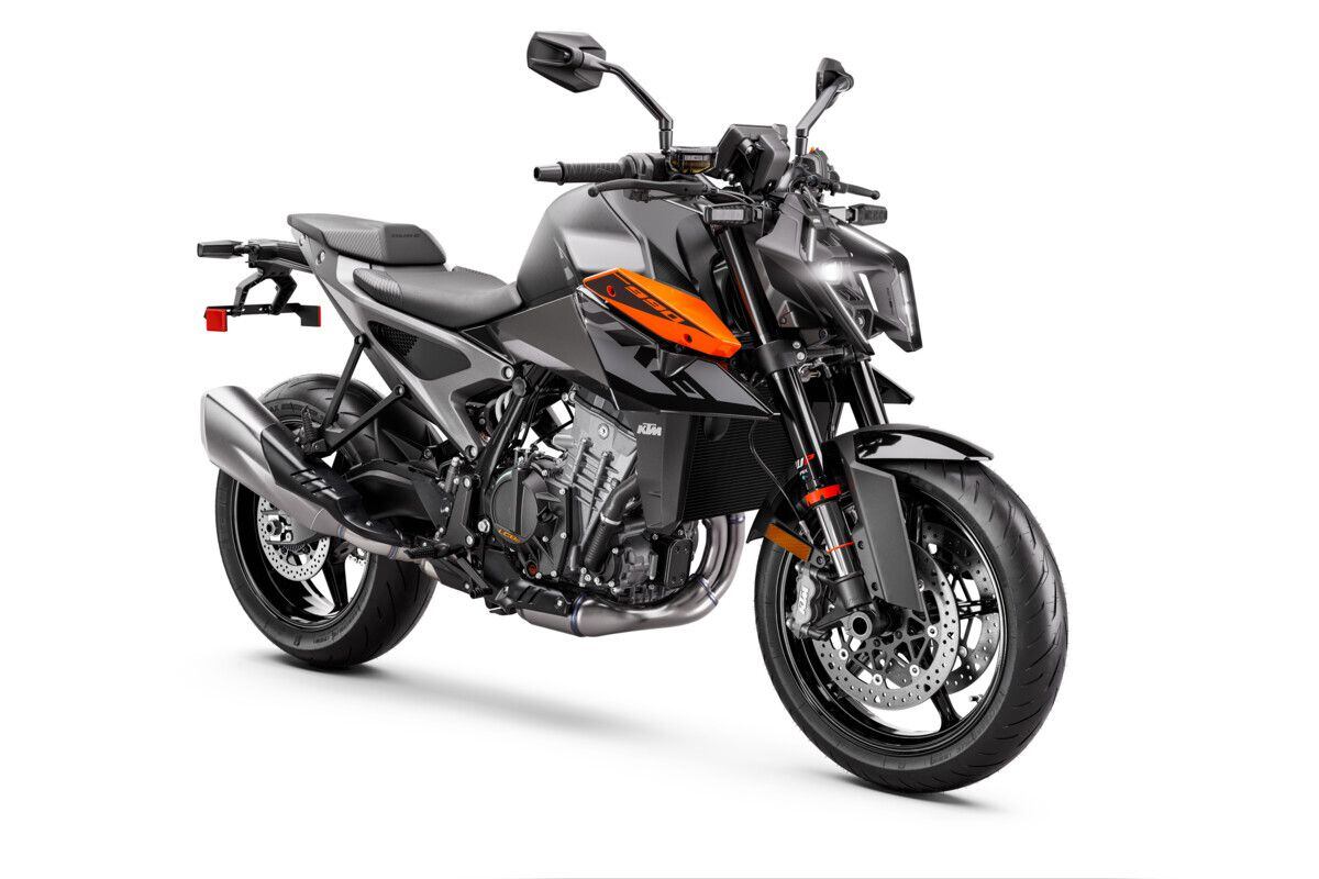

Bigger is better, at least according to KTM, who announced a larger-displacement 990 Duke for 2024. Built on the same prerequisites as the 790 Duke and 890 Dukes that came before it, the 990 promises lightweight, scalpel-like performance through numerous changes, including a new chassis, swingarm, and electronic technology. The bike also gets a new look and what KTM describes as “larger proportions.”
“Sharper” has always been a keyword in the launch of new Duke models and that continues here, KTM saying this latest model is the “lightest, sharpest, most performance-focused middleweight naked ever produced at KTM’s main plant.” That’s saying a lot considering the performance of the 890 Duke GP that came before it. But how do you get to this point?

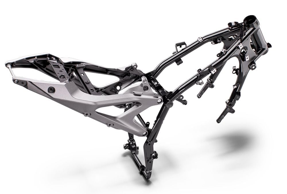

Handling has always been a strong point for Duke models, but KTM looks to take another step with the 990 Duke by redesigning the steel tube frame, which is stiffer than in years past, for more feedback. More specifically, there’s an 8 percent increase in longitudinal stiffness and 5 percent increase in torsional stiffness.
For even more torsional stiffness and, in turn, increased stability, the swingarm is mounted inside the swingarm pivot area. A forged pivot bolt is said to offer similar benefits, on a smaller scale.

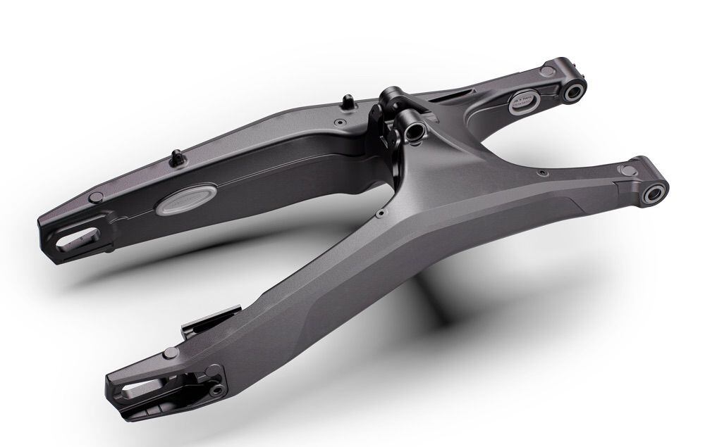

While increased stiffness is a big talking point when it comes to the frame, swingarm stiffness is actually reduced by 35 percent, for improved bump absorption and traction. Said swingarm is 3.3 pounds lighter too, thanks in part to a new gravity die-cast production method.
The 990 Duke’s frame is revised for increased rigidity.
The 990 Duke’s frame is revised for increased rigidity. (KTM/)

A new swingarm is gravity die-cast (versus pressure die-cast), resulting in a 3.3-pound weight savings. Stiffness is reduced for increased bump absorption.
A new swingarm is gravity die-cast (versus pressure die-cast), resulting in a 3.3-pound weight savings. Stiffness is reduced for increased bump absorption. (KTM/)

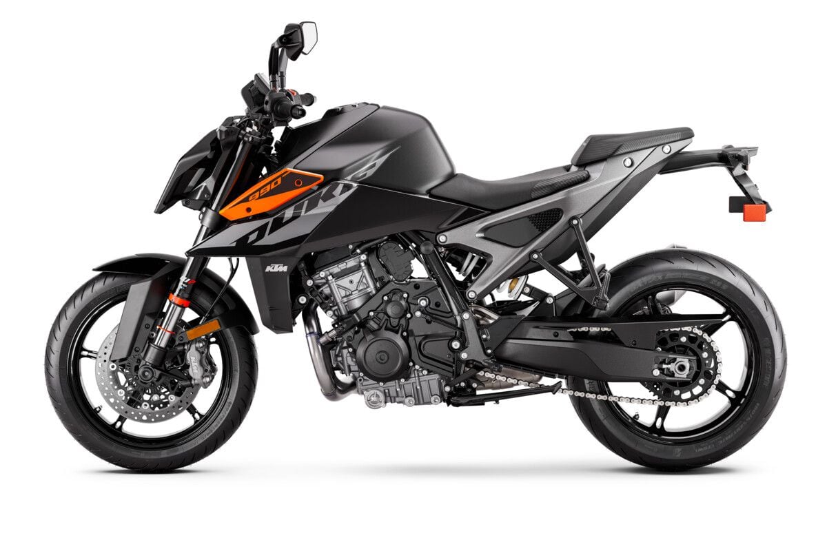

While KTM says the 990 Duke has “larger proportions,” it doesn’t clarify exactly how the dimensions vary compared to the 790 Duke or 890 Duke R. What we do know is the 990 Duke has a minutely larger 3.8-gallon fuel tank with new lines that are sharp as ever. Those lines are carried through the rest of the bike, KTM very clearly sticking to its philosophy that “the sharper the lines, the better.” That design concept extends to the new and polarizing LED headlight.
The upright riding position is retained, though KTM has changed the seat shape to keep the rider from sliding forward. It has also raised the passenger seat 20mm (0.8 inch), for an unimpeded view.
Adjustability is limited to handlebar position; the one-piece bar can be moved to one of four positions by adjusting the position and rotation of the bar risers on the triple clamp.
KTM doesn’t shy away from sharp lines, and that continues to be the case with the new 990 Duke.
KTM doesn’t shy away from sharp lines, and that continues to be the case with the new 990 Duke. (KTM/)
