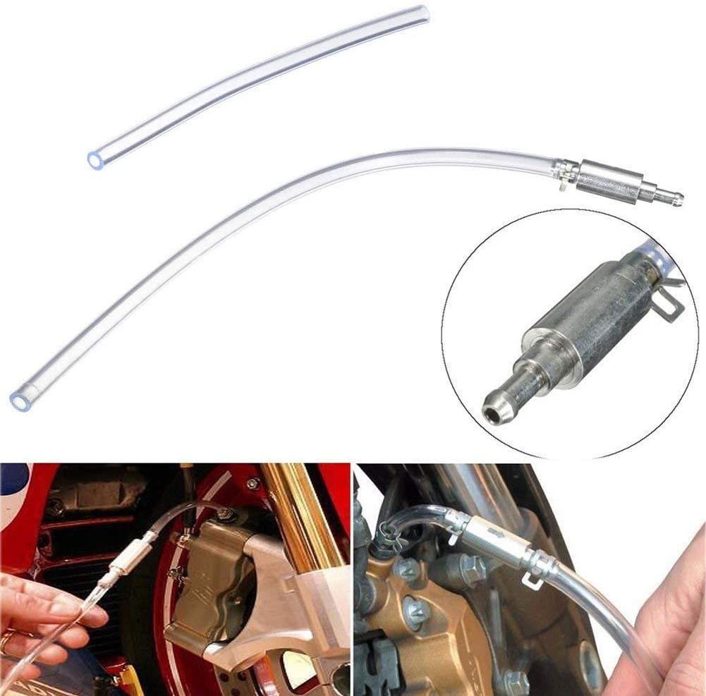

Bought one of these on Amazon, cost me £7.99 but they are £8.99 now.
I have tried most brake bleed methods over the years and always end up returning to a simple clear pipe method. This though is absolutely bang on, the none return valve makes doing the job on my own just that little easier. By far the best thing I have bought for brakes. I replaced the brake fluid on the bike both front and rear in about 20 minutes. The beauty of it is that you don’t need to constantly open and close the bleed nipple while pumping the fluid through. You can just keep topping off the reservoir and pumping the fluid though until you are done then go close the bleed nipple and you are all done. Highly recommended.
