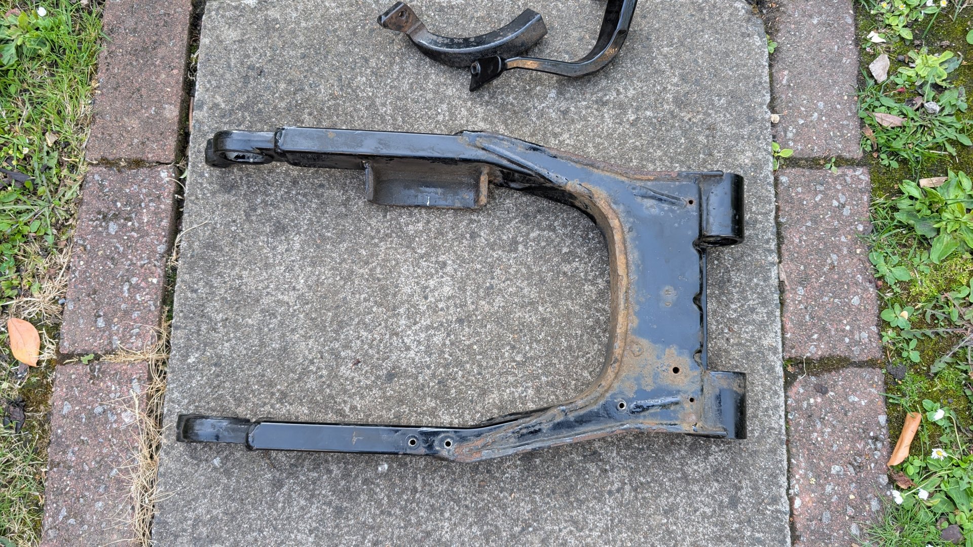

Buckster Posted June 21 Author Share Posted June 21 Swing arm is out, pain in the ass it was, it has a bit of rust but it is in great shape for nearly 60k miles, the powder coaters will just need to sand blast it and paint it. It is bloody heavy. 3 Link to comment Share on other sites More sharing options...

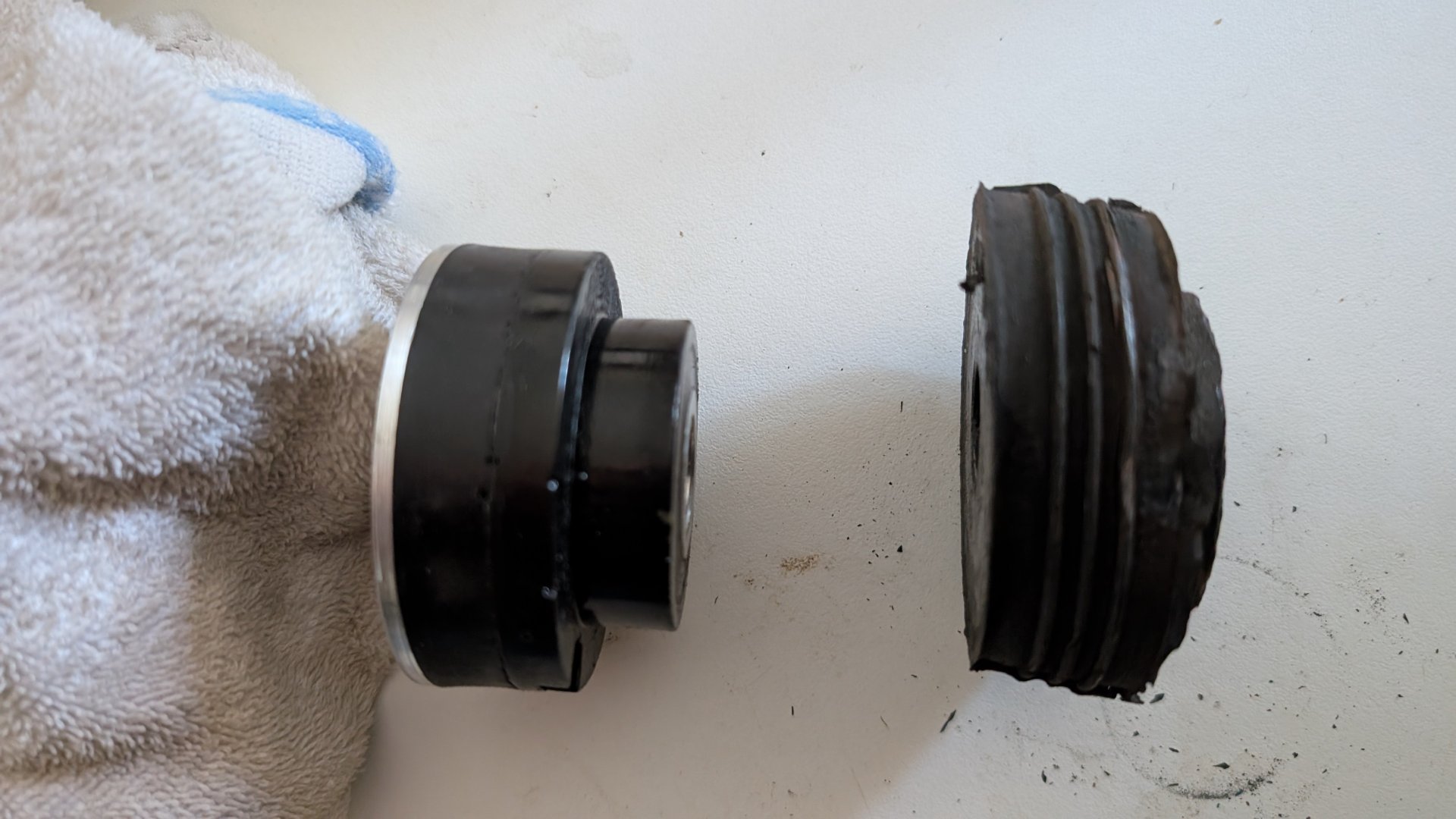

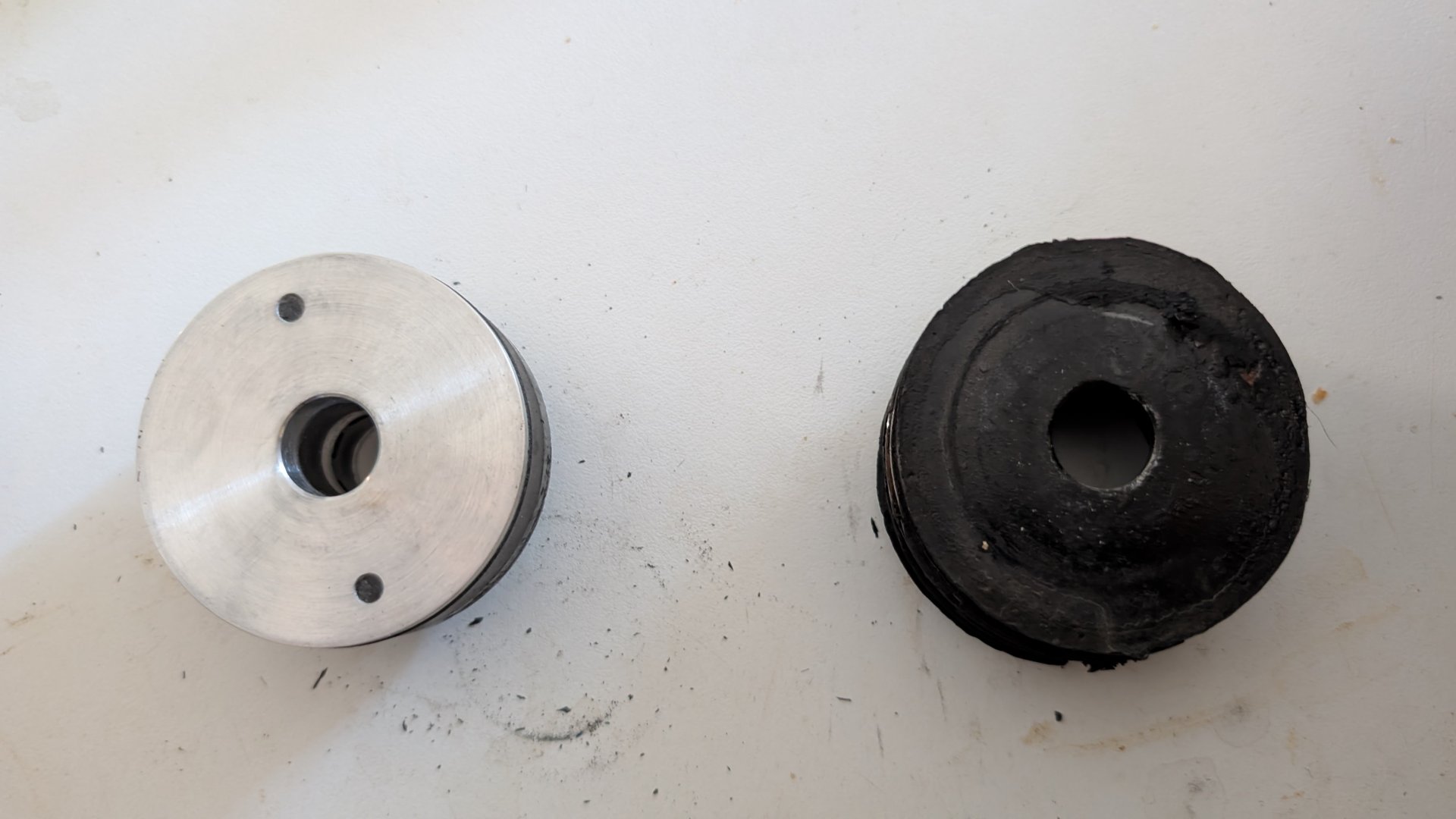

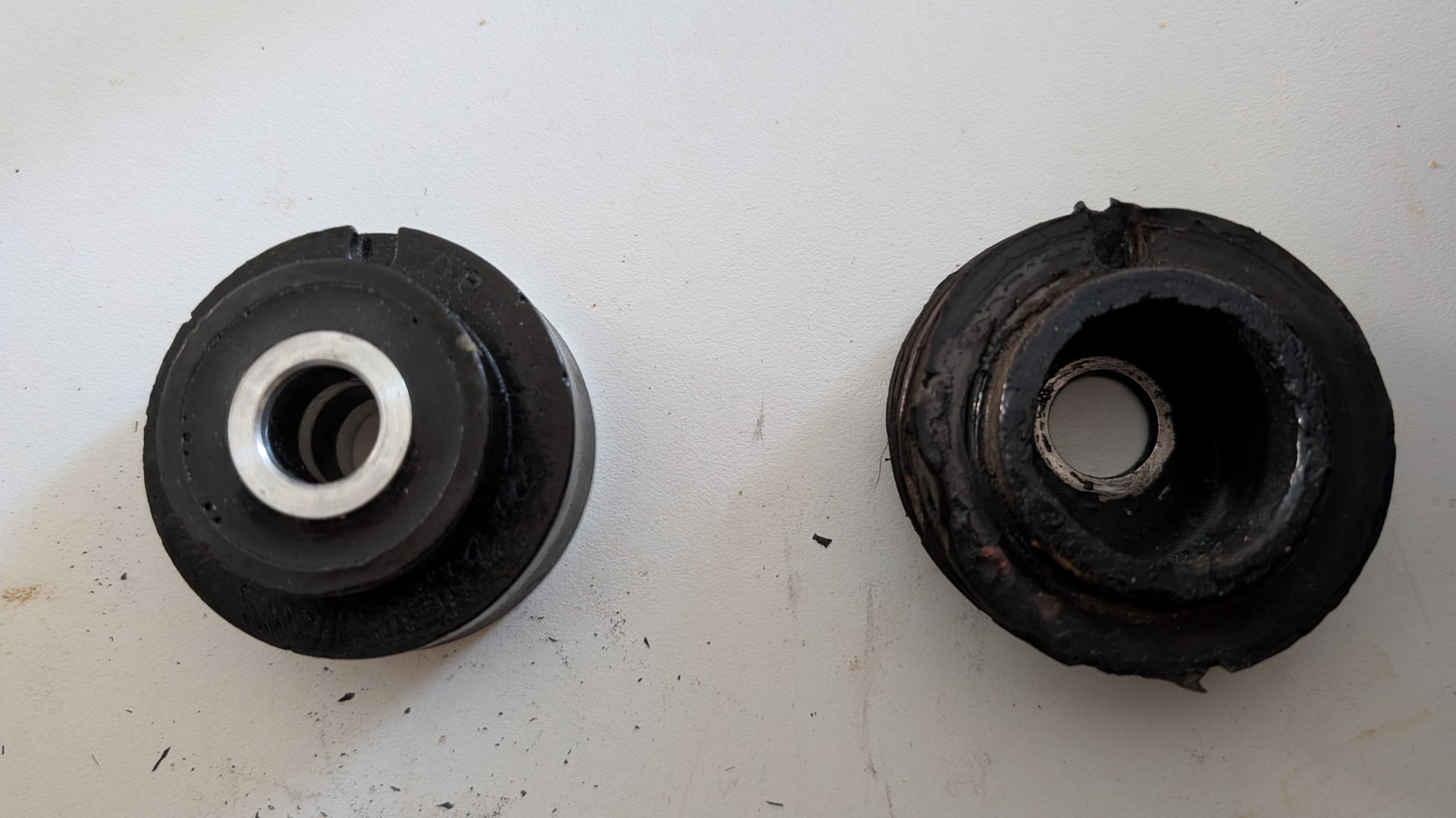

Buckster Posted June 22 Author Share Posted June 22 In between rain showers I got the bearings and bushes out of the swing arm. They were in pretty good shape but I have new ones including much higher quality bearings, there is definitely signs of the isolators collapsing, the new setup is significantly different. There are various videos of aligning the motor while fitting the rear axle but having examined it it can only fit one way, there is no left and right alignment other than allowing the rear of the motor to slight shift depending on the front upper and lower alignment mounts, once it is bolted up it will assume a neutral position. 2 Link to comment Share on other sites More sharing options...
Buckster Posted June 22 Author Share Posted June 22 Swing arm is pretty good but powder coating will mean it will not deteriorate. 1 Link to comment Share on other sites More sharing options...
Buckster Posted June 22 Author Share Posted June 22 Old design Vs new isolators. 2 Link to comment Share on other sites More sharing options...
