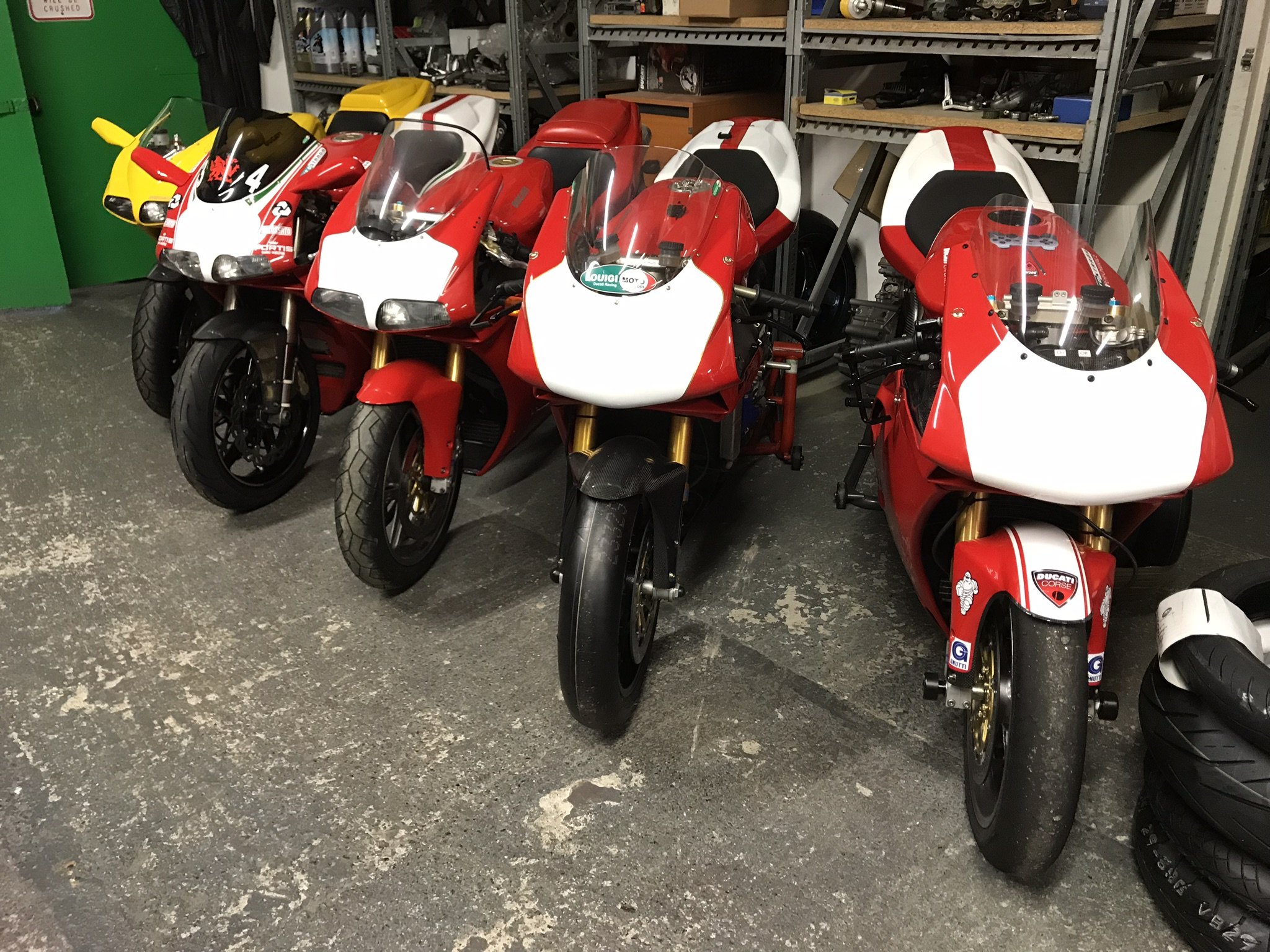

How do you like them, mechanically, Bob?
To me, they look great but aren't the kind of thing I'd want to ride except to look cool going for a coffee.
I can't even get into the position to ride one Pedro, if I have to take one for a MOT it goes in the van ?
Beautiful bikes to look at though, we specialise in the 748/916/996/998 models.
