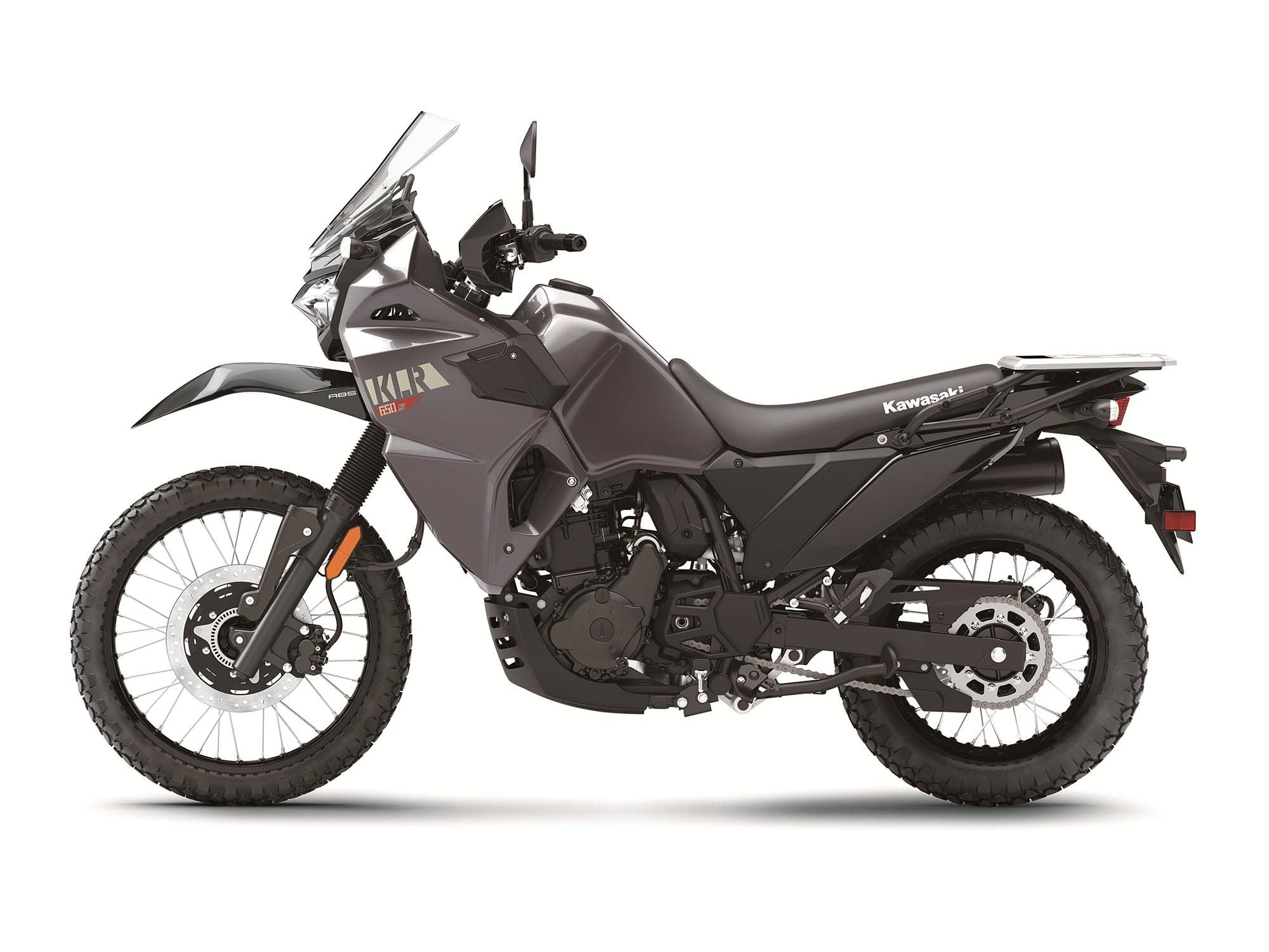

The new KLR650 S is available in two colors (Storm Gray shown here) as well as with- or without ABS.
The new KLR650 S is available in two colors (Storm Gray shown here) as well as with- or without ABS. (Kawasaki/)
All 2023 KLR650 models including the S share the same engine and basic chassis components. The huge liquid-cooled 652cc four-valve DOHC single is equipped with dual balancing shafts, much needed with a bore and stroke of 100mm by 83mm. The compression ratio is comparatively mild at 9.8:1, and the fuel-injection system uses a 40mm throttle body, relatively small for an engine of this size and chosen to help smooth out throttle response and flatten the torque curve. An oxygen sensor in the exhaust system transfers information to the injection ECU.
Except for the S model’s suspension settings, the basic Kawasaki KLR650 chassis platform remains unchanged: the same semi-double-cradle frame, braking system, wheels, and tires. The front brake uses a single 300mm rotor and a two-piston caliper, with ABS available as an option. The KLR650 S rolls on a 21-inch front wheel shod with 90/90-21 semi-knobby tire and a 17-inch rear (130/80-17). Among the options are heated grips and a set of additional LED front lights; to help power them the electrical system puts out 26 amps. The generous fairing offers adequate comfort for long hauls, while electronics here are limited to a large TFT instrumentation display.
