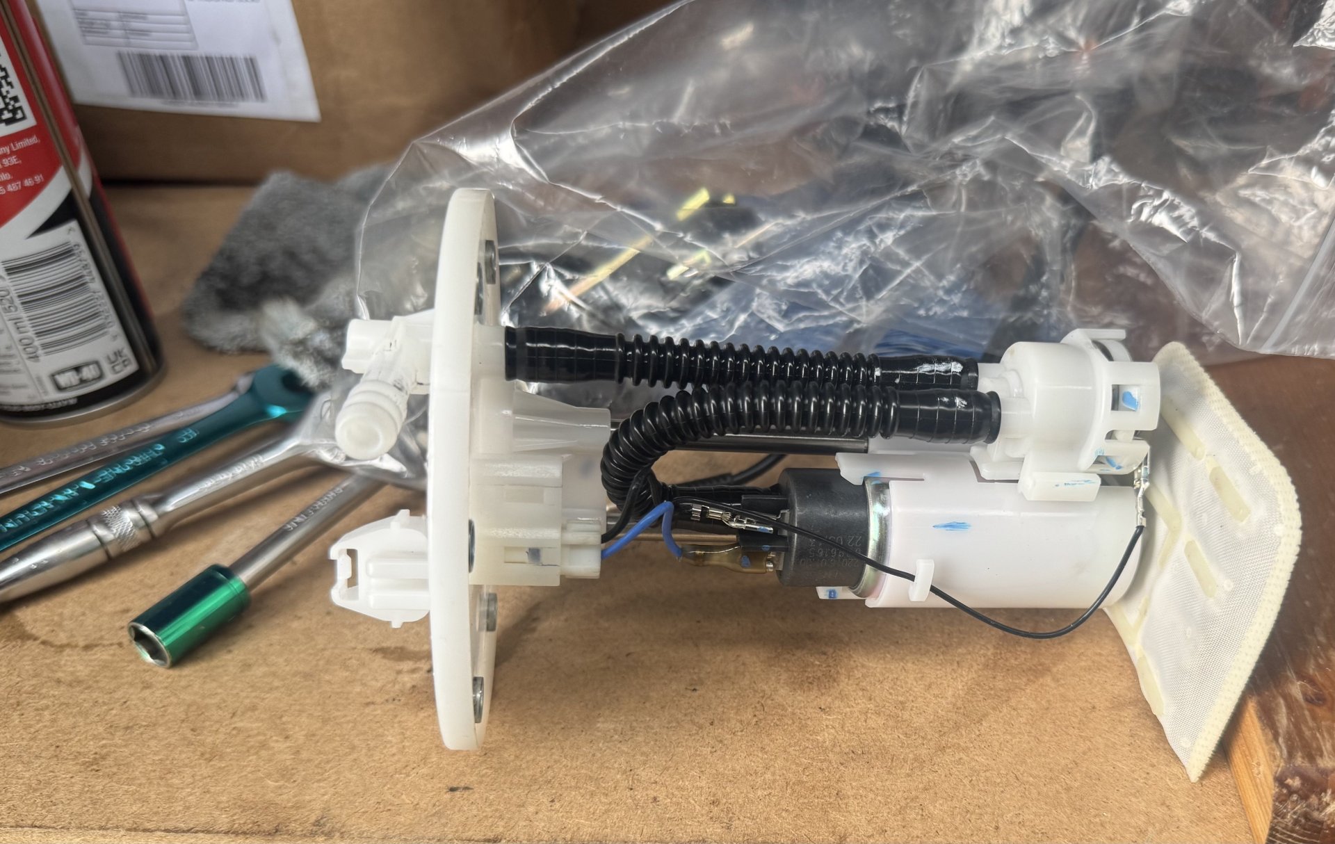

Vamana Gupta Posted July 20 Share Posted July 20 22 minutes ago, Saul said: Fuel sock not wank sock It's looks like a fuel pump right out of a Honda crv..lol. Anyway you can fit a pressure gauge in there Saul... Most of the time...and I say most of the time , not always, bad pump will start failing underload..not at idle. 1 Link to comment Share on other sites More sharing options...
Saul Posted July 20 Author Share Posted July 20 Just now, Marcel said: It's looks like a fuel pump right out of a Honda crv..lol. Anyway you can fit a pressure gauge in there Saul... Most of the time...and I say most of the time , not always, bad pump will start failing underload..not at idle. Totally agree with that , I am going to explore the extra drag from the variator/drive belt first idea as that spins with the crank all the time. I don't have a way to check the pressure from the fuel pump but it was pretty cheap so I bought it just in case. Link to comment Share on other sites More sharing options...
Buckster Posted July 20 Share Posted July 20 50 minutes ago, Saul said: Nothing between the tank and injector the only filter is the sock on the fuel pump. That's a lot of plastic, looks like a part off an Indian. 2 Link to comment Share on other sites More sharing options...
Vamana Gupta Posted July 20 Share Posted July 20 4 minutes ago, Saul said: Totally agree with that , I am going to explore the extra drag from the variator/drive belt first idea as that spins with the crank all the time. I don't have a way to check the pressure from the fuel pump but it was pretty cheap so I bought it just in case. It could be one of those electronic gremlins to...lol...not sure how it's made , if it refuses to start , is there a way to pull the injector out wyll still having it connected to the supply line ? 1 Link to comment Share on other sites More sharing options...
Saul Posted July 20 Author Share Posted July 20 Just now, Marcel said: It could be one of those electronic gremlins to...lol...not sure how it's made , if it refuses to start , is there a way to pull the injector out wyll still having it connected to the supply line ? I did that this morning to check it. Sprays fine in a pretty good even pattern as far as i can tell. Starting is fine it just stalls at tickover once warn and off fast idle. Link to comment Share on other sites More sharing options...

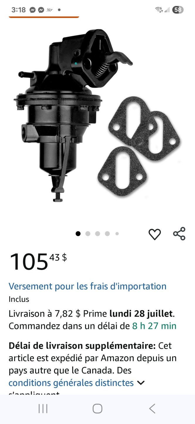

Vamana Gupta Posted July 20 Share Posted July 20 23 minutes ago, Buckster said: That's a lot of plastic, looks like a part off an Indian. All high performance engines ( except harleys) run these types of pumps...think Harley are still running the old mechanical style fuel pump like these if Im not mistaken ? Link to comment Share on other sites More sharing options...
Buckster Posted July 20 Share Posted July 20 9 minutes ago, Marcel said: All high performance engines ( except harleys) run these types of pumps...think Harley are still running the old mechanical style fuel pump like these if Im not mistaken ? Link to comment Share on other sites More sharing options...
boboneleg Posted July 20 Share Posted July 20 2 hours ago, Saul said: Nothing between the tank and injector the only filter is the sock on the fuel pump. Fuel pump looks very clean Link to comment Share on other sites More sharing options...

busabeast Posted July 20 Share Posted July 20 2 hours ago, Saul said: I did that this morning to check it. Sprays fine in a pretty good even pattern as far as i can tell. Starting is fine it just stalls at tickover once warn and off fast idle. Could be vapour lock in the fuel line when warm though being efi id expect the pump to deal with anything like that on first start up to clear itself Link to comment Share on other sites More sharing options...
