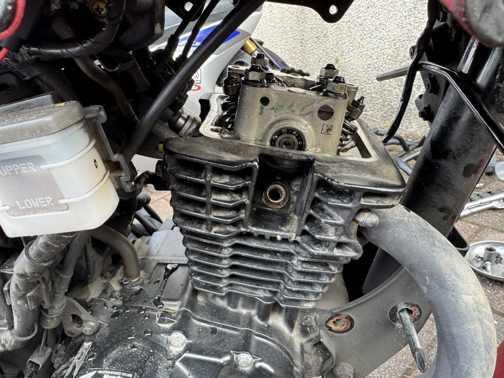

Saul Posted June 4 Share Posted June 4 Ok then brains trust can you help me identify this rattle. I serviced the bike last week and all went as it should. Sounded as sweet as it always does. Any way Shadow came home last night with a rattle after around 300 miles. I in paranoia stripped the valve cover and checked them, they are still spot on but I reset them just the same to be sure. I was worried one may have back off. Anyway after a couple of minutes when the bike comes off fast idle the rattle starts again. As far as I can tell the cam chain is under tension. The inside of the head is spotlessly clean as is the oil. I was thinking clutch but pulled the lever in makes no difference Anyway have a listen and see if any of you can make out what it is. Shadow denies any abuse and I want to believe her but Link to comment Share on other sites More sharing options...
Buckster Posted June 4 Share Posted June 4 Broken tooth on front sprocket bouncing about? Stethoscope would help you, I bought one years ago from Machine Mart, saves me a lot of time. It is often hard to pinpoint rattles on a bike as the engine noise masks where the rattles are coming from. 1 Link to comment Share on other sites More sharing options...

boboneleg Posted June 4 Share Posted June 4 Piece come off of the cam chain tensioner , it wouldn't be the first time it's happened on a Honda 1 Link to comment Share on other sites More sharing options...

Buckster Posted June 4 Share Posted June 4 I would definitely pull the sprocket cover, might be something silly like a stone in there. 2 Link to comment Share on other sites More sharing options...

Catteeclan Posted June 4 Share Posted June 4 Place a screwdriver on various parts of the engine and put your ear to the handle. 4 Link to comment Share on other sites More sharing options...
Saul Posted June 4 Author Share Posted June 4 4 hours ago, Catteeclan said: Place a screwdriver on various parts of the engine and put your ear to the handle. I will do that. I had another good listen earlier when i was repairing the crash damage she did today. The rattle sounds much worse on the video that it does in the real life. I think I am going to monitor it for now. I did clean out the sprocket cover earlier and it was full of greasy shit so now sorted but nothing in their to rattle that I could see. Link to comment Share on other sites More sharing options...
Buckster Posted June 4 Share Posted June 4 Odds are it is the cam chain tensioner then, have you checked to see if it is tensioning? There is usually some sort of simple test. 1 Link to comment Share on other sites More sharing options...
Saul Posted June 5 Author Share Posted June 5 7 hours ago, Buckster said: Odds are it is the cam chain tensioner then, have you checked to see if it is tensioning? There is usually some sort of simple test. I did when I checked the valve clearances, all looked good Link to comment Share on other sites More sharing options...
Buckster Posted June 5 Share Posted June 5 1 hour ago, Saul said: I did when I checked the valve clearances, all looked good If it is a hydraulic tensioner you can usually unload it while the bike is running and then release it to see if it takes up the tension. Link to comment Share on other sites More sharing options...
Saul Posted June 5 Author Share Posted June 5 58 minutes ago, Buckster said: If it is a hydraulic tensioner you can usually unload it while the bike is running and then release it to see if it takes up the tension. Yeah the CBF125 is a weird looking arrangement not like a normal tensioner. Link to comment Share on other sites More sharing options...
Saul Posted June 5 Author Share Posted June 5 21 hours ago, Catteeclan said: Place a screwdriver on various parts of the engine and put your ear to the handle. Just been out checking with a screwdriver as you suggest and that rattling is not coming from the engine. I have tried all over the motor and gearbox and all I hear is mechanical whirring noise as it should be. No rattles at all in the casing as far as I can tell. Shadow is off to Truro in a minute but I will strip the panels off later when she gets back and look for something loose, the rattle is sort of metallic so should narrow it down a little. 1 Link to comment Share on other sites More sharing options...
Catteeclan Posted June 5 Share Posted June 5 3 hours ago, Saul said: Just been out checking with a screwdriver as you suggest and that rattling is not coming from the engine. I have tried all over the motor and gearbox and all I hear is mechanical whirring noise as it should be. No rattles at all in the casing as far as I can tell. Shadow is off to Truro in a minute but I will strip the panels off later when she gets back and look for something loose, the rattle is sort of metallic so should narrow it down a little. Could be the old spot weld come undone in the exhaust. Good hunting. 2 Link to comment Share on other sites More sharing options...
Saul Posted June 5 Author Share Posted June 5 Just now, Catteeclan said: Could be the old spot weld come undone in the exhaust. Good hunting. To be honest as long as it's not anything that leads to mechanical doom I do care that much. Shadow can get used to the noise. Tis a tiny air cooled single always gonna have a noisy motor one way or another. I am pretty relieved it's not coming from the engine casing just the same, thanks for the tip, I don't know why I didn't think of it, I saw my dad doing it often enough back in the day. I will see if I can source a stethoscope or just buy one from Machine Mart as Buckster suggested. Link to comment Share on other sites More sharing options...
Catteeclan Posted June 5 Share Posted June 5 When my boy had one it suffered a common fault with the clutch basket drive cog splitting. Was never a prob but drove me nuts to the point I had to replace it. 3 Link to comment Share on other sites More sharing options...

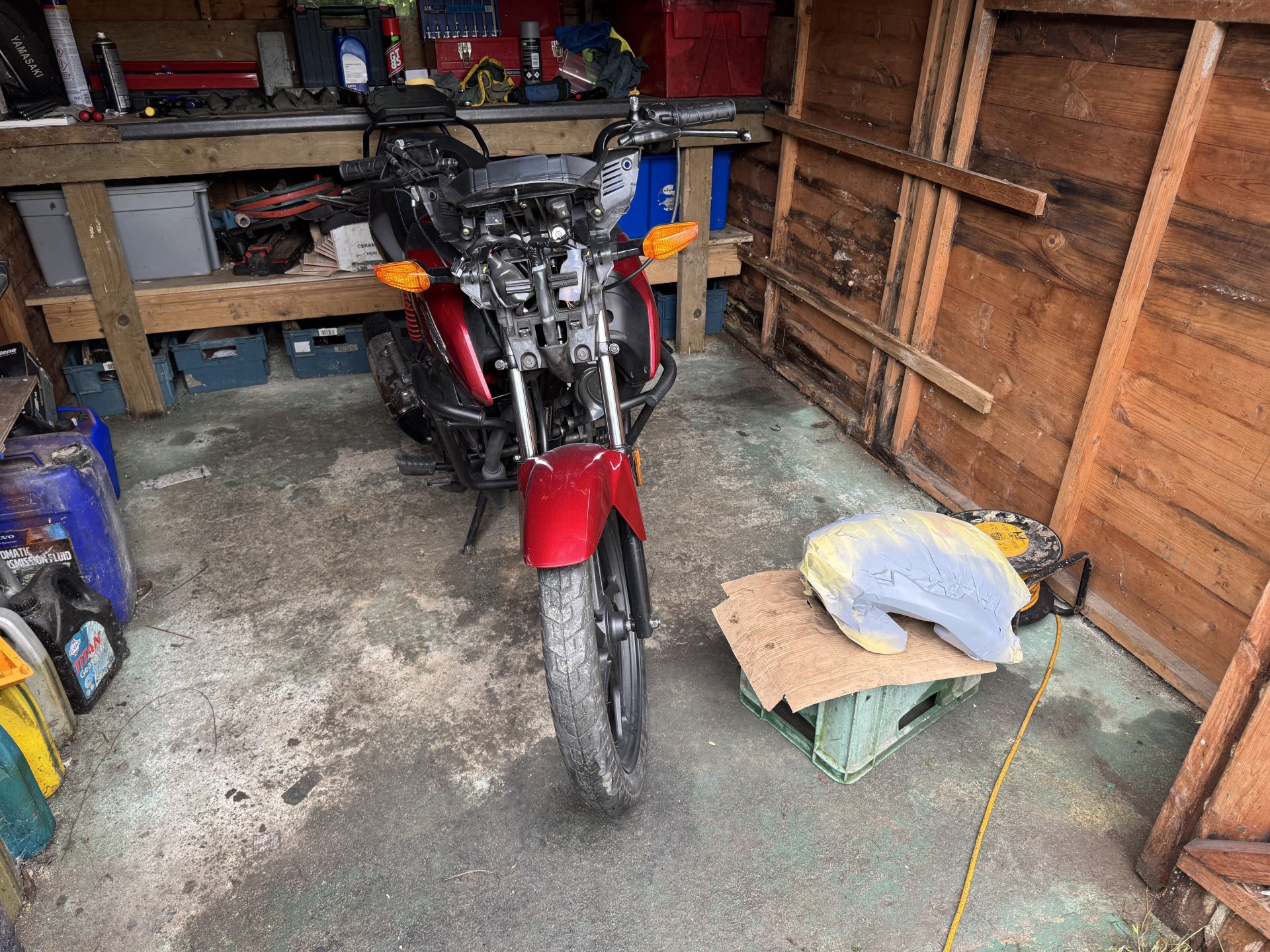

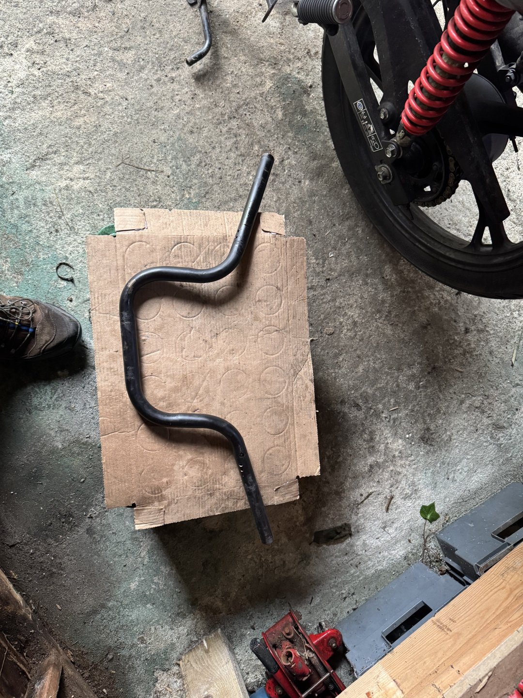

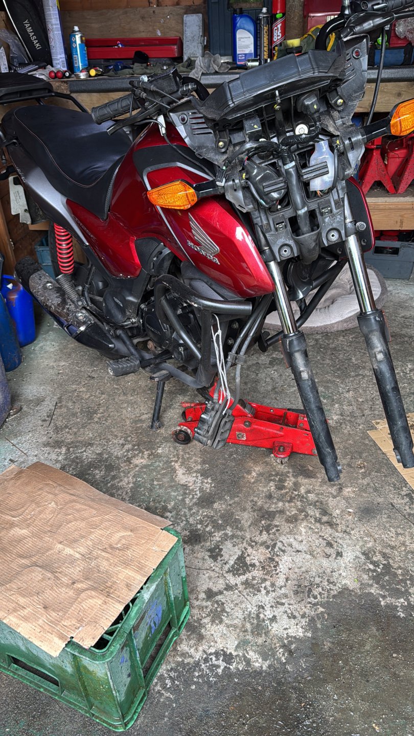

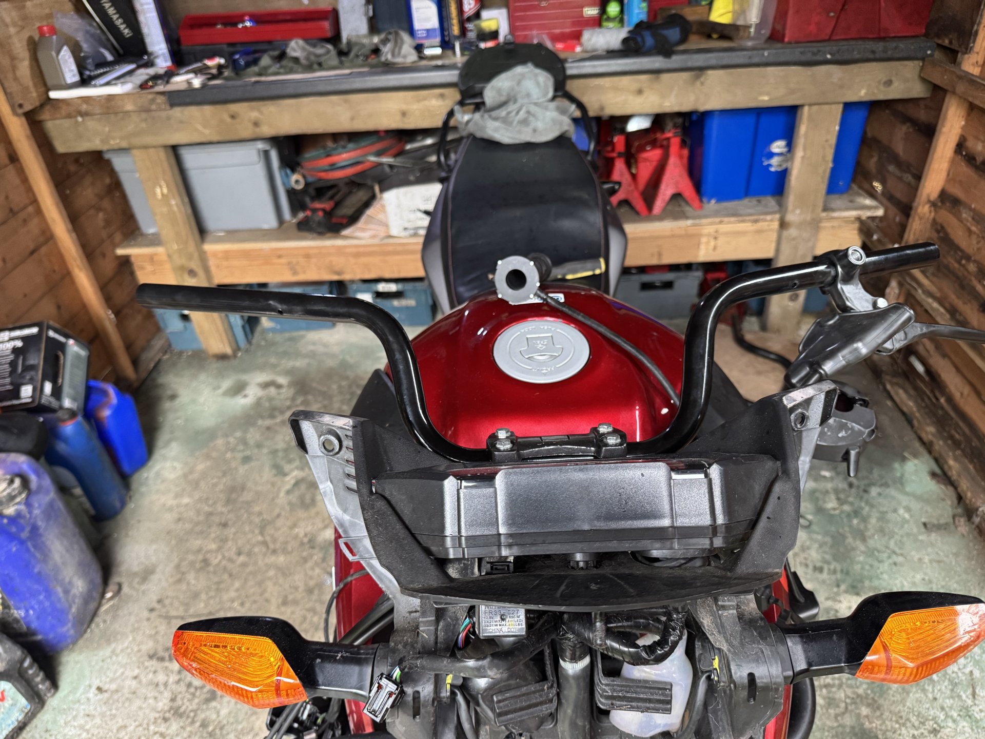

Saul Posted June 12 Author Share Posted June 12 Well the bike is still rattling but in the mean time Shadow rear ended a car last Friday. Wiped out an indicator bent the handlebars broke the front brake lever and added a couple of more scuffs. . She was shook up and bruised but is ok now. The new handle bars came today. So I went out to fit them only to discover what I bought was different to what was on the bike. But the bike was bought as a repaired crashed bike so I suppose I should not be surprised. The new bars fit and look much better so I think I got the right ones I also stripped out the forks to check they weren’t bent and luckily they were fine so I just cleaned every thing up and put it back together. Also cleaned up and checked the brake caliper. Repaired the crack in the mud guard. Just painting a couple of black strips on the headlight cheeks to hide the scratches. I know I would never be able to match the colour and those checks are £80 each. So disguise seemed like the best option. I have contacted a mechanic to check the rattle out to see if it can be fixed affordably. 4 Link to comment Share on other sites More sharing options...

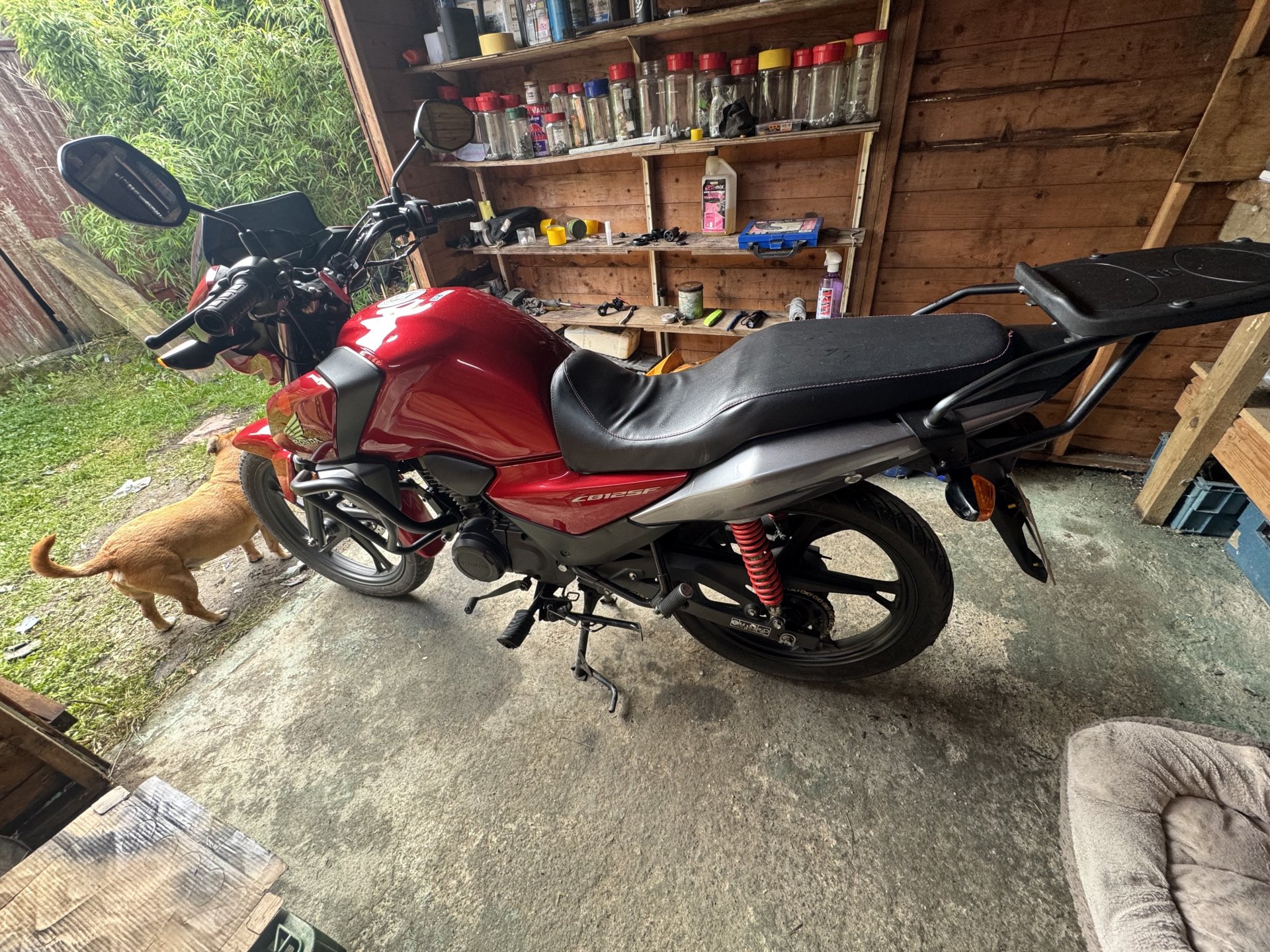

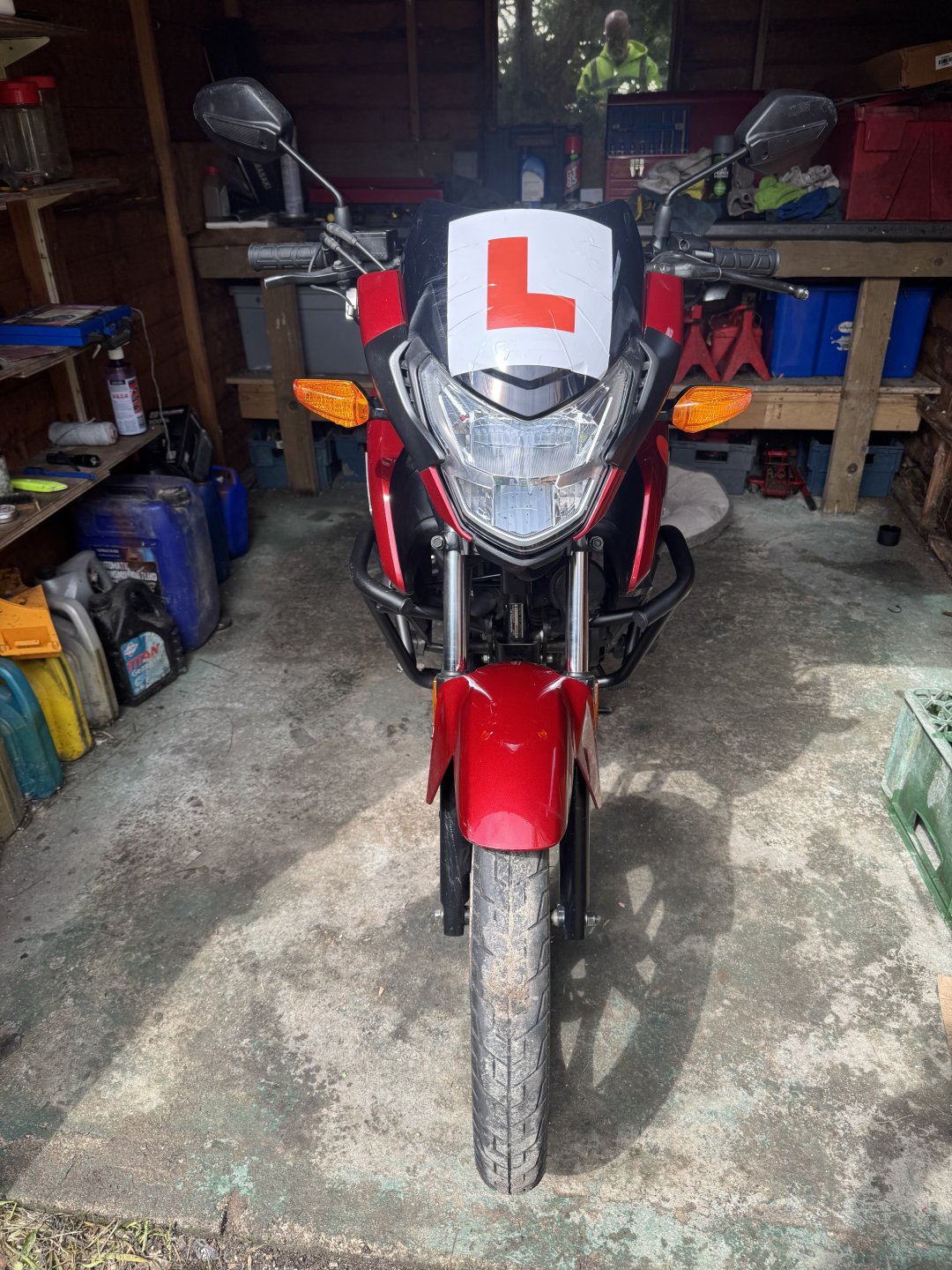

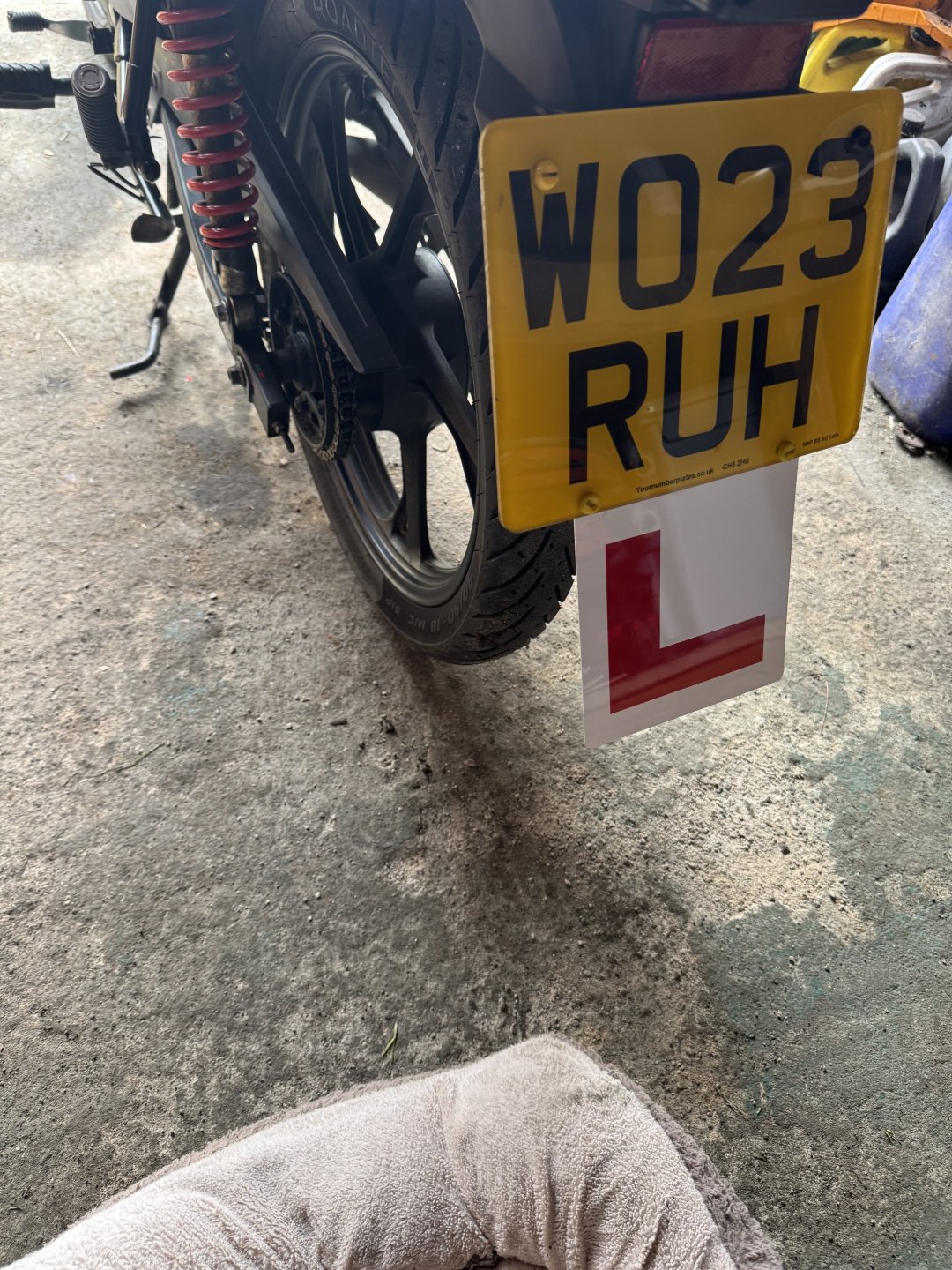

Saul Posted June 13 Author Share Posted June 13 Well got Shadows bike as far as I can. Just waiting on the new indicator and front brake lever. Managed to disguise the scratched up headlight cowel with a black accent which Shadow loves. She thinks it looks Sick! Which apparently is positive, I’ll settle for tidy. I like the new aluminium rear L plate, supposedly unbreakable but we all know Shadows talent for destroying stuff. Now she is obsessively watching EBay waiting for the parts to come. 3 Link to comment Share on other sites More sharing options...
