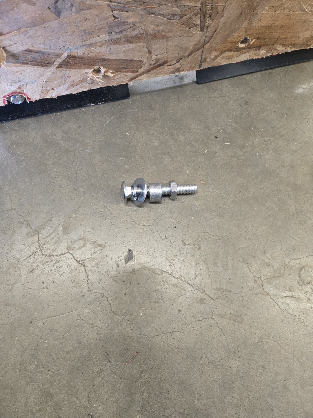

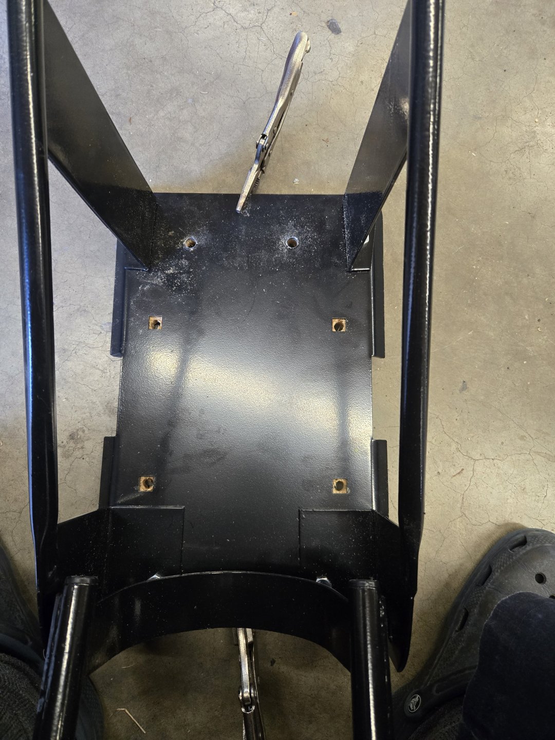

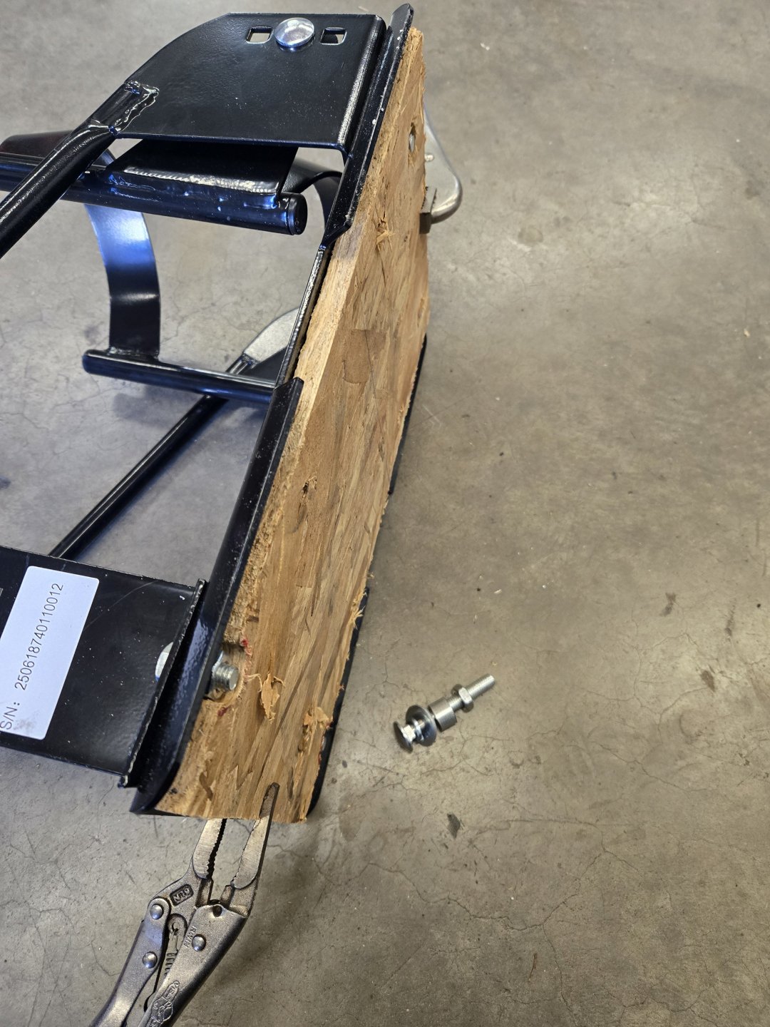

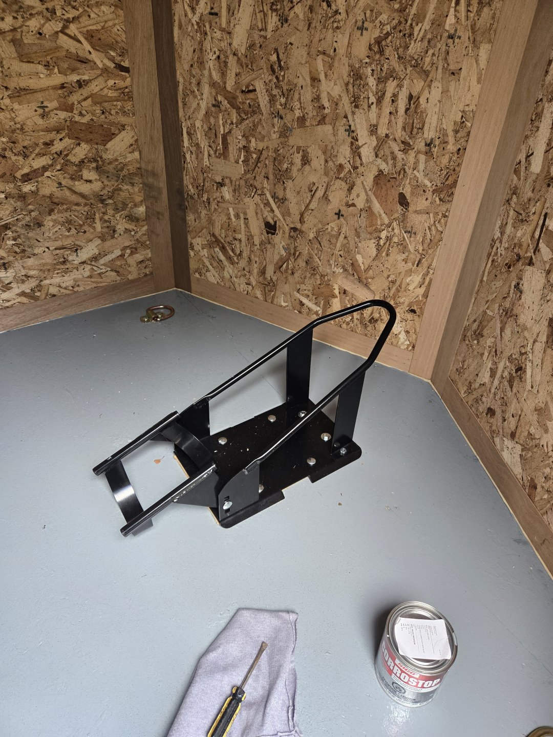

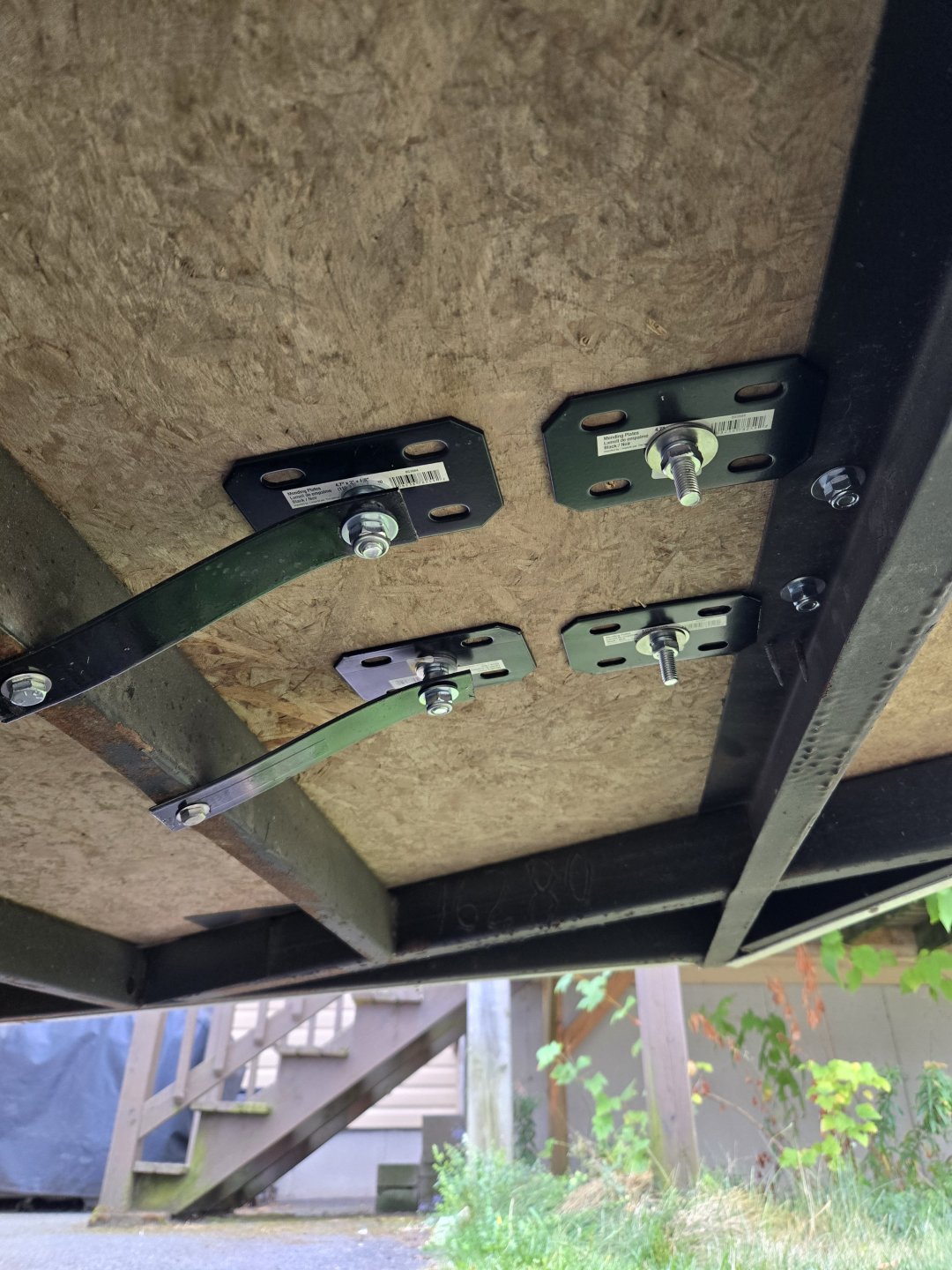

Vamana Gupta Posted September 19 Author Share Posted September 19 Has Im waiting for the paint to dry...looking at the vevor chock...these bolts came with it and with a spacer to compensate for the side lip on the stand itself...looked like these busging spacers would just sink in the obs floor...so I decided to put down a obs piece to support the entire stand...and drilled to extra hole ...pushing the stand back 3 inches from the front.... Link to comment Share on other sites More sharing options...
Catteeclan Posted September 20 Share Posted September 20 14 hours ago, Marcel said: Has Im waiting for the paint to dry...looking at the vevor chock...these bolts came with it and with a spacer to compensate for the side lip on the stand itself...looked like these busging spacers would just sink in the obs floor...so I decided to put down a obs piece to support the entire stand...and drilled to extra hole ...pushing the stand back 3 inches from the front.... Get some big washers or make some plates for the under side. Them girly little washers will be pulled through that stuff so easily. 4 Link to comment Share on other sites More sharing options...
Vamana Gupta Posted September 20 Author Share Posted September 20 7 hours ago, Catteeclan said: Get some big washers or make some plates for the under side. Them girly little washers will be pulled through that stuff so easily. Personally I think Its over kill...lol, I think if it rips from the floor its gonna take half of the trailer with it...lol....here's the underside... Link to comment Share on other sites More sharing options...
Pedro Posted September 20 Share Posted September 20 Is it the same board on the inside providing structure and outside taking the force of the elements? That’s a lot of trust going onto an OSB board! 2 Link to comment Share on other sites More sharing options...
Buckster Posted September 20 Share Posted September 20 31 minutes ago, Pedro said: Is it the same board on the inside providing structure and outside taking the force of the elements? That’s a lot of trust going onto an OSB board! Especially with 3 tons of snow mobile attached to it. 4 Link to comment Share on other sites More sharing options...
Vamana Gupta Posted September 20 Author Share Posted September 20 1 hour ago, Pedro said: Is it the same board on the inside providing structure and outside taking the force of the elements? That’s a lot of trust going onto an OSB board! Yes...cheaply made has possible...if I'm not mistaken the osb is 3/4 inch thick...and the osb is exposed to the elements...they could have lease put a coating of some kind...even paint..im sure they are better quality made trailers out their...but this definitely a cheap one... 1 Link to comment Share on other sites More sharing options...

Catteeclan Posted September 21 Share Posted September 21 14 hours ago, Marcel said: Personally I think Its over kill...lol, I think if it rips from the floor its gonna take half of the trailer with it...lol....here's the underside... You're call but I'd have some good thickness plate welded between those rails. 2 Link to comment Share on other sites More sharing options...
Vamana Gupta Posted September 21 Author Share Posted September 21 1 hour ago, Catteeclan said: You're call but I'd have some good thickness plate welded between those rails. Yes I agree with you you...a good foot wide plate welded between the rails would have been the ultimate perfect job...but I got lazy..lol....just didn't care to pull out the welder crawling underneath with a foot of clearance underneath... Link to comment Share on other sites More sharing options...

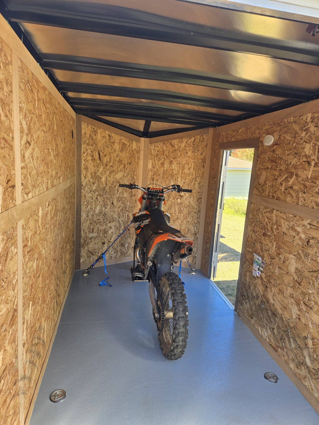

Vamana Gupta Posted September 21 Author Share Posted September 21 My first non-paying customer...lol...one of my boys called and see if I could run his trail bike to his new location...20 bucks of petrol later..lol..at least I got a thank you..lol. 5 Link to comment Share on other sites More sharing options...
Buckster Posted September 21 Share Posted September 21 3 hours ago, Marcel said: My first non-paying customer...lol...one of my boys called and see if I could run his trail bike to his new location...20 bucks of petrol later..lol..at least I got a thank you..lol. I wouldn't risk anything heavier than that. 1 2 Link to comment Share on other sites More sharing options...
Vamana Gupta Posted September 22 Author Share Posted September 22 22 hours ago, Buckster said: I wouldn't risk anything heavier than that. I made it Harley proof...cause most of my friends rides Harleys...im sure Im gonna get calls shortly ...for towing services ..lol. If it does get in a wreck...im sure the trailer will be scrap...its so cheaply made... Link to comment Share on other sites More sharing options...
