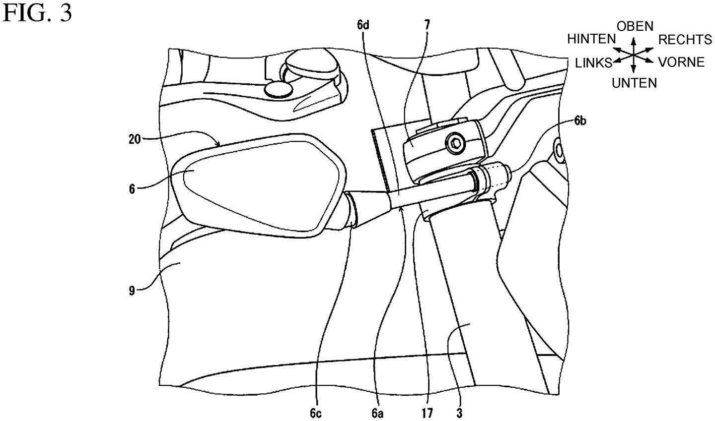

Since mirrors have been the norm for such a long time it’s a surprise to see that Honda has filed a patent application for a design that it believes is so different from others that it warrants patent protection. The idea itself is incredibly simple: The mirrors are mounted on conventional-looking stalks, but they’re attached to the fork below the top triple clamp and positioned underneath the bars rather than above them.

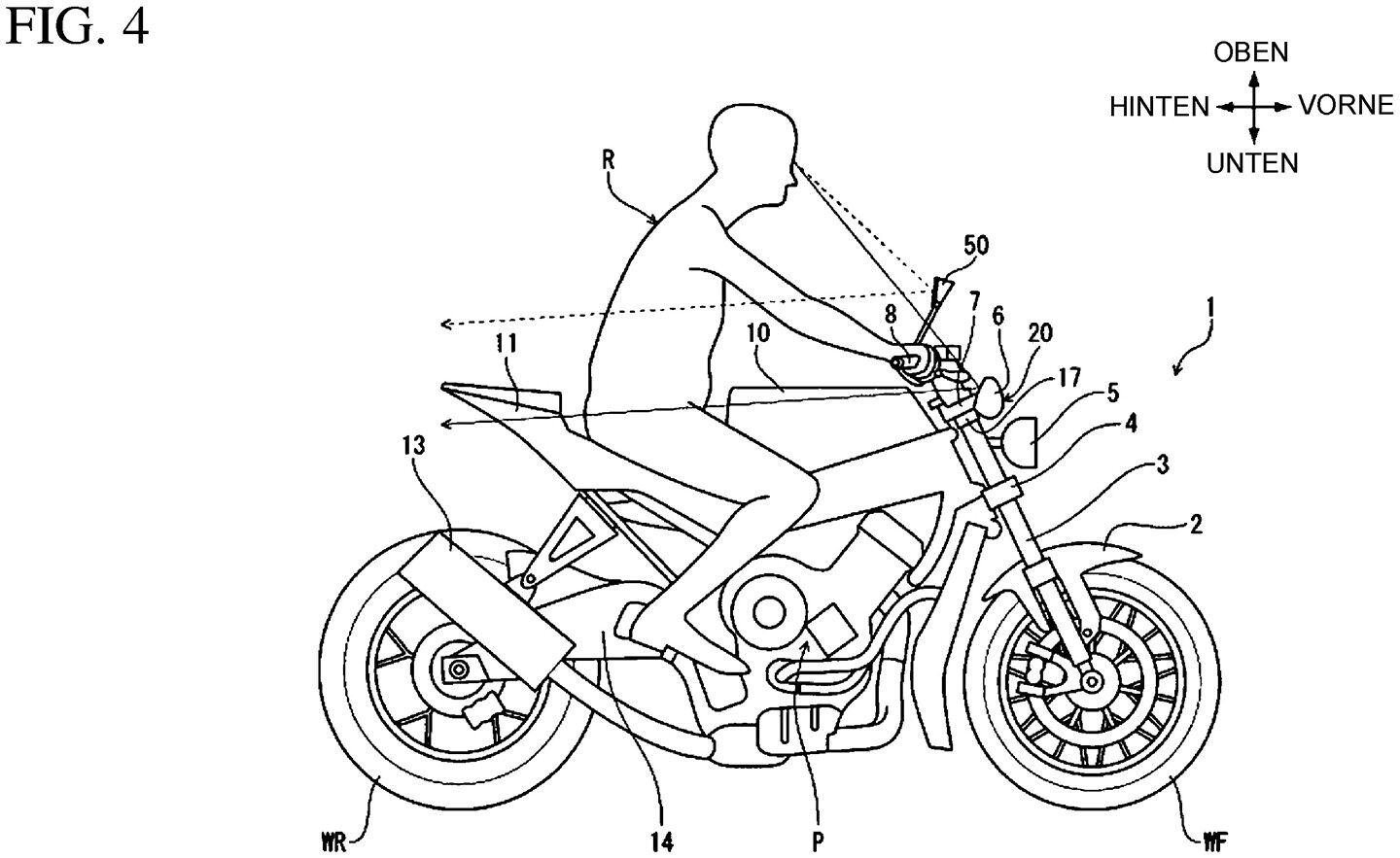

This illustration shows the line of view created by a traditional-mounted mirror (50), and its new location (6).
This illustration shows the line of view created by a traditional-mounted mirror (50), and its new location (6). (Honda/)
There are three key benefits to the layout, explained in the patent document. The first, and most important, is that of improved visibility. Although mirrors that hang below the bars aren’t a new idea—there are plenty of aftermarket bar-end mirrors that mount that way—Honda’s design positions them a little farther forward, so you still look over your hands to see them. The benefit comes from the fact that the view the mirrors reflect is below the level of your arms and elbows, so the view is unobstructed. That’s actually an idea that’s already used on a Honda production bike, the Japan-only Hawk 11 cafe racer, based on the Africa Twin’s engine and chassis. However, on the Hawk the mirrors are mounted on the fairing, which means they don’t offer the remaining two benefits of the new version the company is trying to patent.

These stem from the fact that, since the mirrors don’t need to be positioned far enough to the side to see around your arms and shoulders, they can be mounted relatively far inboard. Moving them toward the centerline of the bike means that aerodynamic forces acting on the mirrors have less leverage on the steering. The third benefit is that because they’re mounted closer to the steering axis, the inertia introduced by the weight of the mirrors is reduced, improving steering feel and response.
This front illustration gives a clear view of the mirror location.
